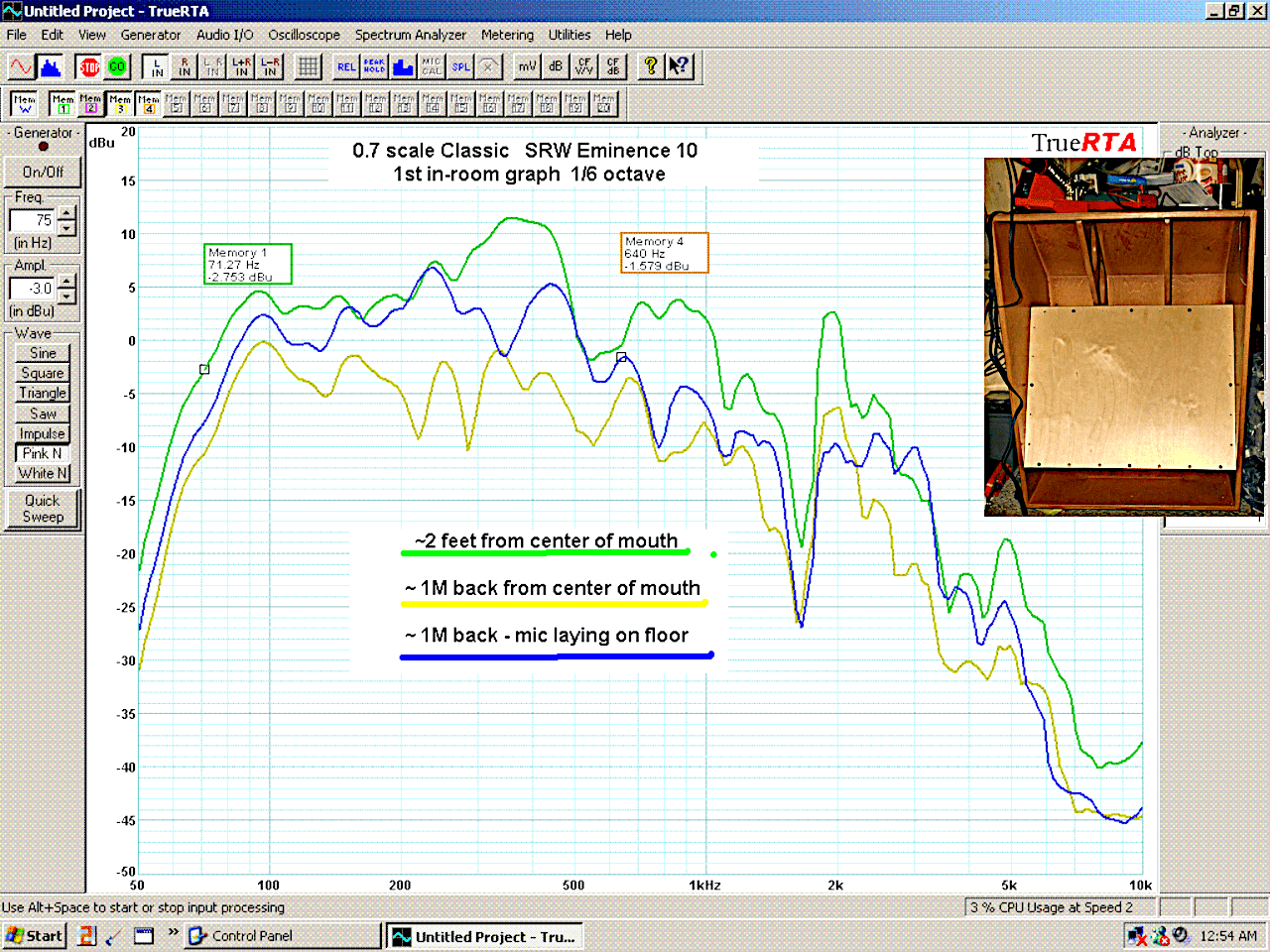

here's what my scaled University Classic did with a low Q Eminence 10". IIRC its around 16" deep

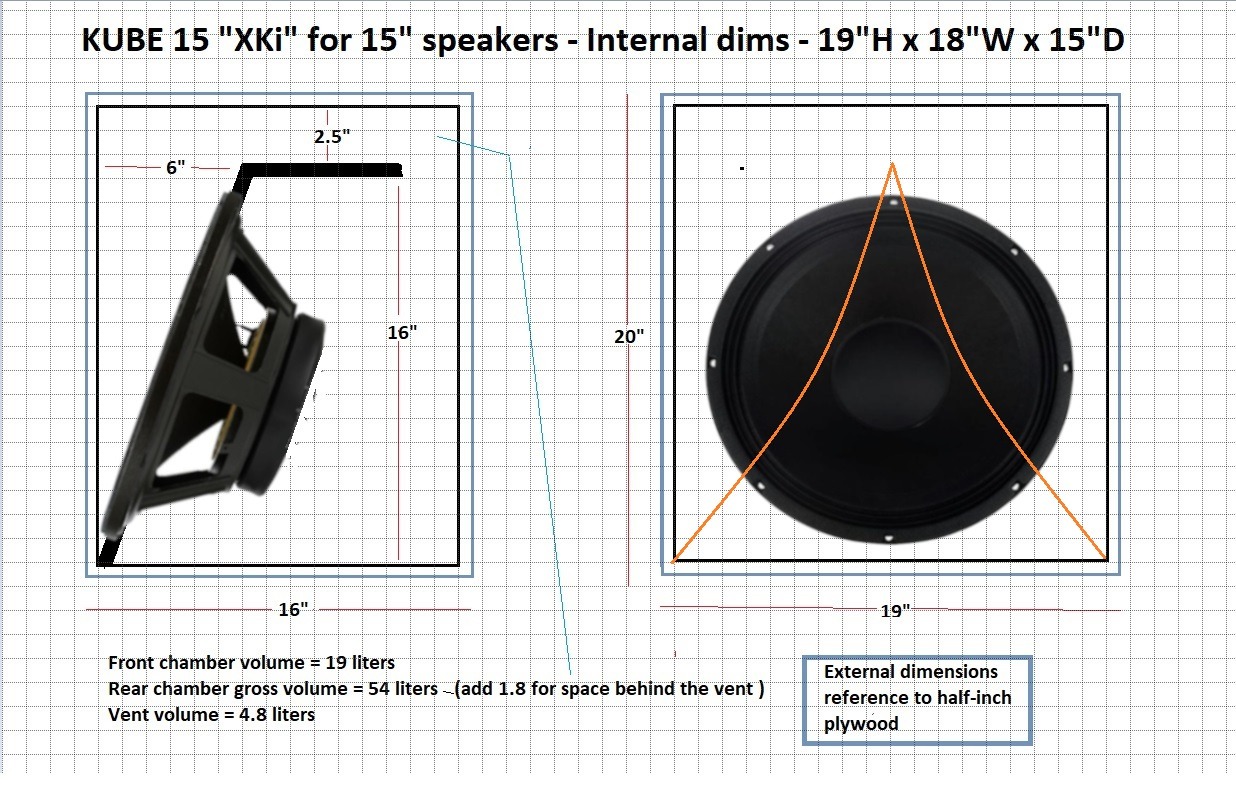

A Kube15 with solid stage might make a compact midbass at 20-21" height as long s there some real drive power.

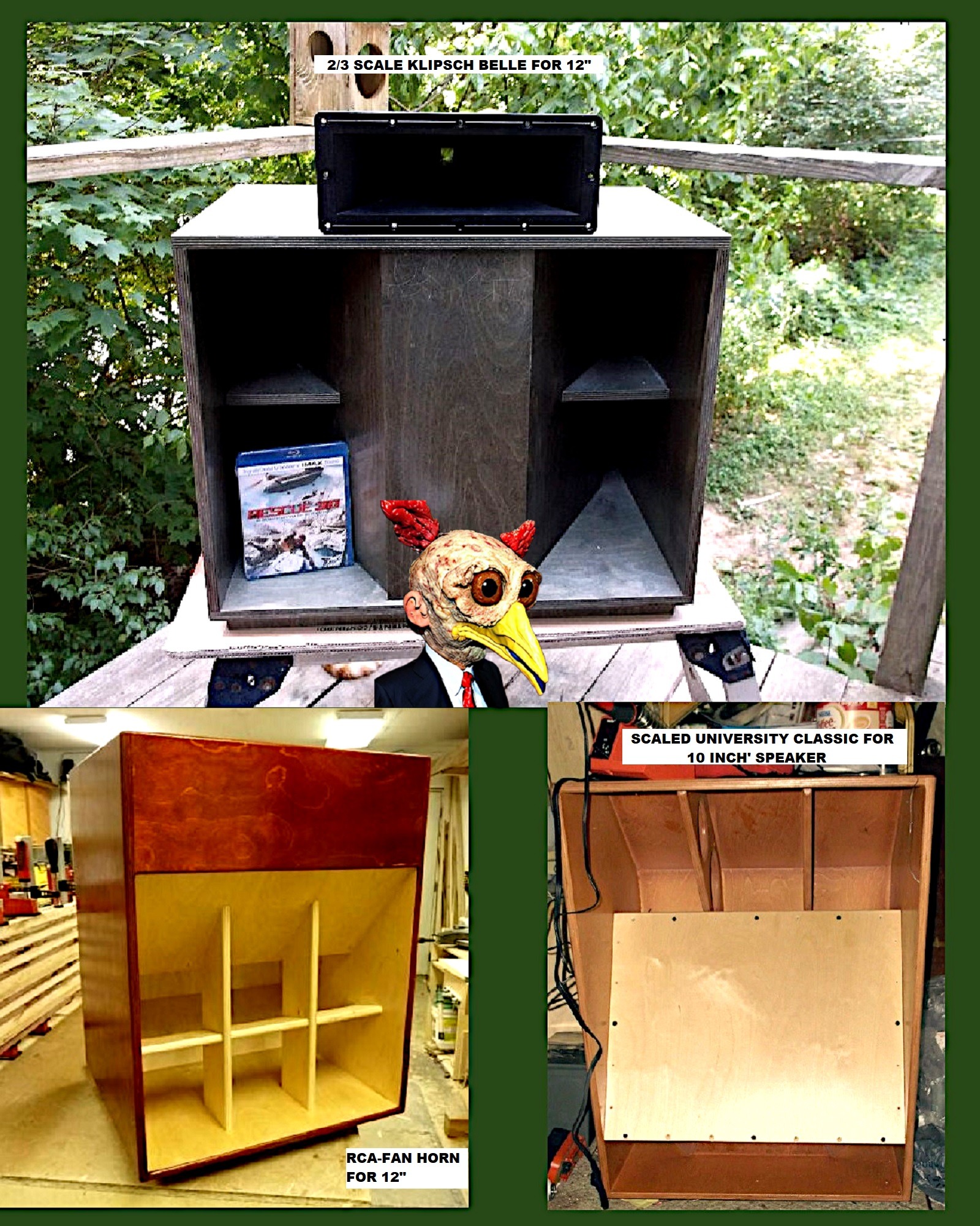

on bowed bass viola - I like the sound of the little Acoustic Control 115BK Karlson box.- but Karlson aren't sensitive enough for flea- 3 watt power SE tube.
My "midbass"horn experience is limited - guess Sentry IV, FH1, Edgarhorn 100 would count- got 2-small 50Hz C-fold. - jo "J" horn Sentry IV, FH1, and Baby Belle bifurcated. Baby University Cl;assic very good - if had been made ione inch deeper then would have used a 12" instead. of 10"😢
A fiend many years back made a VOT type speaker using EV15L for bass guitar - - he made a 5 petal short horn/wg - back wave rest reflex with slot-shelf port below the horn. - it was very clear sounding and probaly had the traditional stepped response of thta type hybrid.
