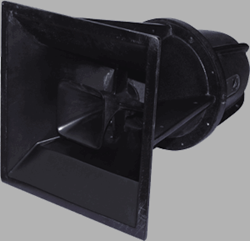

I was in the same dilema as you but ended up using a ready available horn structure. If you're located in Europe I would suggest buying a pair of "Audac HS212" end eviscerate the little coaxial horn. If you're in US then you could buy those in photo which are similar if not identical, available on eBay US, too expensive to ship overseas. The horn is 51cmx51cm at mouth and 45cm in lenght (70cm incuding backchamber) and uses 12inch speaker. The coaxial horn&driver has phaseplug role, but for 600Hz you don't need it (it's necessary if crossing at 1.5kHz as in Audacs). The output is quite smooth from 100Hz up, very rigid and clean, completely different of a folded variant I was used before (shrink down "Show horn" by Bruce Edgar).
Reactions: profiguy

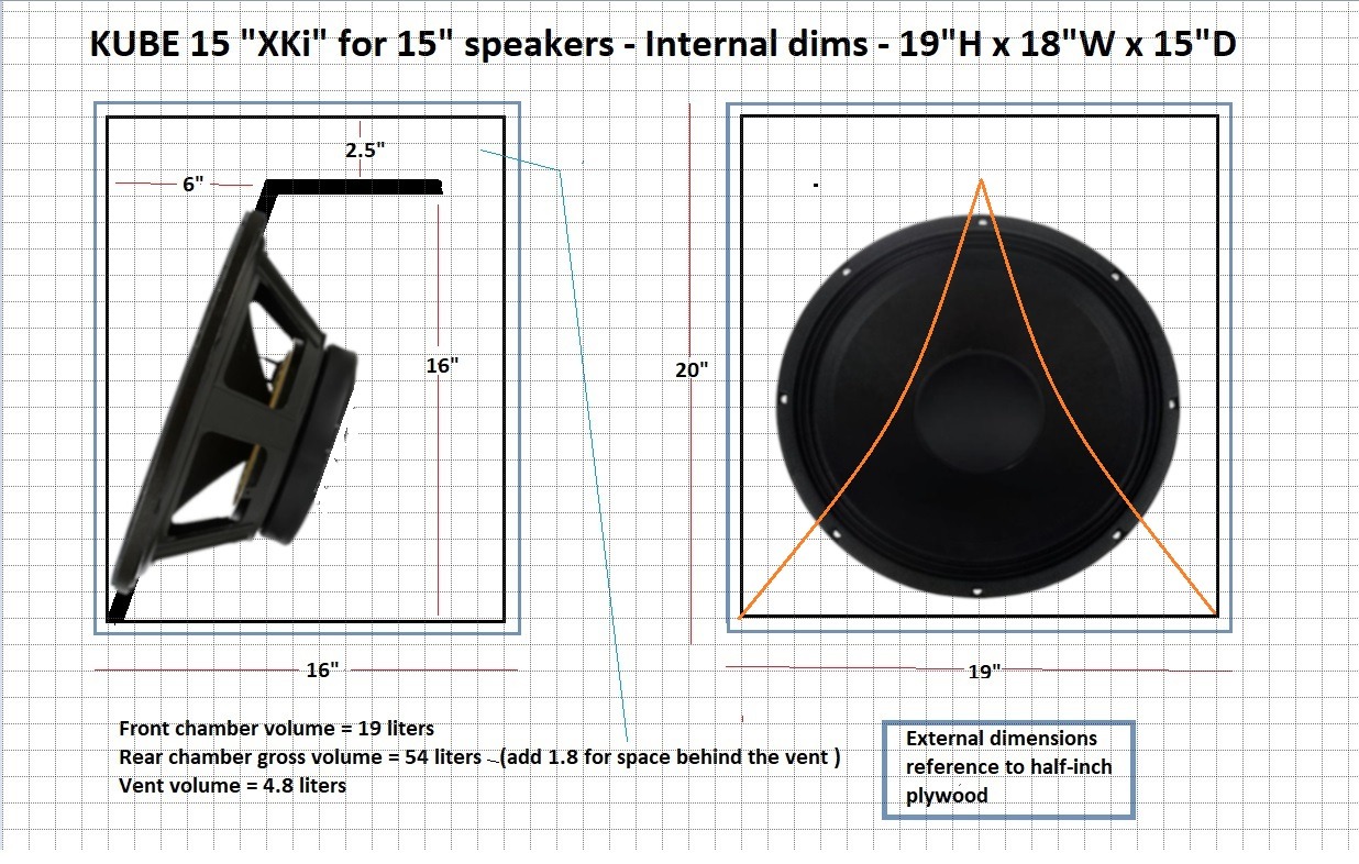

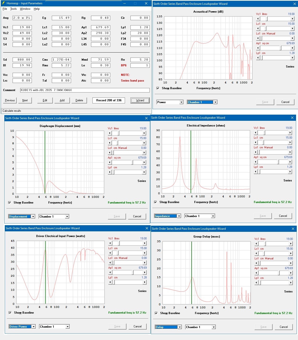

I would go with a multi way Karlson type - say an 18""kube" to keep height reasonable with 12" kube with K-tube on top and sub on bottom - solid scrape cheap power 200+ watts on the 18 .
