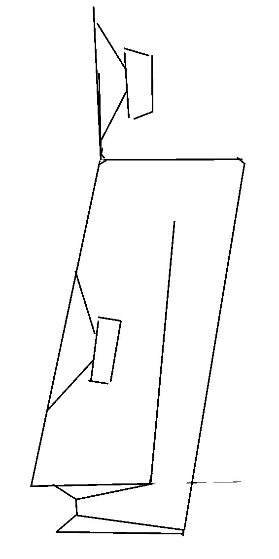

Since it emits low frequencies , putting it downwards should add a light lowpass ,being omni it should be no problem .
The trick would be to overcome the necessary delay from speaker's transient start to terminus ...
And you didn't follow what Paul said ,to put the speaker at about 12" from the closed end .

Huh? His is what I call a TQWT merely to differentiate it from a simple straight taper TL, it starts out big at the closed and tapers down to a much smaller terminus, so would be basically folded up like your example except if downfiring it of course wouldn't have the last fold to get a front exit.
Any time a driver's specs dictates a very long vent, morphing the box/vent into a TQWT will perform better overall.
Anyway, from your 3D drawing, how much gross space available is there since it's not a simple rectangle?
GM
IMO it's not a TQWT but a ML-TL .
What you drew is clearly not a MLTL, but a ML-TQWT.
