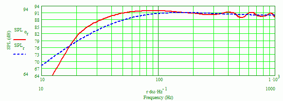

Well, PK's last sim is only ~1.846 ft^3/52.273 L net, so there's room to 'burn' ergo if LF extension is more important than peak SPL and/or flattest 2pi response, then tuning down to 16 Hz seems doable based on a little fiddling with HornResp's Loudspeaker Wizard.

For my last sim I very carefully set up the box size to make its gross volume be exactly 2.5 ft3 (12" x 12" x 30"), and then I calculated the actual net volume in the a single-fold line within it that I modeled to be 2.3 ft3, not 1.846 as you state? In any event, if Pano now is okay with a much bigger box, then there would be a whole more in general to play with.
GM
Dunno, both HR and my math agrees based on an unfolded line less driver, so there would be some minor increase and why I indicated 'more or less' [~], though didn't figure this much increase, but best to err on the large side.
Regardless, as you noted, this driver [and maybe others] offers lots more tuning flexibility than the Peerless, so at this point I'm with fakamada, we need the 'rest of the story' as ideally the bass bin needs have up to +6 dB of headroom to match up to the 'FR' driver to keep from attenuating it.
As he implied, a HE driver with digital EQ offers a myriad of tuning possibilities in a small cab if it has a decent amount of Xmax.
GM
I don't know what you mean by HR, but both it and your math are off quite a bit.😕 I modeled the last line to fit within a gross cabinet volume of 2.5 ft3, to satisfy Pano's original size/shape requirements, and it is 60" long and 12"W. Its starting depth is 10.5" and it ending depth is 0.5" to make the taper be 21:1. The average depth, then, is 5.5". So, 60" x 12" x 5.5"=3960 in3, or 2.2917 ft3. Another way to calculate it is to simply subtract the volume consumed by the angled divider from the gross internal volume of the 12" x 12" x 30" cabinet. The divider would be ~25" long in order to make a single-fold, tapered line. If it were arbitrarily 1" thick, its volume would be 1" x 12" x 25", or 300 in3. Subtracting that from the cabinet's gross internal volume of 4320 in3 leaves 4020 in3 or 2.326 in3. I'm also not taking into account volumes consumed by driver and braces.
GM
Any time a driver's specs dictates a very long vent, morphing the box/vent into a TQWT will perform better overall.
Interesting.
Why is this?
isn't this the job of the designer to optimize certain parameters at the expense of others. how about a PR box, Couldn't one mimmic the same response with a smaller box size overall albeit cost increases of the drone cone..
HR = HornResp, a well proven program I referenced in a previous post you quoted, so am pretty comfortable with its dimensional calculations, especially since they mirror my own Excel calculators done by folks with far more advanced math skills than me.
That said, a simple folded pipe using straight divider board more closely approximates a parabolic expansion making your design's net Vb ~64.89 L/2.29 ft^3 minus driver, internal baffles and any bracing, the same as I get with my ancient Excel calculator.
Regardless, to give Mike a quick answer to this driver's viability in the desired empty box Vb, I just SWAGed [Scientific Wild A$$ Guess] how much the driver, multiple folds to make it 'complex' and some dowel bracing this would consume, so not meant to be definitive at this early stage of development.
