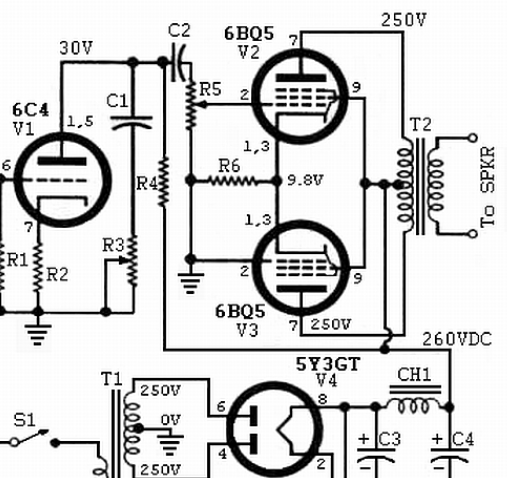

The main problem as I see it is that the HT is too low, only 141V! Let's bump it up a bit...
You should be getting 160VAC to give 226VDC for the valves. The first transformer steps down mains to 6VAC for the heaters. The second transformer is 9VAC so steps the 6VAC back up to 160VAC.
The output transformer is 12VAC not 6VAC as in your diagram. If the output valves are going rail to rail then I worked out you should be getting 15 watts peak or 10 watts RMS.

You should be getting 160VAC to give 226VDC for the valves. The output transformer is 12VAC not 6VAC as in your diagram.
I can only report the way the amp came to me. The OT has definitely been wired for 6V, which makes some sense since a '6V transformer' is really a 7V winding that sags under load, which would be a turns ratio of 240/7 giving a nominal primary impedance of about 9.4k into 8 ohms. Not a million miles away from the customary 8k, and probably much closer given the low primary inductance.
Similarly, the 9V backward transformer is likely to have a no-load voltage of about 10V, meaning you only get 144Vac when driven with 6V, which amounts to 201Vdc -almost exactly what I measured off load. There's a big drop under load since you have the source impedance of two transformers! 😀

So I replaced the 9V backwards transformer with a 6V backwards transformer, giving me 220V HT. Now we're getting a more realiable 1W at close to 2% distortion @ 1kHz. At low frequencies it is actually worse, but it does looks better behaved -more like you expect for a transformer-coupled circuit.
I think the LM317 CCS is now the big handicap because it has barely any voltage headroom with only 6.5V across it. Also there is about 5mA mismatch between the EL84 cathode currents which could be affecting the output transformer, so let's do something about it...
Your power supply is different to how I thought I built it. There are two 6volt windings, one of which runs the heaters and the other goes into the 9VAC transformer. That way the heater winding didn't load the HVAC winding.
The way I received it the first power transformer has its two 6V secondaries wired in parallel, feeding both heaters and HV (keeping them separate wouldn't make much difference since they are magnetically coupled anyway). The OT is also a 0-6V, 0-6V transformer, with its secondaries wired in parallel. :scratch2:

I don't have a wiring diagram for the transformers just the pcb.
