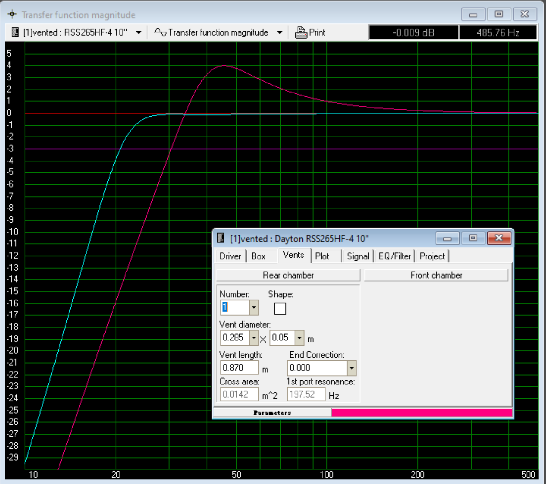

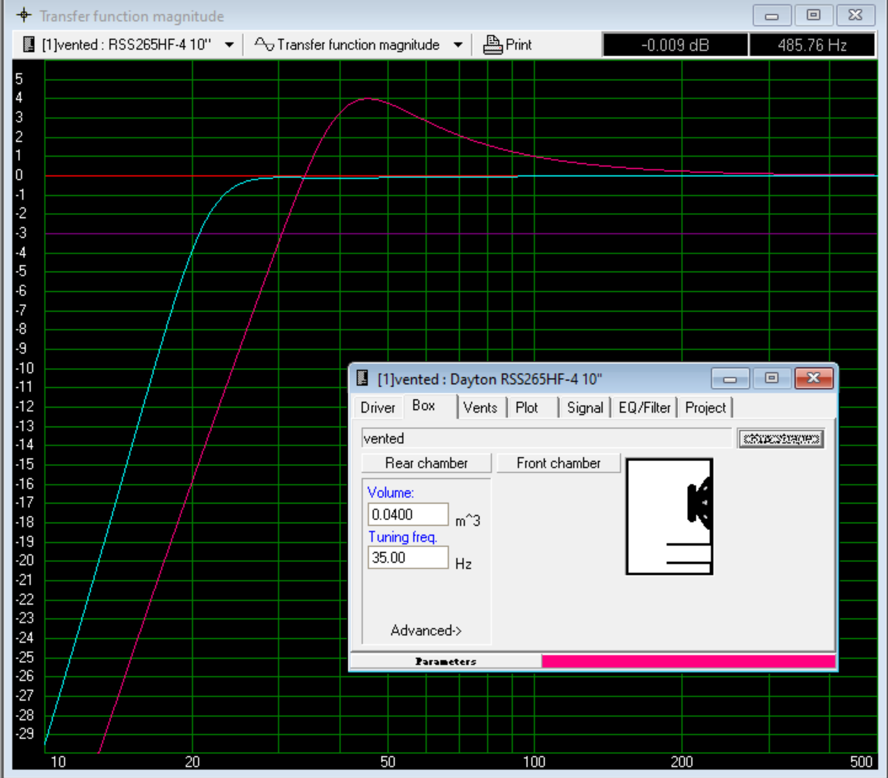

I've used winisd to design my first subwoofer using dayton 10" RSS265HF-4.
I tried to tune my vented speaker to 22Hz and I got a ridiculously big sub in size 30x60x60cm to make it to the required volume of 0.08m^3.
Can anyone tell what I did wrong? I saw speakers much smaller than this at 35x35x35 in size.

For vented, a Vb = [published] Vas/1.44 = 37.51 L tuned to 25.6 Hz [Fs] is 56 L net including a very large vent [140.32 cm^2 x 132 cm long] to handle its 350 W power rating down to Fs, so could be smaller if the power required is lower.

Try bringing your F3 up a little tuning the port down to 22Hz is a bit low for that 10" and 80lt vented is to big, they seem to recommend around an F3 of 27Hz .
Im finding 50lt ported at 30Hz will give a F3 around 27hz while keeping port length practical and velocity reasonably low(2 of 86.5x718mm, its locally to me available pvc pipe).
