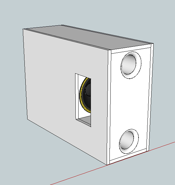

I know this thread has kinda headed off in a different direction but I though I would post an update to my build.
After I built the enclosure I found I had some issues with port noise and I had an air leak around one of the drivers. This gave me more than enough excuse to try again and incorporate a few design changes.
I've attached some images of my Mk II design. I've re-positioned the drivers so they are vertical, this should eliminate any cone sag issues. I've also changed the ports over to a round shape with a generous amount of flare at each end. Hopefully that will take care of the port noise I was seeing.
Chuffing means you need bigger ports (and they then have to be longer).
My dual 4.3mm Xmax 18’s in a 16ft3 box tuned to 27hz NEEDED a 12” port.
That's a bunch of air slooshing through the port at 27hz.

Nice looking box. Maybe the ports are seeing some frictional losses due to being so close to the box edges. I can't remember if the slot port "looks" longer or shorter than an equal sized round port (not at a box edge). And a slot loading on the floor is different than a round port coming out of the box 1' off the ground. It'd be nice to test and measure this stuff.

The drivers have a 4.5 mm xmax, so not exactly excursion monsters. I determined the port size using a formula I found and now I can't remember where. The formula is Vd x Fb x .02 = area of the port in square inches with Vd being the drivers displacement in cubic inches and Fb being the tuning frequency of the enclosure.
The enclosure as it is in the proposed design is 3.5 cubic feet net volume and is tuned to 30 Hz.

either way, try for larger ports, as long as you can fit.
That's the trouble with smaller boxes (3ft3 vs 10 or 15ft3). It is difficult to get a big enough port that isn't longer than the box but also below 24" (pipe resonances).
I cringe seeing a 15" 14mm xmax subwoofer tuned to 20hz with a pair of 4" ports.

How long are those ports?
Nice!
Including the flares at both ends they are 19.25"

Port Flares
One thing about round ports is people will buy those so called "Flared" 4 inch port kits with the radiused ends, and that is not really the best shape for a port termination.
The flare is an impedance matching device, matching the high velocity air motion in the port with the still air half a foot away from the port end.
With a radius, the walls get exponentially more angled away from the axis of the port tube.
There is flow separation from the walls as you get to a certain angle from the flow axis and a high velocity.
In many cases, if the port is marginally sized, the effective diameter of the port is smaller than the straight round section due to the turbulence set up by the flow separation.
A port flare should be more like a taper with maybe no more than a 45 degree included angle.
A good approach to port termination can be found by studying rocket nozzles.
They do the same thing, take high pressure gasses and expand them to be the same pressure
as the ambient atmosphere that they operate in. (impedance matching)
It seems a little counter-intuitive but that gives rocket engines the highest efficiency.

Norman:
I only heard chuffing when listening to a sine wave, so it was a bit of a worse case scenario. My current enclosure uses a slot port and my suspicion is that the slot port is more susceptible to chuffing than round ports are. That one of the things I'm going to be testing out with this new enclosure.
Shadydave:
I've seen other posts you have made regarding port flares and it definitely gives me something to think about. My current plan was to use a 3/4" round-over bit in my router to cut the flare at each end. I'd like use a 1" round-over bit but I don't have one. Maybe I'll pony up and get one I can certain see how a 45 degree angle would produce a more laminar flow but I worry that disturbance would occur where the angle first begins. I'm not sure how you could produce a flare and begins at a low angle and expands to 45 degrees but doesn't go beyond that like a normal round over does. I guess I could cut both shapes from different sheets of material and then combine them, but that's getting to be a lot of work.
I found your comparison to 2-stroke expansion chambers interesting. I just wonder a what point the flare becomes so long its becomes more like a horn and makes it difficult to calculate the proper port length for tuning.
Shadydave:
