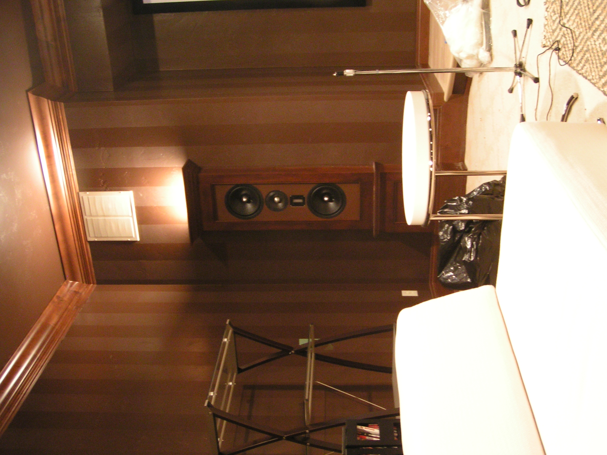

What ever I end up doing will need a "matching" center for when I'm using the system as a theater rather than music.
I'm currently working on an installation for a large theater room. The front LCR each have a pair of sealed TD10S's, the TD6.5M, and the smaller RAAL. The larger RAAL was planned originally but due to limitations in height of the center channel it wasn't possible. The center uses a vertical MT flanked by the TD10's. These are mated to a subwoofer using 8 IB15's. I used the DCX2496 for processing and power is provided by 2 of the Emotiva UPA7 amplifiers plus a QSCPLX3402 for subwoofer power. Currently the sealed TD10S's are being used without a subwoofer. There was plenty of excursion available to EQ them to be used down to 30hz. For home theater duty the IB15's provide output into the mid teens.
Here is a pic, but it is large so I'll just post the link until I can resize and rotate it later.
http://www.aespeakers.com/pics/nick-theater/PICT2831.JPG
John
