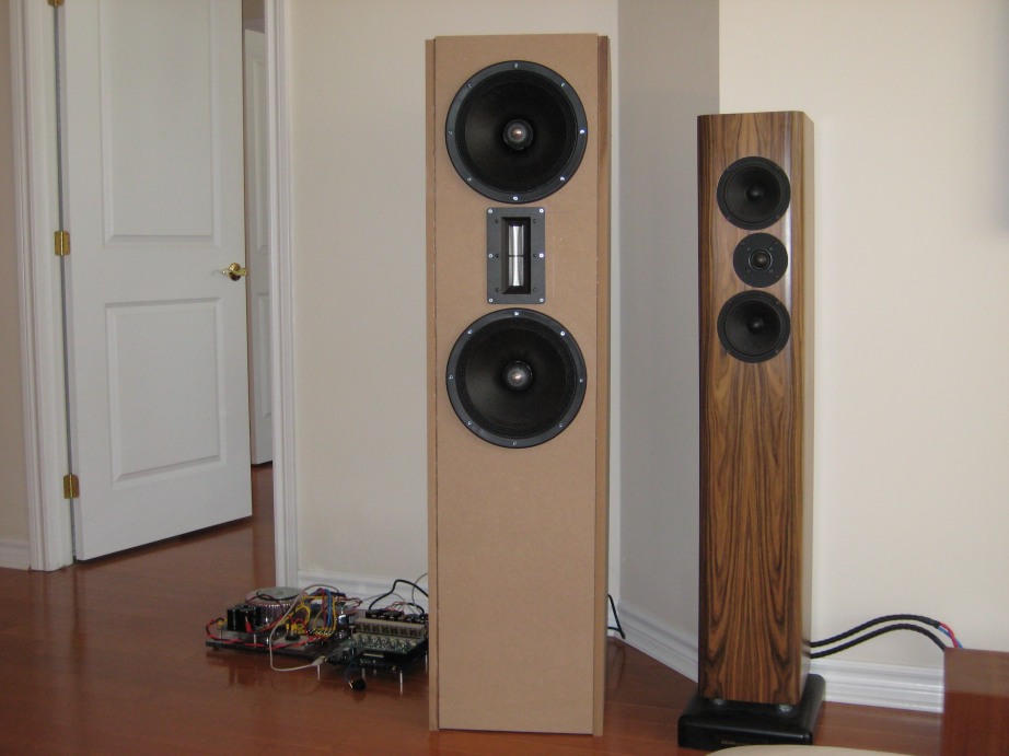

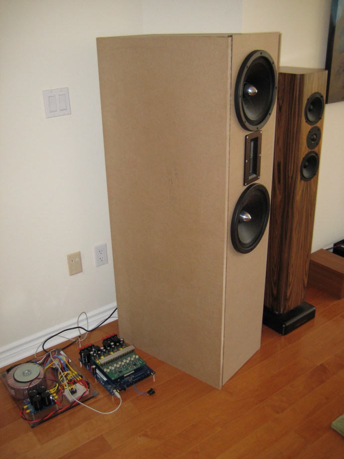

Here is a picture of the prototype box. Since I don't have access to a wood shop anymore, I shamefully got Home Depot to cut the MDF sheets to size and then used industrial strength hot melt glue to hold everything together. You can laugh, but it actually worked incredibly well. I also used the glue gun to make a bead of glue down all the inside joints, which made it air tight and a little stronger.

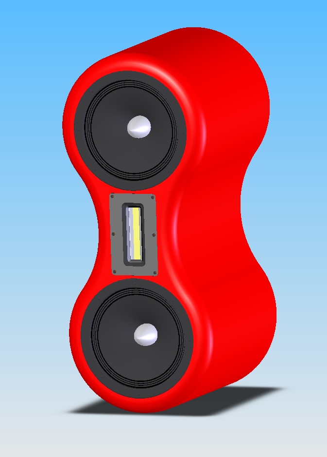

This brings us to the next image, which is the new model I will be sticking with. I drew everything up in Solidworks, with the drivers all modeled as separate parts.
I'll be going with a pearlescent white automotive finish, and the box will probably be either all MDF or alternating layers of MDF and Baltic Birch.
I think I've mentioned the construction process before, but in case I haven't, I'll go over it again here.
I'll be laminating the first two sheets of MDF together here (3/4" each) and then I'll have the front shape of the speakers cut out of it with the driver recesses and everything else on a large CNC. I'll then be using a front to back "Translam" style technique (instead of bottom to top) where I'll simply glue additional layers to the back of the CNC'd front and flush trim them with a 2" spiral up-cut Freud bit to the same shape as the front, two layers at a time.
With enough sanding and diligence, I should be able to get nice clean sides, and do some fancy bracing on the inside of the box. This will also let me make irregular internal surfaces inside the two woofer enclosures. I'll finish the whole thing off with a 1.25" round-over on the front and back, then off to an auto body shop for paint.
This box will be stand mounted initially, and I'll later decide if I want a separate subwoofer to go along with it. The woofer boxes will be sealed as I'm not a very big fan of ported enclosures.
I think the above design will be almost ideal for diffraction, and should at lease be interesting to look at. This is about as close to a spherical enclosure as I can get with the tools I have access to.
Anyone with experience doing automotive finishes on MDF? What do I need to watch for? What primer should be used? Should I let the auto body shop use a high build primer and then sand it? Is laminating in sheets of Baltic Birch asking for trouble?

Hi Guys,
Thanks for the tips! I'll look into some of that epoxy for sealing the finished boxes.
I spent the afternoon playing with an active crossover/eq, and I have some excellent measurements to show for it. I have attached a graph of the full response measured at 1m distance. Nearfield splice at 500Hz, with nearfield data measured from both woofers and the line exit on the back.
I eq'd the bump in the tweeter, and a bump in the woofer at 2500Hz. Crossover is LR4 @ 2000Hz.
The bumps at 110Hz, 360Hz, and 875Hz are ripple caused by the under-stuffed transmission line.
There are also some diffraction related bumps since nothing is flush mounted.

Hi Linesource,
Testing the sealed TD10M's is next up on my list of things to do. I'm fairly sure I can get away with buying some 12"-13" Sonotube and making some enclosures for both the TD10M's on one of the test baffles I already have.
I do like the sound of TL's but in this case it's a question of size and looks.
What do you use for stuffing in the boxes? Since my enclosures are going to end up being cylindrical, I was thinking something like a Sonic Barrier 1-1/4" on all internal surfaces, followed by Acousta-Stuf for damping, but it has been years since I've done a sealed box, so there's probably something better out there.
The subwoofer will probably be an 18" in a sealed box as well, and I'll use EQ to get it as flat and low as I care to. I have access to some nice 3kW sub amps with DSP based EQ, and I don't mind using that kinda stuff on the bottom end. The mids and highs are another story though.
I've seen those speakers around in various "I wish I had these" sorta threads... they're stunning.
What do you use for crossovers and front end? DSP based?
Owen
Owen
