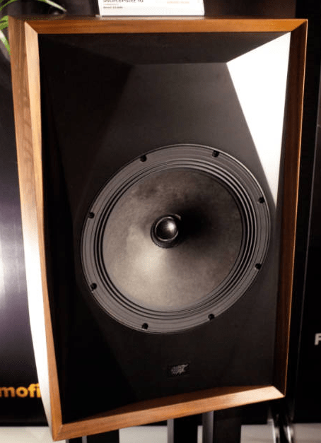

10-inch Satori Coax (Mofi Pointsource 10) .. close-up pictures!
Hello Home-Coax Hificionados!
Stumbled upon some large size pictures perfect to wait for the real deal :
https://www.hifitest.de/test/lautsprecher-stereo/mofi-source-point-10-22492
https://www.hifitest.de/images/testbilder/big/mofi-source-point-10-lautsprecher-stereo-73903.jpg
Right click every picture and choose open in a new tab for full size picture!
The magnet and the basis plate is quite disappointing , I have expected a lot more to be seen!
For $7000 speaker for the pair it's a mild shock but still a shock!
Is SBA really trying to sell us such a piece of uninspired metalwork?
Please update with an improved mk2 version and plenty of visual pleasures!
See Dayton Audio Signature Series , it's a killer!
Even the alienz have bought some for their kidz 🙂

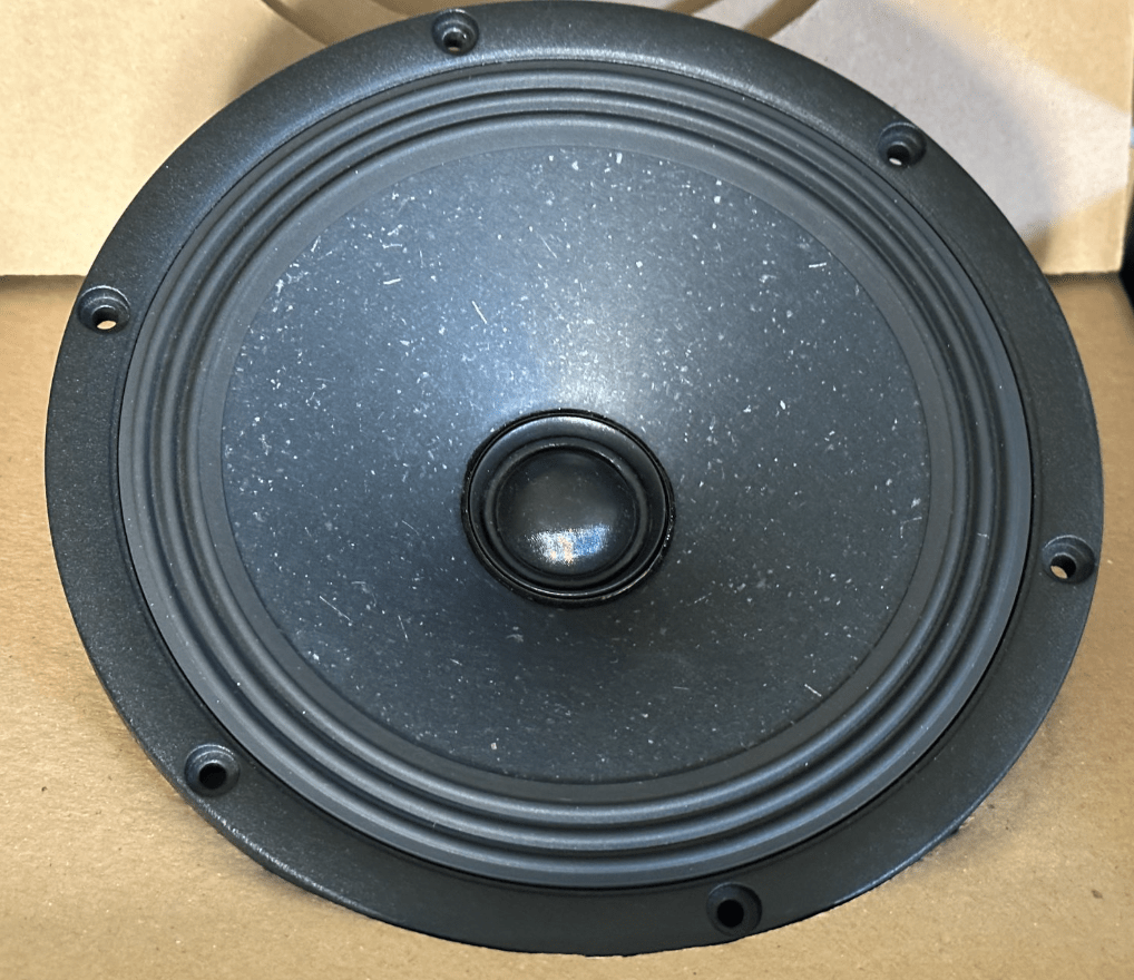

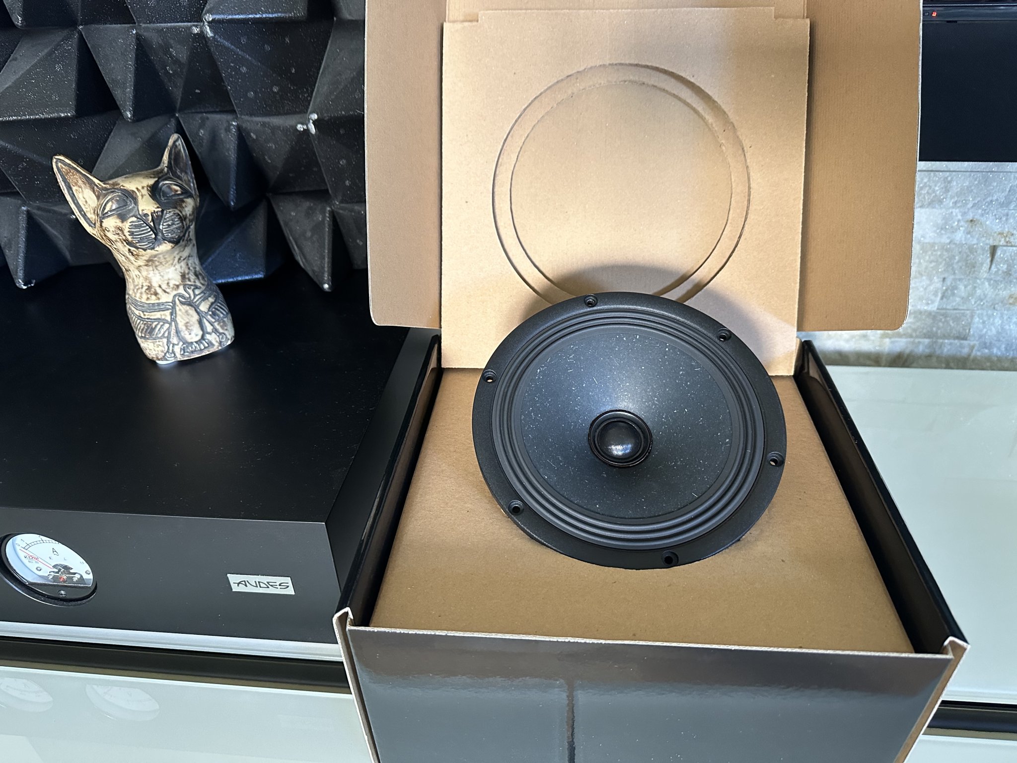

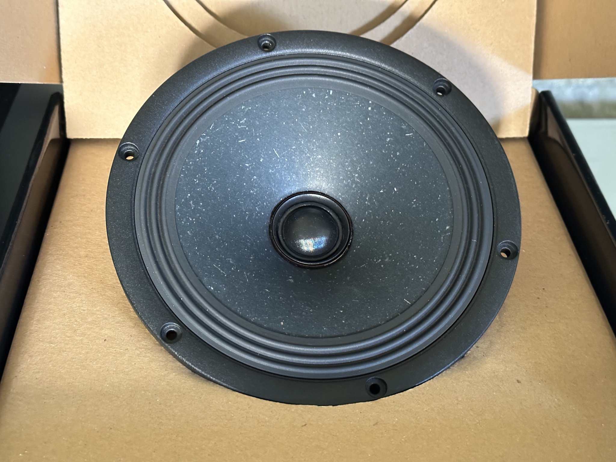

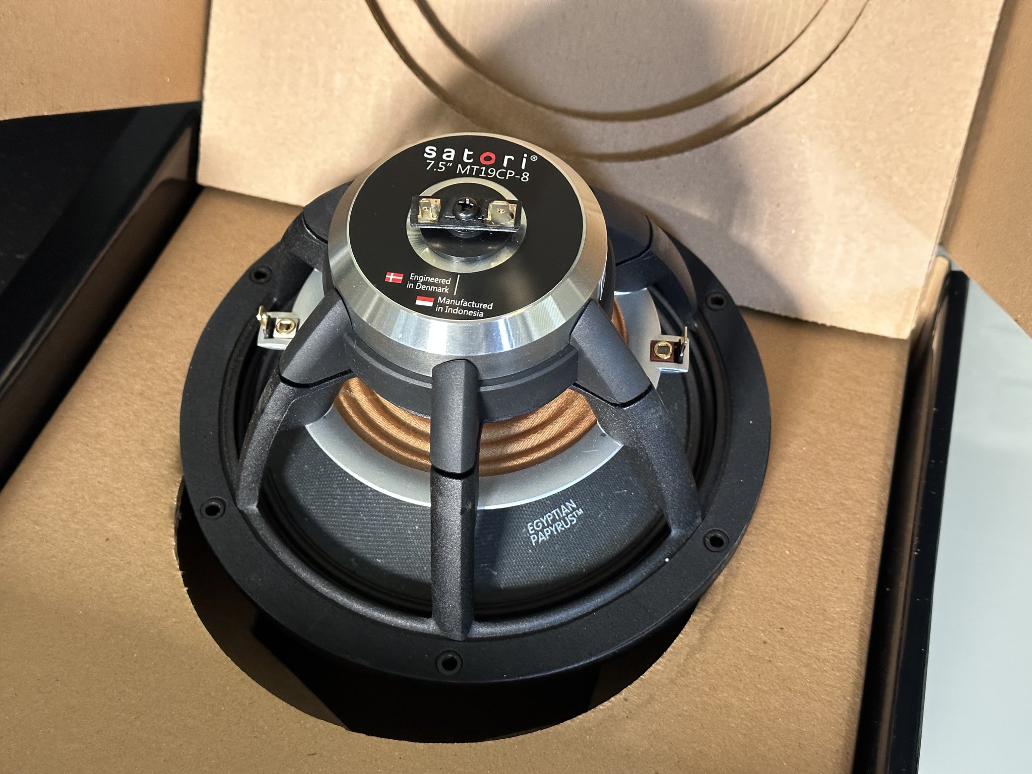

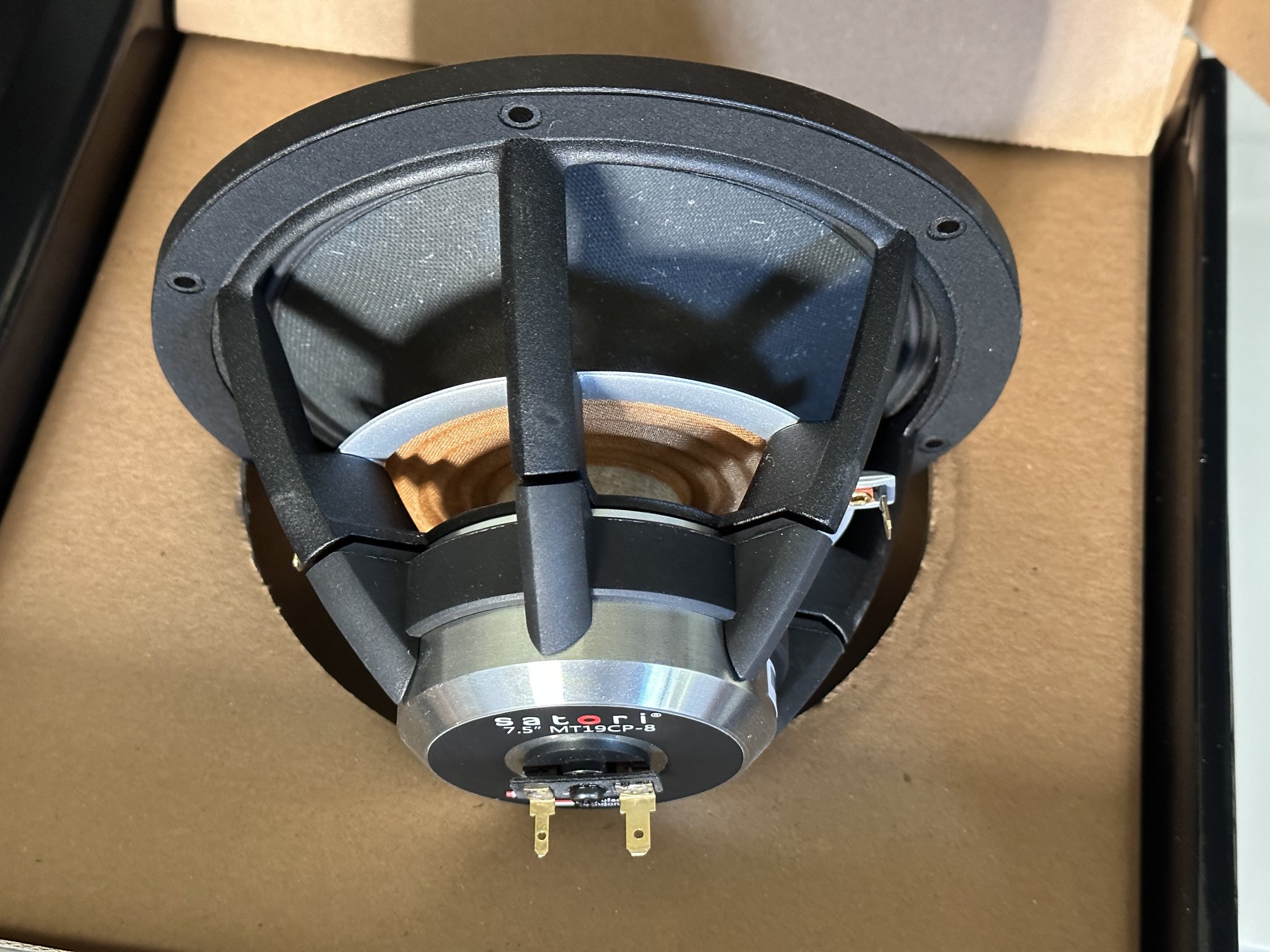

Definetly, not a Satori. Neither SourcePoint 10 nor 8. It might be some custom drivers there.
SB Satori MT19CP-8 images attached.

For instance , the large dia. metal disc reflects much more sound than those magnets that the SB Acoustics Satorians use! Also , the large dia. spider makes no sense (again , massive reflections) because the ribbed surround determines already the system compliance! Regarding minimizing reflections within the driver it's a cheaply constructed driver ... I wonder why AJ has spend full 2 years on this design??? I see nothing special or problematic .... maybe we see an improved version next year 🙂

I'm not a brain surgeon, but I fail to see how these 2 are the same driver:
