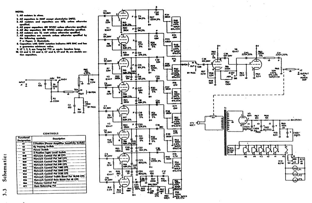

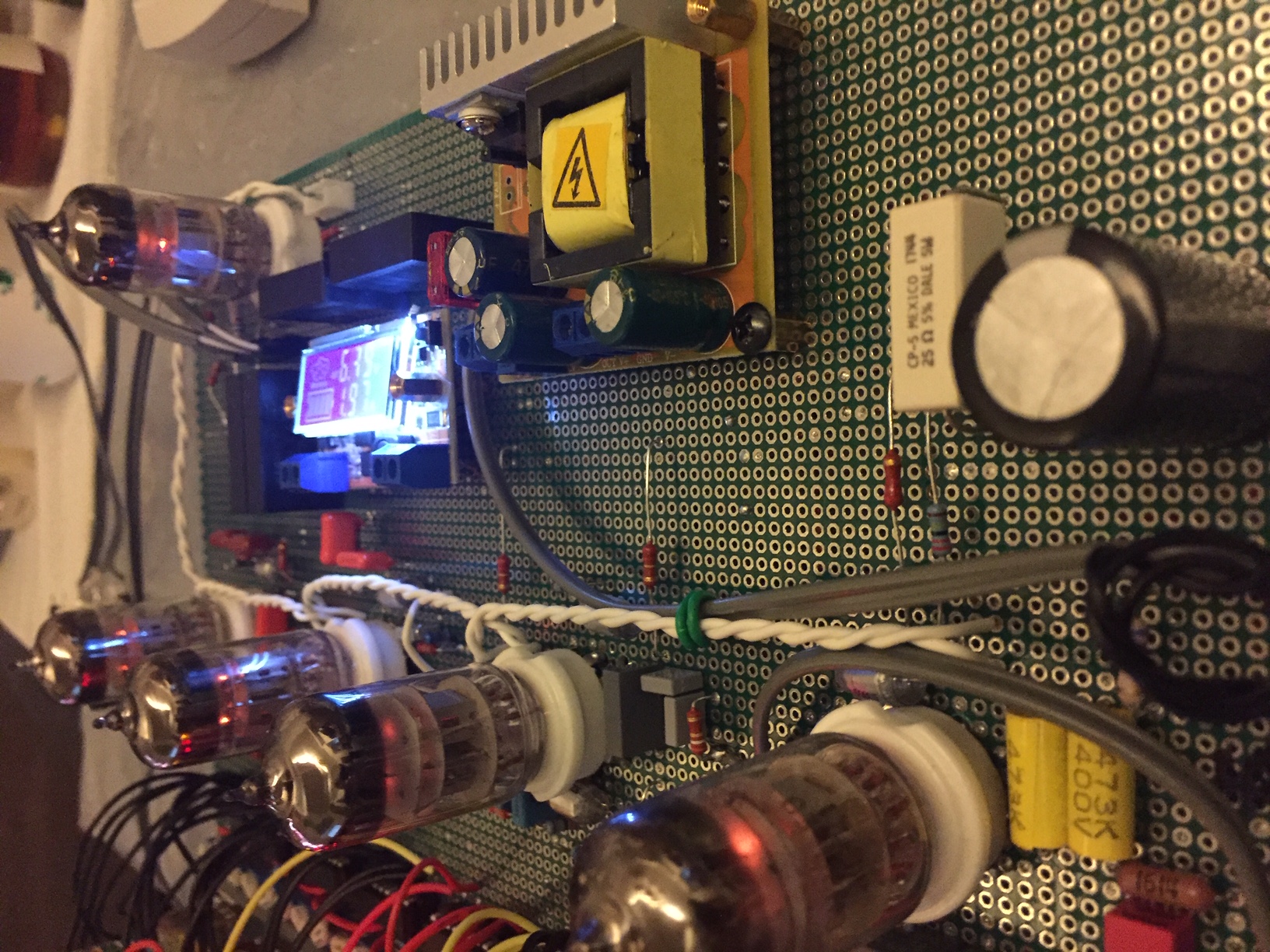

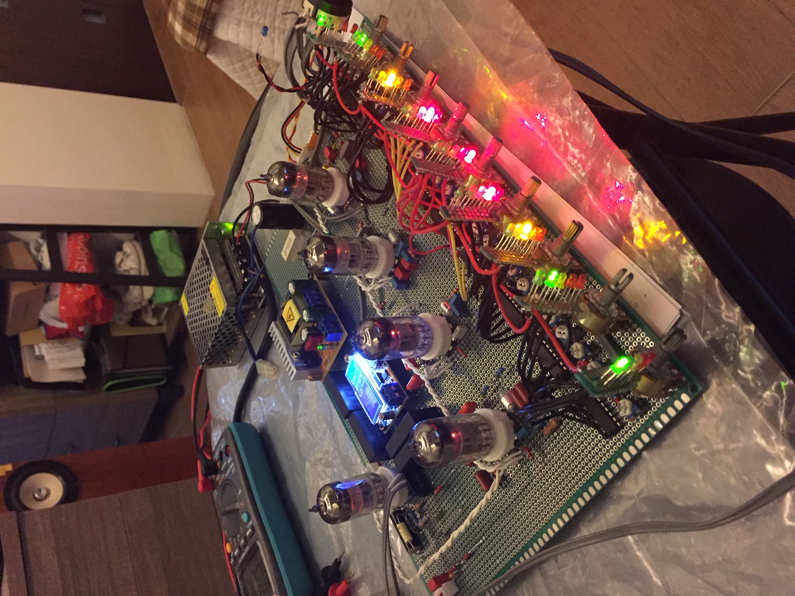

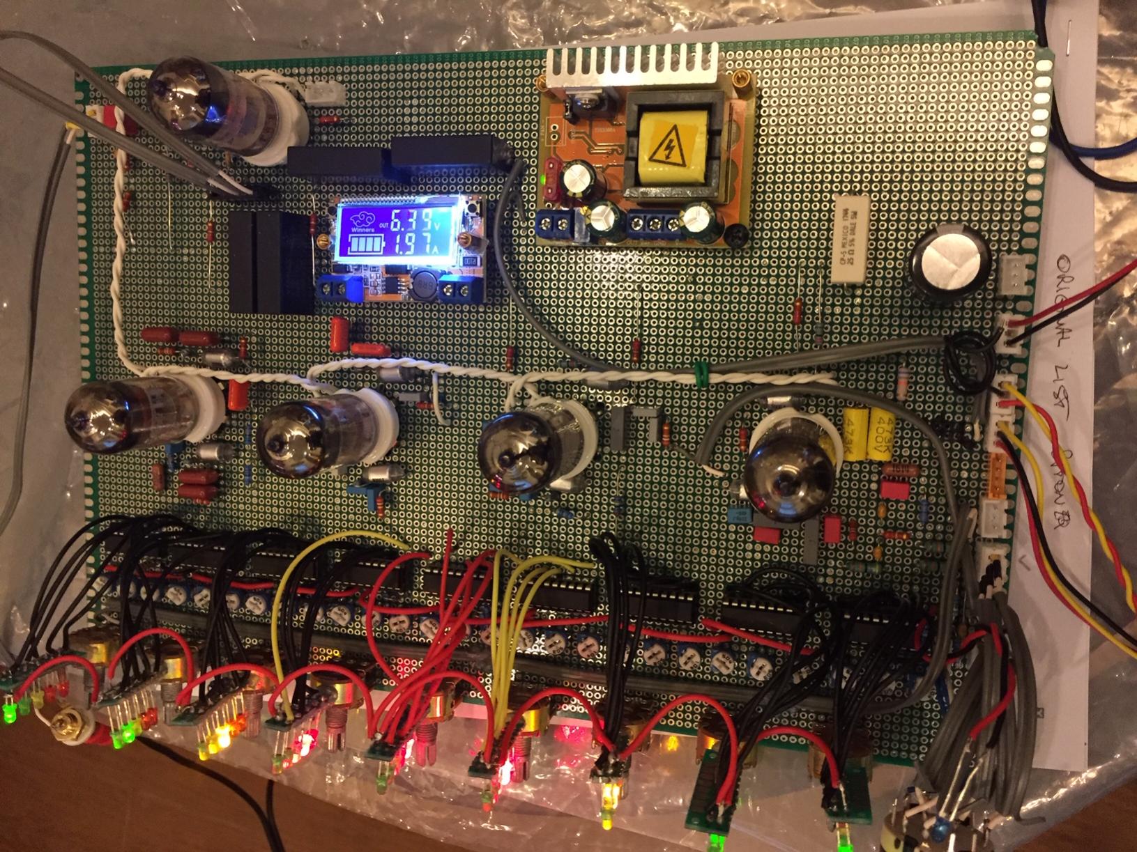

The Blonder-Tongue Audio Baton replica on the way, I just finished one channel and test it.
I stick to the original schematic but I add a 5 led bar graph, led VU meter and an unusual power supply that works very well.

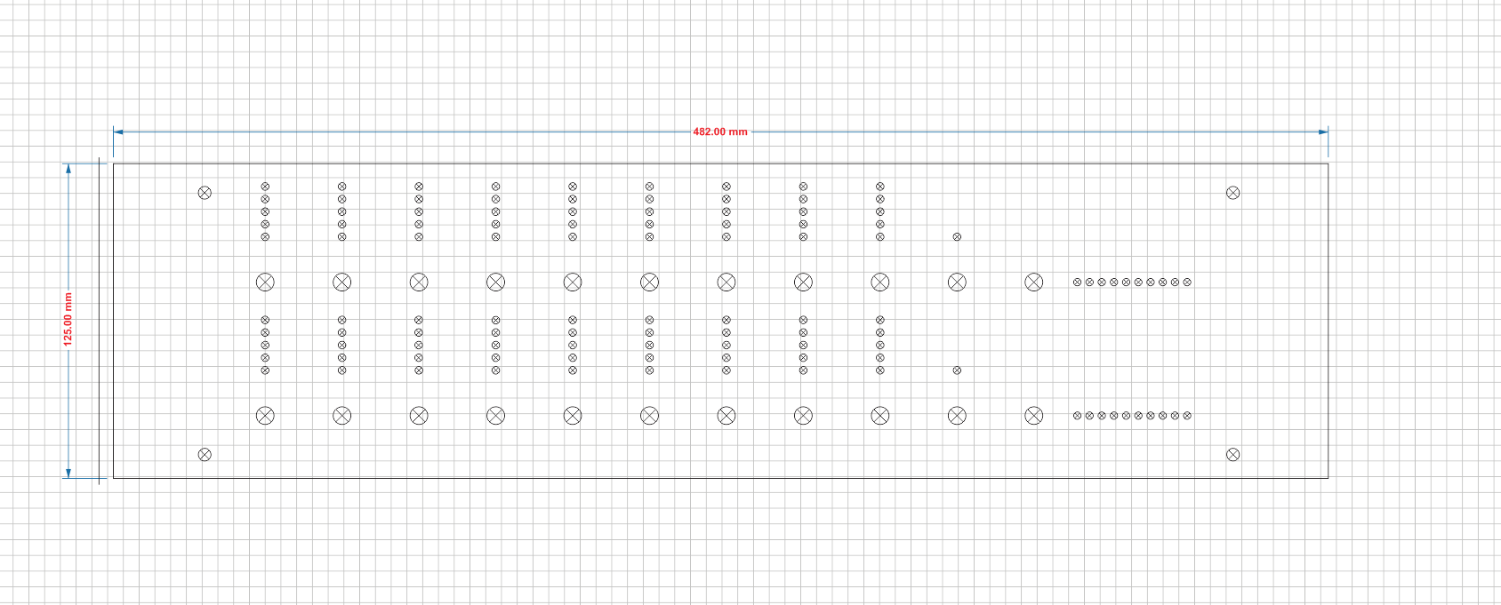

The second channel will be upside down for fit inside a 3U cabinet and when finish will looks as the picture of the front panel. Both channel will be completely independent.
Sound is excellent just some minor noise issue but I will work out on it, this is just the first test.

Have you managed to tame that switcher? I have the same one in the junkbox but it is quite noisy
