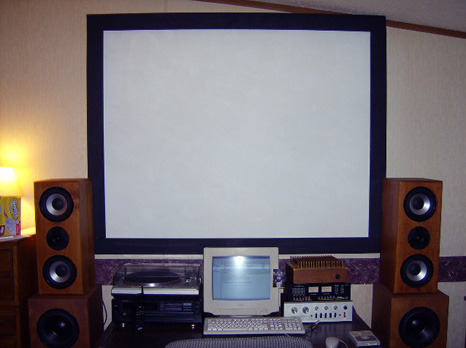

Please realize that I am not being argumentative when I ask the questions below. I know hardly anything about commercial HT. The pic at the bottom is my version of HT. It's all DIY. I could easily go 5.1 but, see no point in it in a 14x14 room.
OK?
How is this reference made? Who determines the level? Does it allow for size of room? Size of screen?
Sorry if these seem like really stupid questions. I watch movies with no bass or treble boost and volume is set usually so that you hear normal conversation (on the movie) comfortably.

The quick answer is the industry decided. Home theater amps / processors all have a calibration feature where it plays each channel in turn, and you use a spl meter to calibrate. At listening positon the spl meter will measure 75dB (sometimes 85dB depending on make / model). When done you set the volume to what it was at calibration and that is reference level.
Due to the level being set at listening that accounts for room size.
I should state that reference is 85dB per channel, though some argue that it should be 75dB for home listening. Depends on what source you look at. I set mine at 85dB per channel, and generally watch films between reference and - 5dB.
I use Avia dvd to calibrate my system (I also have digital video essentials to check DTS)
Screen size is unimportant as far as the audio side of things go. Your setup looks great and in no way needs the sound turned down as far as I can see. 😎
BTW I don't use a centre channel either as I just don't have the space right now. If I had the space I'd definitely use one. (my room is 20 x 10)
