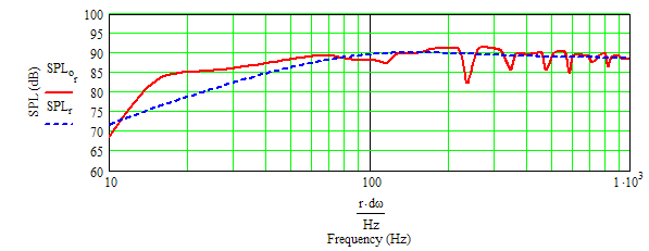

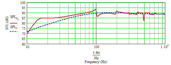

MLTL:
L = 79.345"
WxD = 58.758"^2
zdriver = 24.496"
zport = near/at the bottom
dport = 5"
Lport = 55"
stuffing density = 0.2 lbs/ft^3

What would my expected F3 be in either of these cases? Which would sound better?
What is the Vb for the above or does that depend on how many twists and turns you give your port length?
I didn't realize the Golden Ratio had any acoustic implications. Apparently, it not only looks appealing, but has good acoustic properties?
Don't have a clue since it will depend on the room and where you place it, but simmed half space F3 = ~40 Hz with either cab.
XO'd at 35-40 Hz and a typical 4th order slope I doubt you could tell a difference due to the room's effect, though at 80 Hz the MLTL should in theory sound a bit 'tighter', but even that can probably be nulled out with stuffing.
Both cabs have the same Vb, so how you fold the vent will determine the added Vb, though the MLTL's shorter vent will in theory make it slightly smaller overall.
Yes, golden or acoustic ratios average out the internal eigenmodes (standing waves) to mimic the 'ideal' ~uniform particle density model, though with subs the cabs have to be pretty big for it to matter. Where the cab's modes are in the driver's BW though, it can make a big difference in how much stuffing is required, so while a cube is usually fine for a sub, not a good plan for a mid or 'full-range' driver, unless it's a B@$# of course!

GM said:but simmed half space F3 = ~40 Hz with either cab.
Gulp! But I was shooting for F3 of 20hz-ish. My 8" Scanspeaks vented do 40hz in a smallish 3 cu foot box.
My buddy's current MK commercial sub probably hits 30hz before the small sealed box starts to constrict it.
??? So? How much output do they have below 30-40 Hz where these two cab alignments are optimized for? I mean if you XO these two at 40 Hz, the half space F3 is around 12 Hz, but these numbers have little/no relevance since the room will boost/alter any speaker's response below 100 - 300 Hz depending on a number of variables. Not to mention that at rated power the TC2k will probably drown out the other two in their optimized BW, so by adjusting the sub's signal gain you should have no problem getting an in-room level match.
GM,
I appreciate your patience with me. On your graphs, what is the difference between the blue and red line. Is one the drive output and the other the summed system output?
