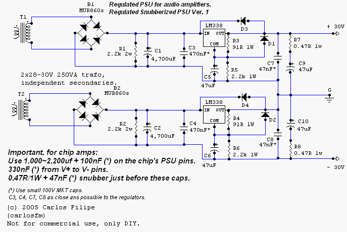

Jan,
I suppose we are talking about chip amps here.
And this PSU.
One member has tried this complete PSU as I recommend and he is very impressed.
If that's worth something for you, of course.
http://www.diyaudio.com/forums/showthread.php?postid=631625#post631625
PS: good to see you back on form.🙂

janneman:
Unless I'm totally out of it, two LM4780's per amp on a 4ohm nominal speaker could deliver over 100W. 😉 Theoretically, I think over 200W? Though not probable all said and done. Again, thats not saying I'm ever going to actually demand that much, but it could come close depending on the configuration I end up with speaker-wise. We're talking a somewhat high sensitivity dipole, and there can be a lot of power demands by the woofers in this case. Higher sensitivity should mitigate power needs, but I may end up having to give up on that particular design goal to keep the size of the final project within the realm of what will fit in my house reasonably! This is a pair of LM4780's being used in the SyperSymmetry layout proposed by Nelson Pass. 4780's because low impedance is entirely probable, and a simple pair of 3886's may run into trouble.
oh yeah - on "who to believe" - if it's a simple circuit, why not try it? 😉
So, it's one LM4780 per channel, right?
Then a complete LM338 PSU per channel will do.
http://www.diyaudio.com/forums/showthread.php?postid=636970#post636970
No need to parallel regs, no need for pass transistors.
Just independent rectifiers/caps/regs per channel.

carlos: Two LM4780's per channel. Four for a two-channel amp. Hence my desire to have a little more juice available than a single LM338 provides. I can always just go high-cap snubbered or whatever.
Upupa: I'm aware of that one. 🙂 In fact, it's the one I was alluding to when I stated in my first post I haven't figured out where they get their listed voltage range (4.5V-25V) to know if my target 30V was do-able or not. 25V would not be a problem regardless. It's on the table.
