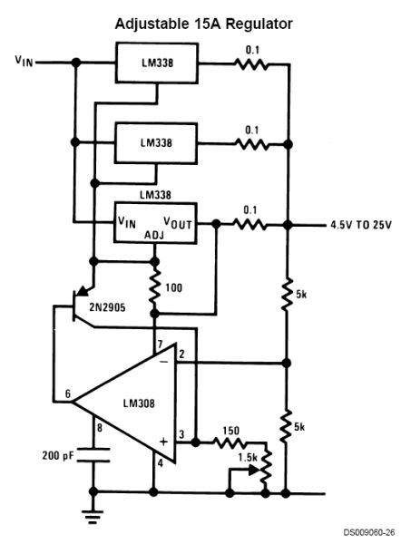

Look at 338 datasheet, there is parallel connection of three regulators, which give 15 A. Or use power transistor. All is easy, you must read datasheets and not only ask friends here :cool: .
Data sheet applications contain suggestions for possible use with the general aim to sell as many as possible. Where the hell does this 15A requirement come from?? Don't tell me you guys spec you power supply according to the max current the chip can deliver before selfdestruct? What nonsense is that?

Unless I'm totally out of it, two LM4780's per amp on a 4ohm nominal speaker could deliver over 100W. ;) Theoretically, I think over 200W? Though not probable all said and done. Again, thats not saying I'm ever going to actually demand that much, but it could come close depending on the configuration I end up with speaker-wise. We're talking a somewhat high sensitivity dipole, and there can be a lot of power demands by the woofers in this case. Higher sensitivity should mitigate power needs, but I may end up having to give up on that particular design goal to keep the size of the final project within the realm of what will fit in my house reasonably! This is a pair of LM4780's being used in the SyperSymmetry layout proposed by Nelson Pass. 4780's because low impedance is entirely probable, and a simple pair of 3886's may run into trouble.

If you read my initial post, you'll note that I *have* read the datasheet - many times. The layouts they propose use obsolete chips OR are suggesting a max voltage a bit less than I would like (though not so much so that I couldn't go that route if I felt it was the best choice). Besides that, datasheets tend to give you circuits that work, not circuits that are ideal or the best. The conversation generated here has been quite clear (for the most part) on discussing the merits of regulation, and whether I should bother trying it. :)

I can follow your post and I am sure you are well aware of all the issues; in the end you have to make the decision. My numbers were just examples and it may well be that your numbers change the picture as far as max current requirements. Maybe 15A IS required for 2 channels low impedance bridge etc. But continuously, DC, at 100% duty cycle?? Even in that case, you probably are comfortable with just a few amps capability (DC) plus a couple of capacitors. That was my point, as you know.

15 A regulator : NS LM 138 , page 14 :cool: .
up,
That isn't the point. You pay me enough money, I'll design a 50 amps +/- 50V supply for you. The point is that your music system needs this only 1 sec in a forthnight. All the other time it is idling at less than an amp. So my point was, take a standard 5 amps supply and hang a couple of caps on it, and be done with it.
Jan Didden

To Jan : I agree with you, one regulator + batery of caps can make the same result. But probably better result will be with discrete regulator without feedback, LM ... can oscilate in this case. This oscilations probably are suppresed by " Carlos's snubber " ( it is the same case as " Boucherot " at output of PA, not the same case as " Carlos's snubber " connected beside rectifier ).

There are many ways to skin a cat, but the disadvantage of a discrete reg without feedback for me is that it really isn't a regulator, it's a stabilizer or super-power-zener or whatever. So, you put in all those power parts, but stop at the regulation. It is surely better than just bridge & caps, but I would just close the regulation loop. Stability can be done by the means you say or any other accepted compensation method. This is not different from the compensation of the amp itself.
Much also depends on the amp, its PSRR and other things. It is difficult to give a standard solution without knowing where it will be used.
But one thing is sure: amps are designed with the assumption that the supply is stable and for AC is the same as ground. If that is not the case (and it never is), the supply will influence the sound, in principle.

carlos: Two LM4780's per channel. Four for a two-channel amp. Hence my desire to have a little more juice available than a single LM338 provides. I can always just go high-cap snubbered or whatever.
Upupa: I'm aware of that one. :) In fact, it's the one I was alluding to when I stated in my first post I haven't figured out where they get their listed voltage range (4.5V-25V) to know if my target 30V was do-able or not. 25V would not be a problem regardless. It's on the table.
