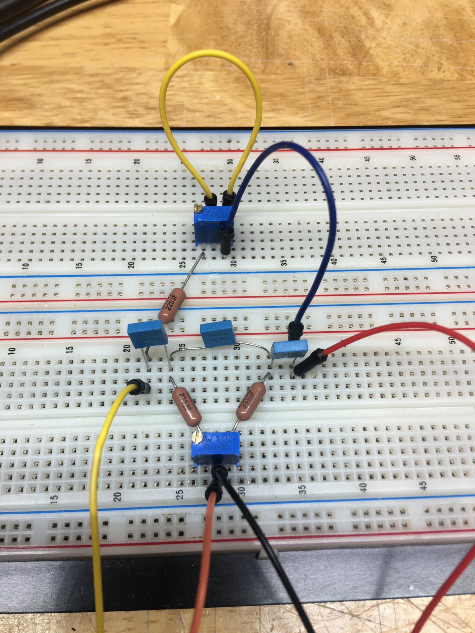

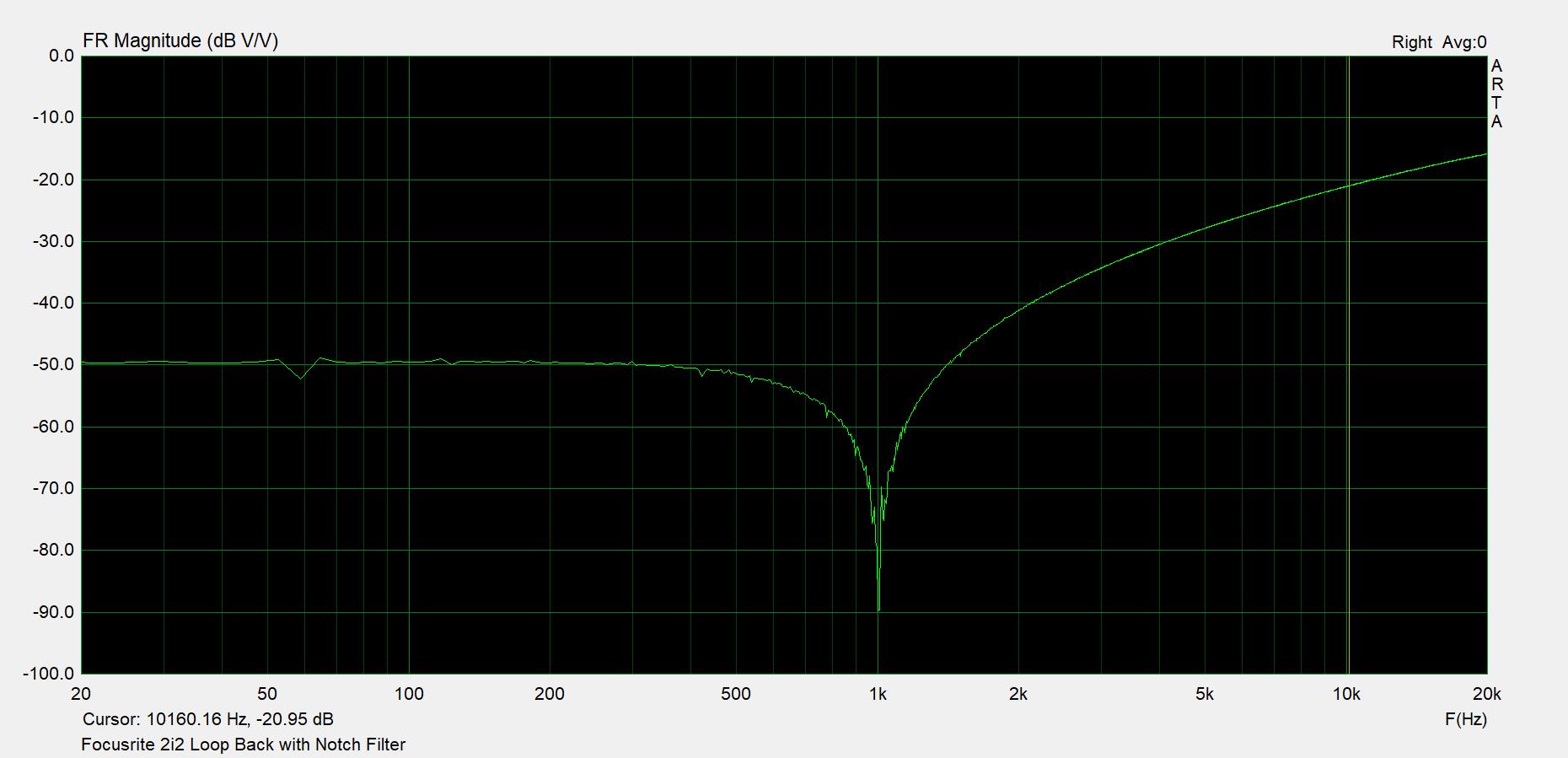

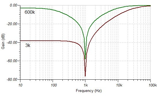

I've been experimenting with this Hall type notch filter as described in THIS ARTICLE. I duplicated the circuit in figure 6. on breadboard. Why is my output leading to the notch~40 dB down from what I expected?

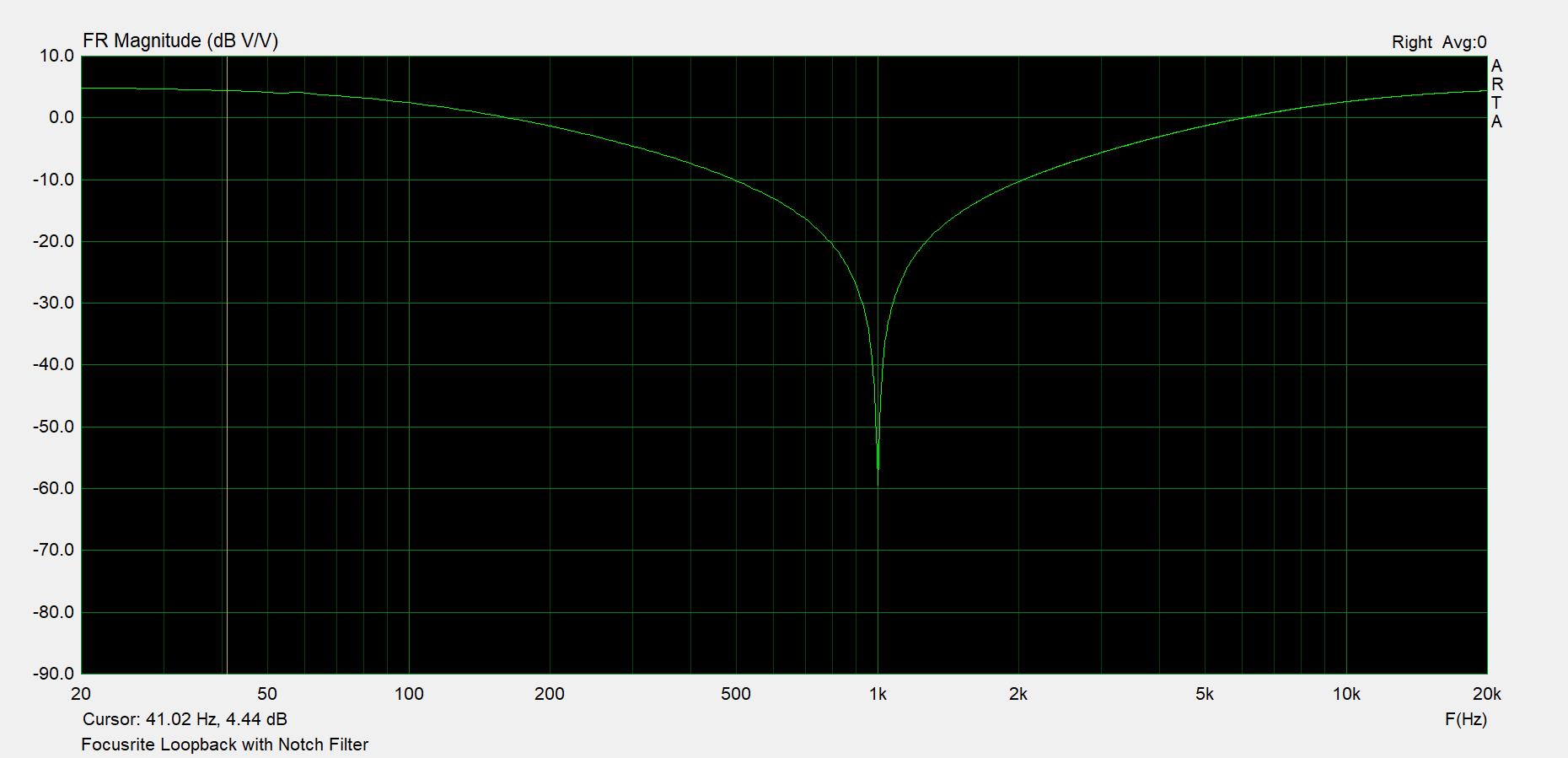

Here is the simulation of your Hall network for two impedances of the ADC inputs - 600 kOhm (instrument input) and 3 kOhm (mic input).
Martin

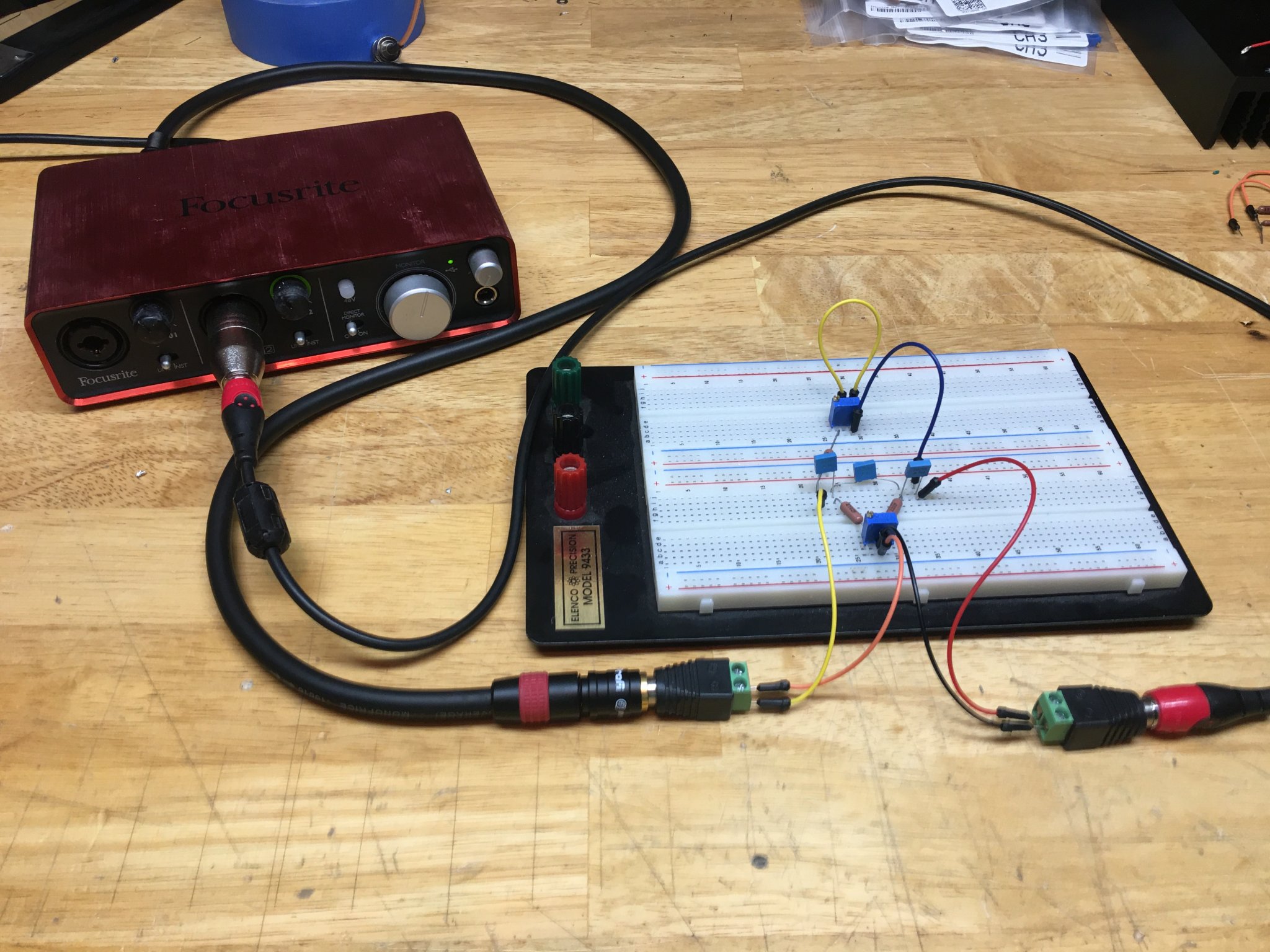

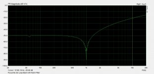

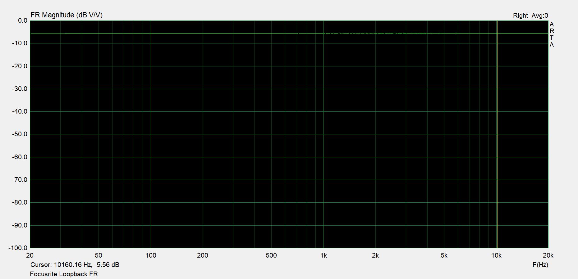

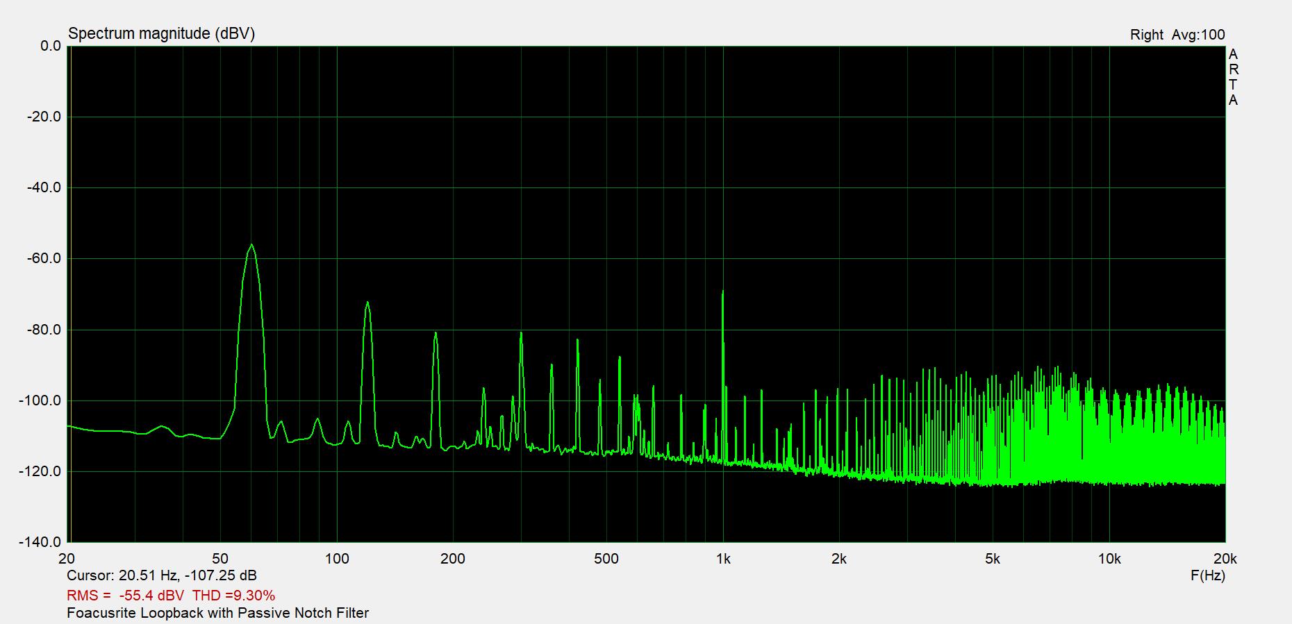

With the input of the Focusrite set to MIC I'm getting the FR as simulated above. However, when I do a 1k loopback with the notch filter in the circuit the spectrum analyzer shows a spike at 60Hz and all of it's harmonics. There is no connection to 60Hz AC mains, so where could this distortion be coming from?

It looks like ground loop noise/hum.
You can try to disconnect GND (shielding) from notch filter in one of your cables - their GNDs are connected in your Focusrite already and acts as antenna loop to pick-up the hum and noise.
Martin

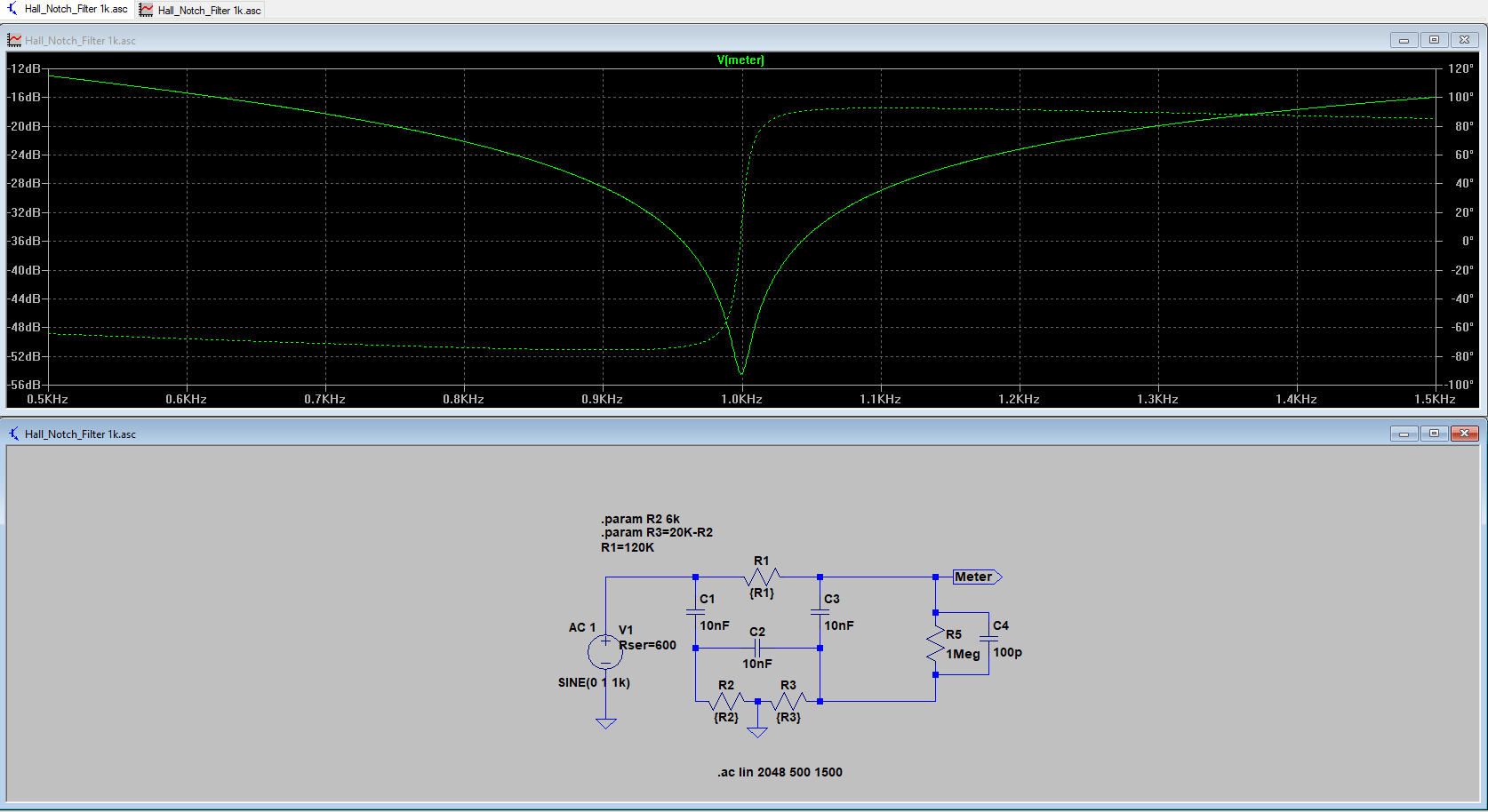

Try Hall notch filter.
Sample (1k):

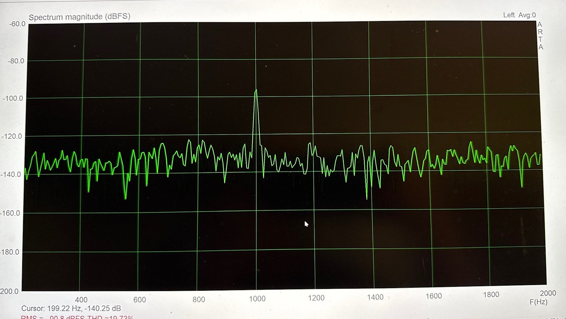

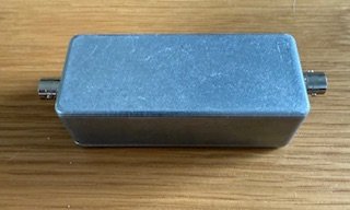

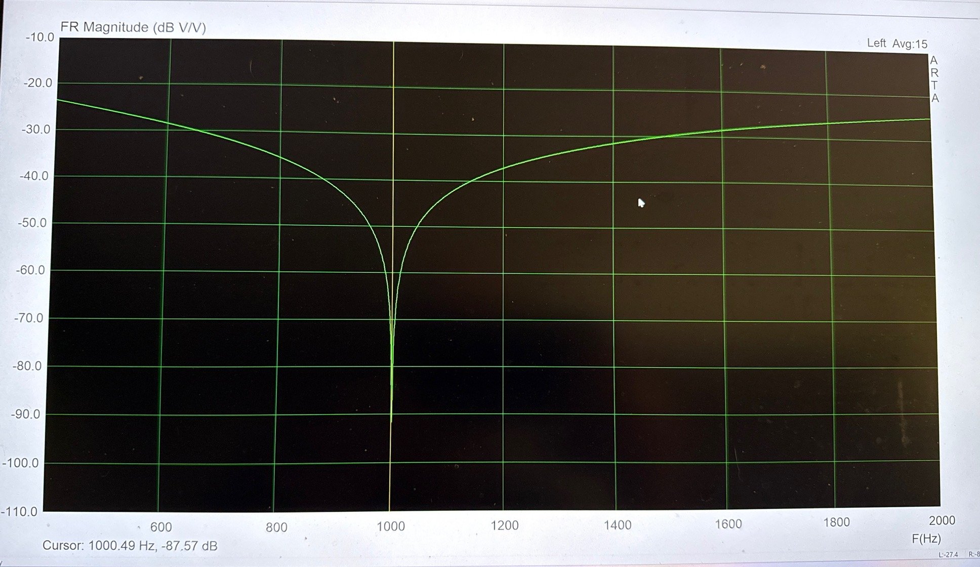

Late to the party – but this Hall notch filter is very good!
Big thanks to euro21 for sharing the LTspice file. I built the Hall notch filter in hardware based on the LT Spicel schematic and took great care in matching components.
Build Details:
  • Resistors 120k
  • Capacitors: Hand-picked from over 60 pieces to achieve <0.1% matching
  • Trimpots: R2 = 6.055 kΩ, R3 = 13.945 kΩ – measured with 4-wire technique using a Keysight 34461A
  • Enclosure: Metal housing with shielded layout and BNC connectors
📈 Performance:
  • Notch frequency: Precisely 1000.5 Hz
  • Attenuation: –84.5 dB at 1 kHz (Keysight)
  • Input signal: 1 Vrms input
  • Measurement gear: Keysight 34461A, Rigol DHO804, ARTA with 10X probe
Thanks again for sharing this gem! 🙂

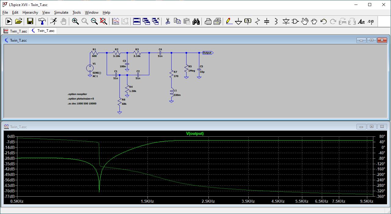

cosmo61, well worth checking at lower and higher temps to see how much all the component drifts affect the notch - may give peace of mind over time, or make you check the local temp when next using it.
Good point! This filter was tested at around 20 °C.
I typically only use it for short measurement sessions—max 30 minutes—so temperature drift hasn’t been a concern.
But I might still do a quick test by warming the aluminum enclosure a bit, just to see how stable the notch is.
Theoretically, 🙂 with the selected components, the temperature drift should be minimal.
With WIMA FKP2 caps, Bourns 3296W trimmers, and Yageo MF0207 resistors, a +10 °C shift from 20 °C should give:
  • ~0.05 % drift from caps and resistors (50 ppm/°C)
  • ~0.1 % from the trimmers (100 ppm/°C)
Combined worst-case shift: ~0.2 %, which could reduce notch depth by about 1.5 to 2 dB.
Still well within excellent range – mine measured –84,5 dB at 20 °C.
