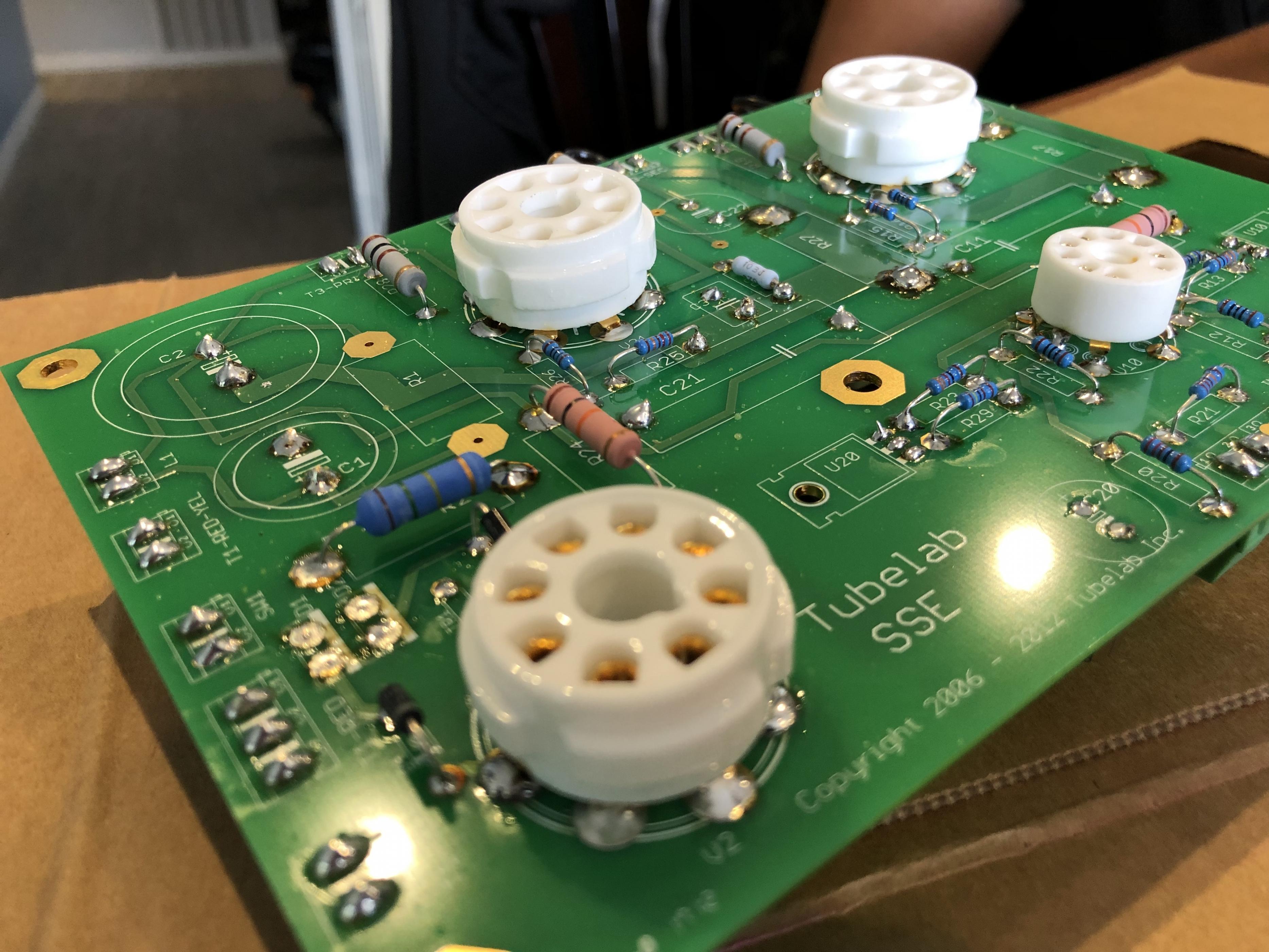

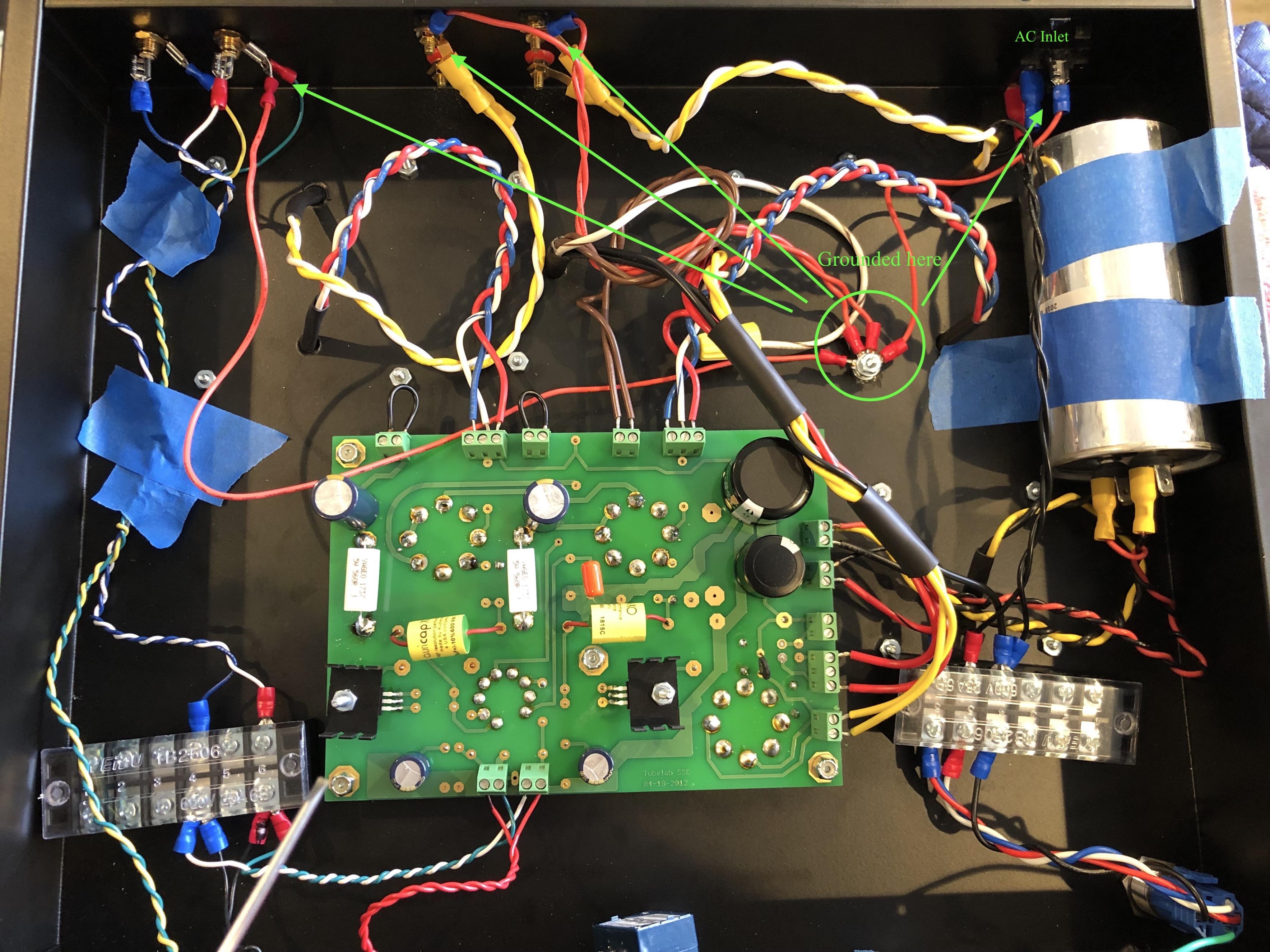

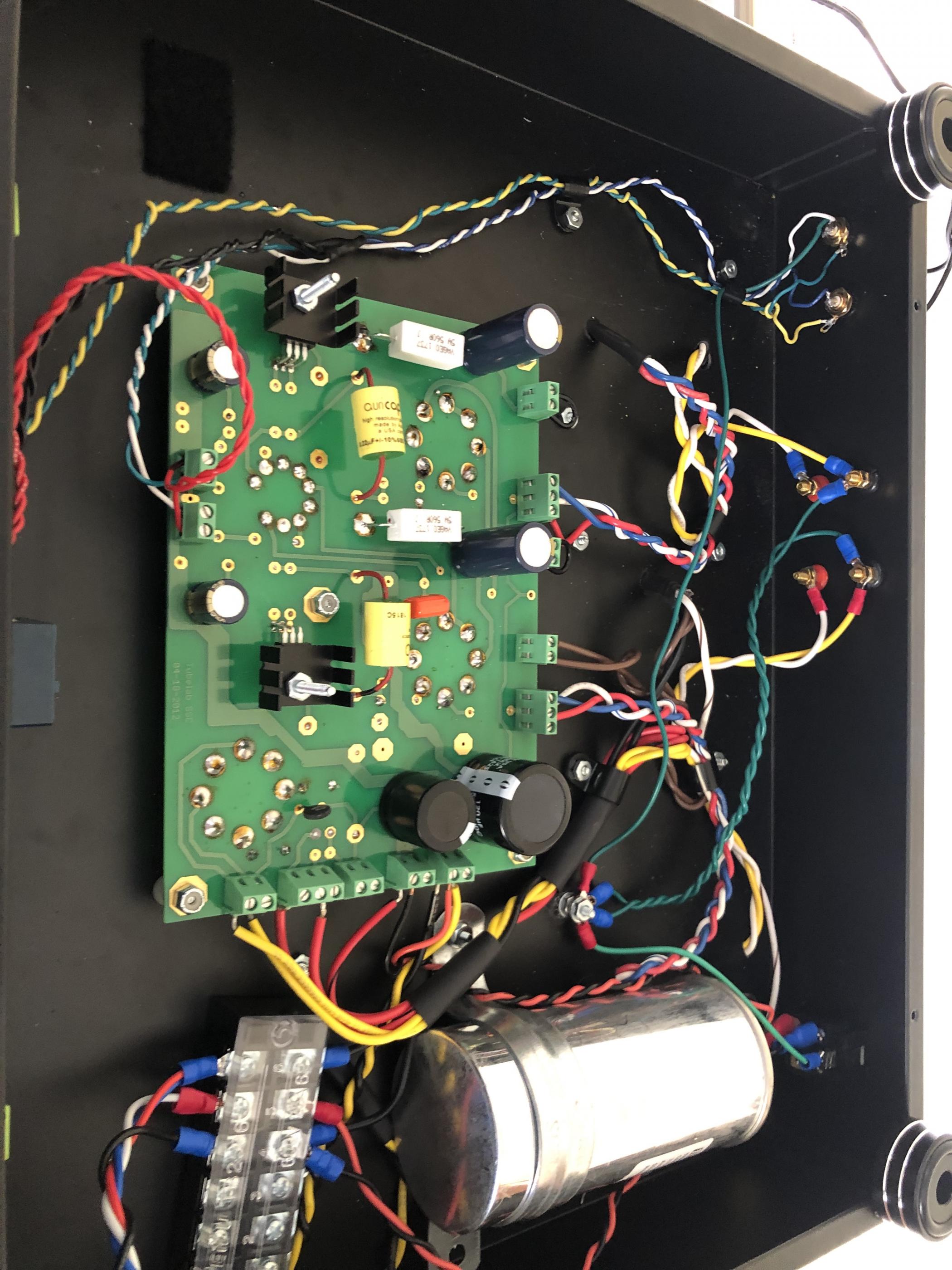

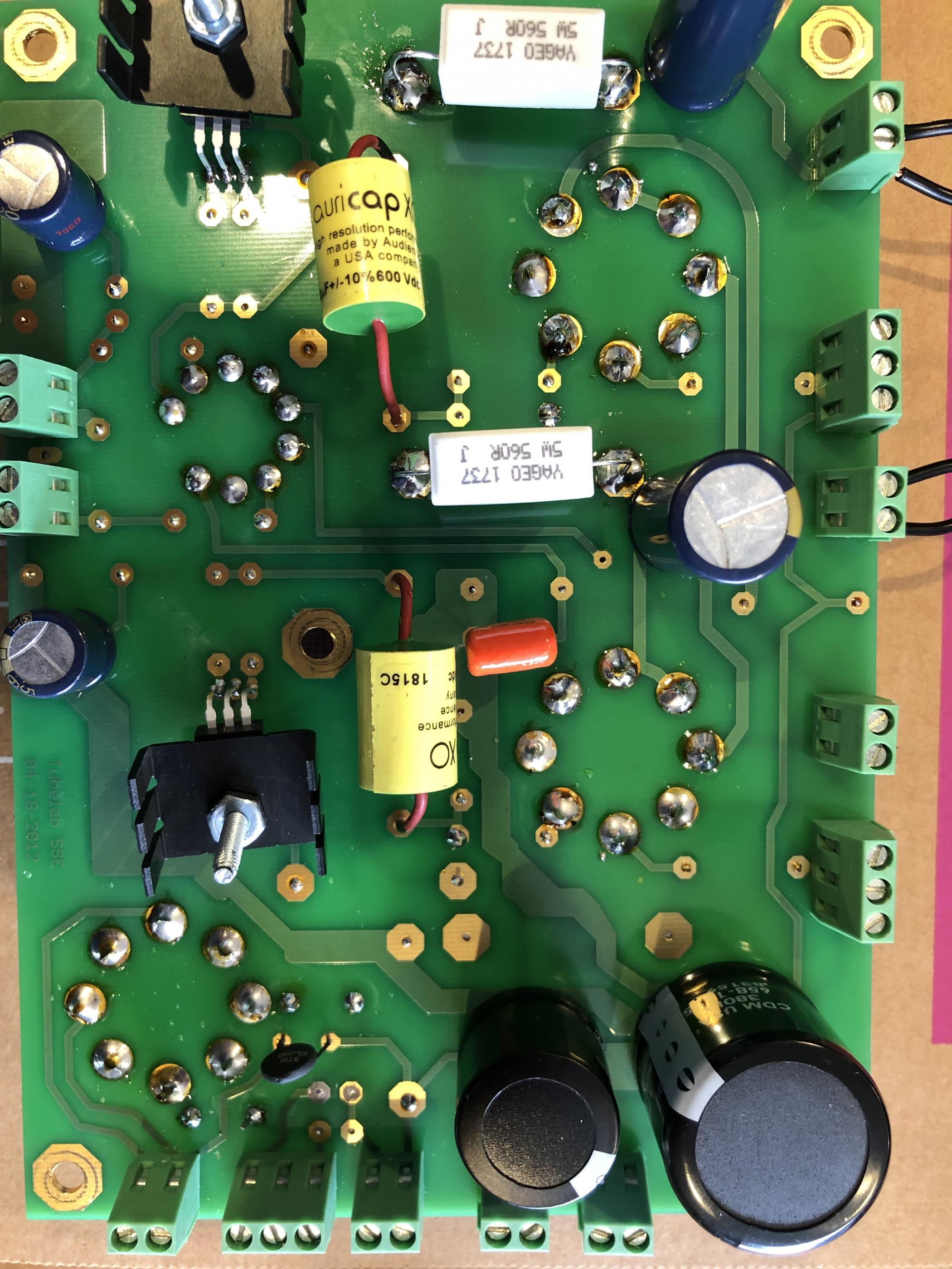

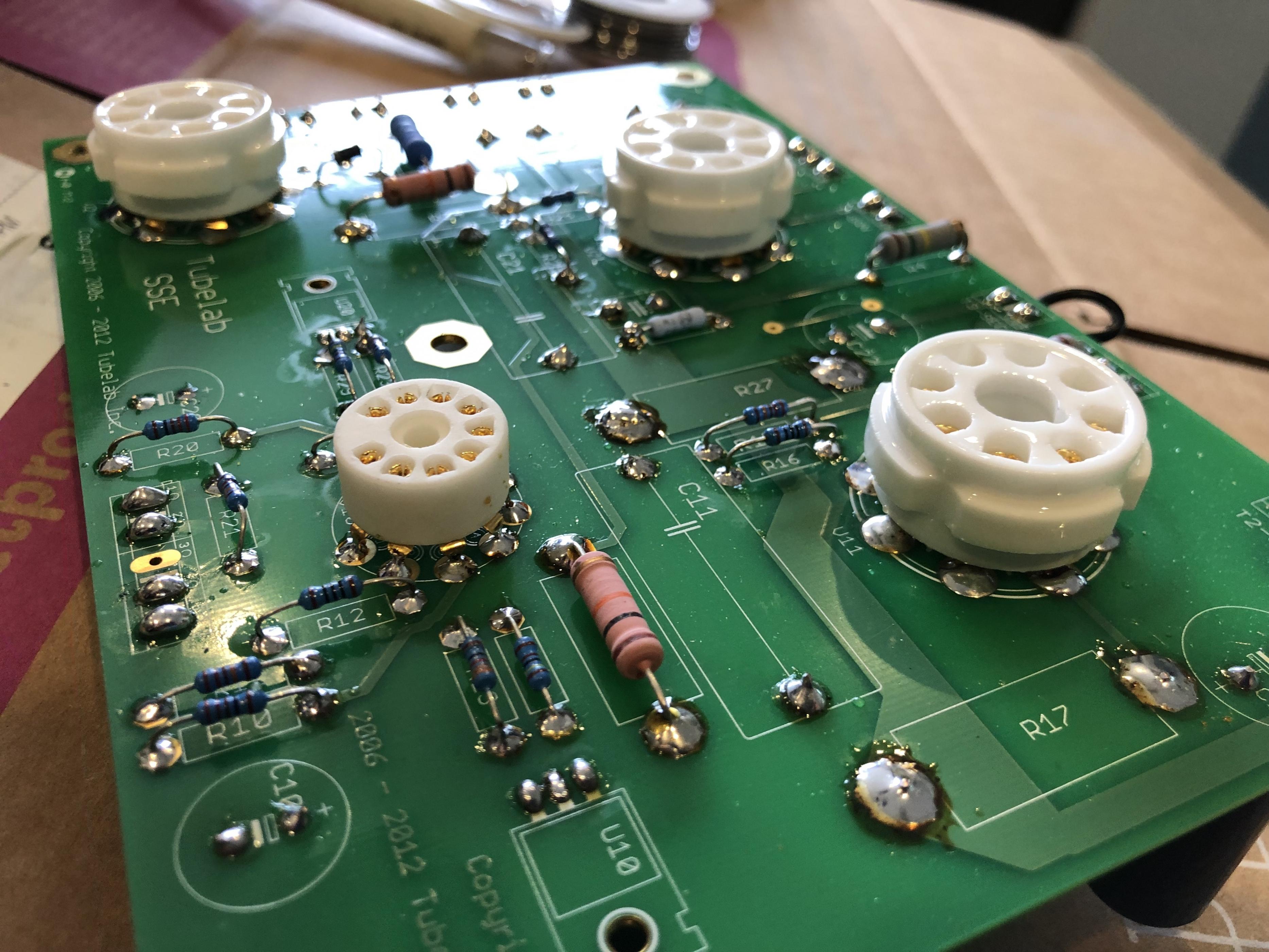

Touched up the board, here are some pictures. I also sanded down the coating on the chassis to make sure there was a good connection with the ground.
After doing this, still hearing the high pitched noise and getting an AC reading.

Those pictures should help a lot.
My SSE board is still on the shelf so I can't offer any specific tips.

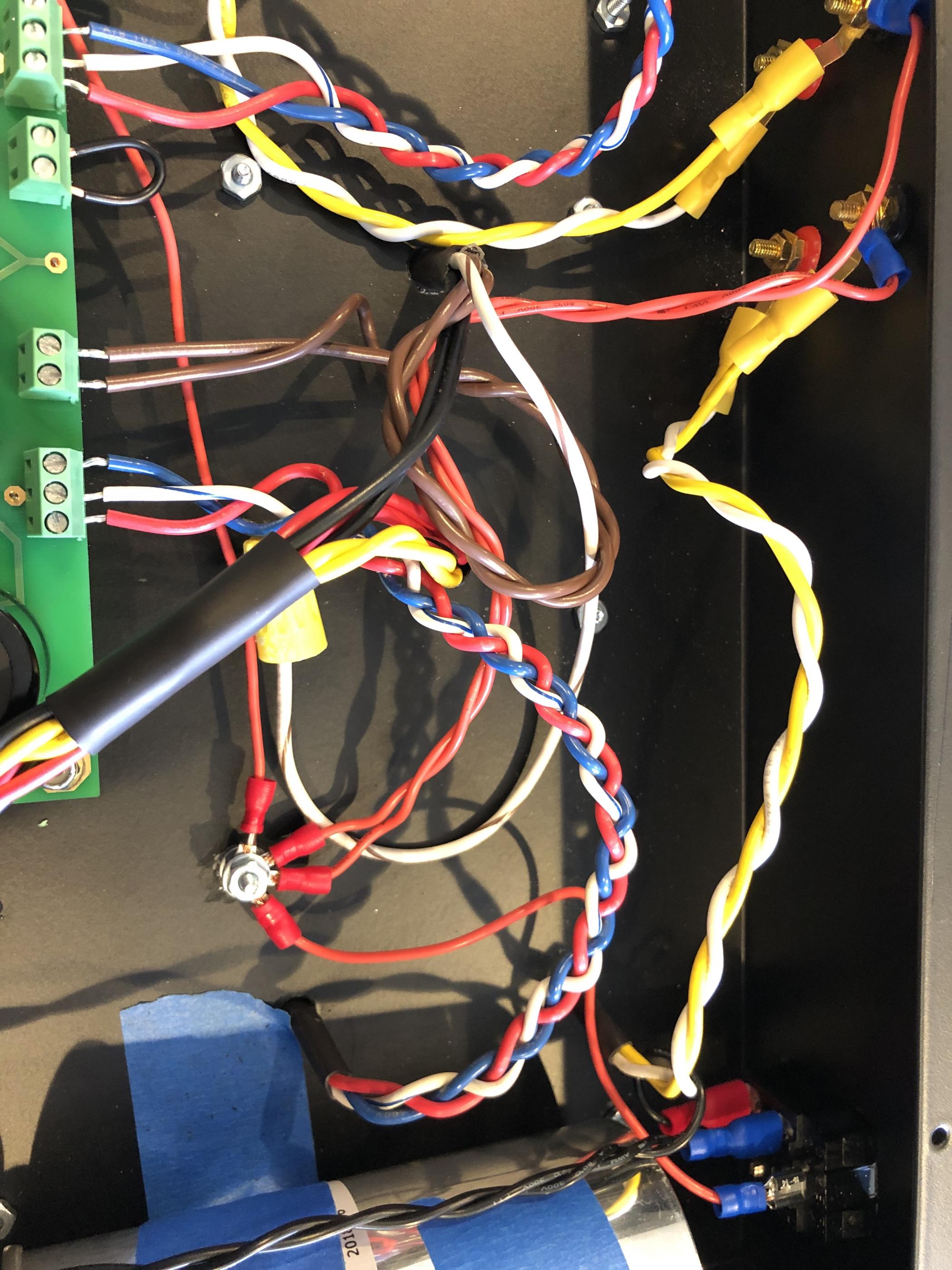

A few things that I would do differently, though they may have nothing to do with your oscillation problem....
-You seem to have used quite a few push-on (spade type) crimped connectors; I'd solder most of those connections.
- Same with the screw terminal block (with the clear cover)

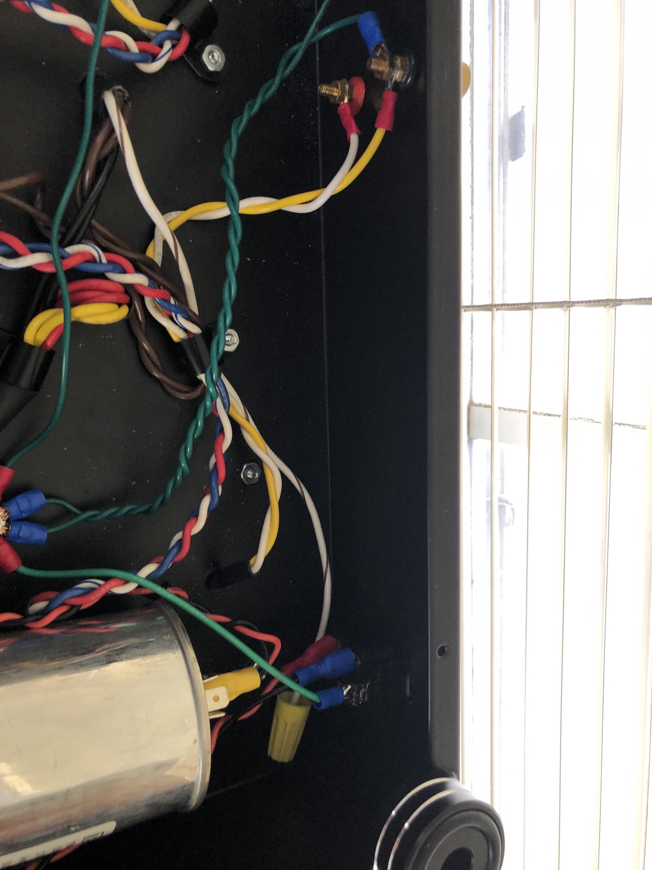

-It's a bit difficult to see, but is the safety ground (from the AC inlet or AC power cord) connected to the chassis?
-Are the jacks (input and speaker) isolated from the chassis with shoulder washers?
-If it were my amp, I'd shorten up the transformer wires so they run more directly to the board connectors.
You have a huge advantage in solving this problem because you are using the Tubelab board. That eliminates most of the 'wiring mistake' type of problems.

I did it this way to give me the ability to add CFB and UL switches in the future. If this will cause issues, I can remove, but would prefer to leave them in to make it easier to make changes.-You seem to have used quite a few push-on (spade type) crimped connectors; I'd solder most of those connections.
Yes, everything that needs to be ground is ran to a single screw, I have a wire running from that screw to the AC inlet ground. I marked the AC inlet on the pic.-It's a bit difficult to see, but is the safety ground (from the AC inlet or AC power cord) connected to the chassis?
The output speakers are, but not the inputs. Sooooo I removed the inputs from the chassis and powered it up, and the high pitched noise was gone! I also measured ac / dc on the input cable it was zero. I played it for about 15 min or so, and unplugged the cable from the source and there was no loud shrill noise.
Can the solution be that simple? Is this it? Will run it longer tomorrow evening when I have more time.
Was waiting to get the board in good working order before cleaning up the wires. I'll tie things down and get rid of the painters tape once all issues are resolved.

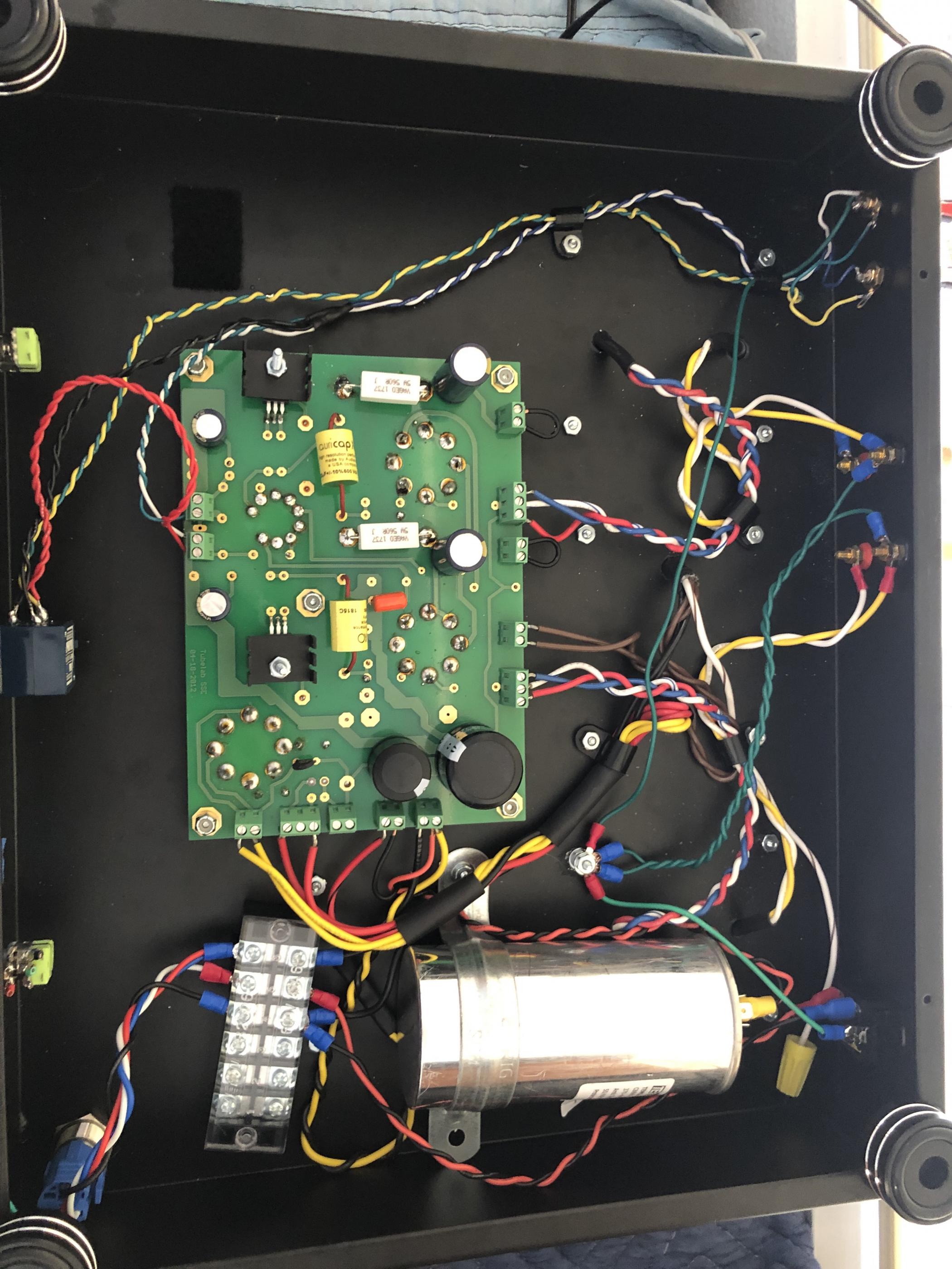

Have been using this for a few months and it’s been working great. I recently switched my input and the hum came back. I’ve been using an rca to 3.5mm cable and no hum, when I remove the cable or plug in an rca to rca the hum is back. It hum gets louder as volume goes up. If I connect the outer ring of the input jacks to ground, hum goes away but sound is very distorted and not much volume.
When not hooked up to ground outer ring of input jacks measure a resistance of 48k. Any help would be mucin appreciated.

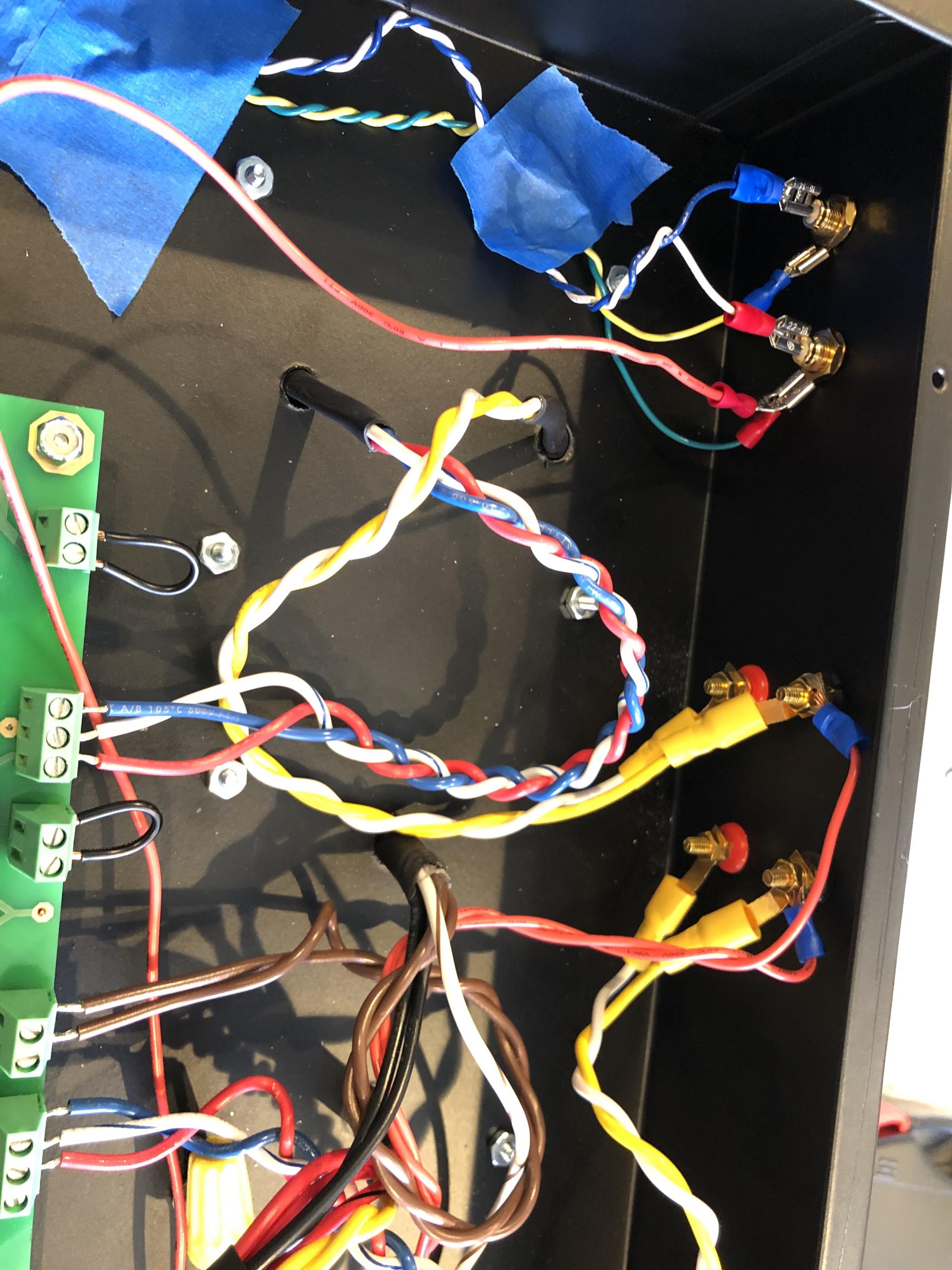

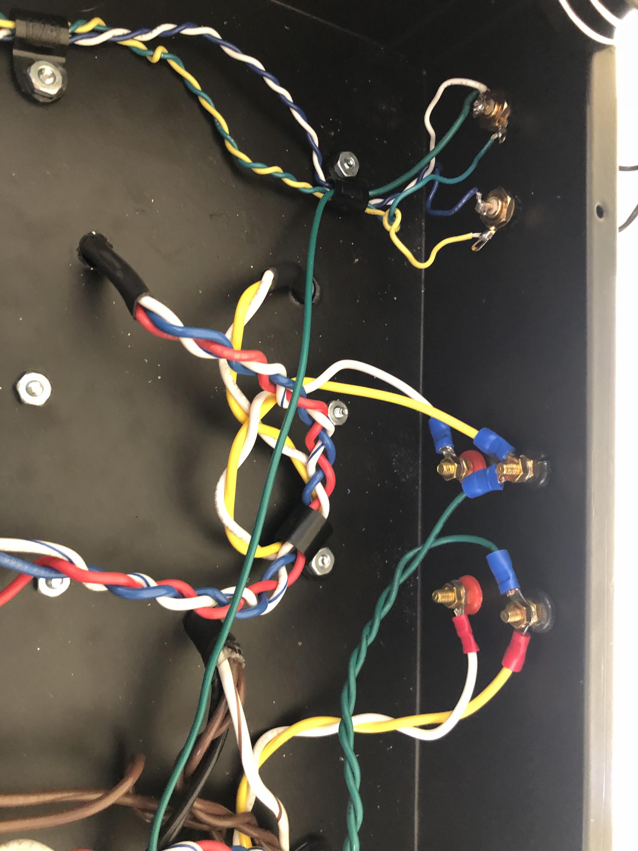

Are signal ground and signal reversed at the input RCA connectors?
Blue and white look to be signal, then they get split into green and white, and black, and then connected to signal ground.
Maybe I am looking at it wrong, but I am having trouble understanding that.
Win W5JAG
Win W5JAG
It looks like both ground wires for the inputs have been twisted, and both signal wires. What I have done with my SSE is to cannibalise an old RCA connector cable, and ensure I have a screened cable going backwards and forwards from the front to the rear of the chassis.
