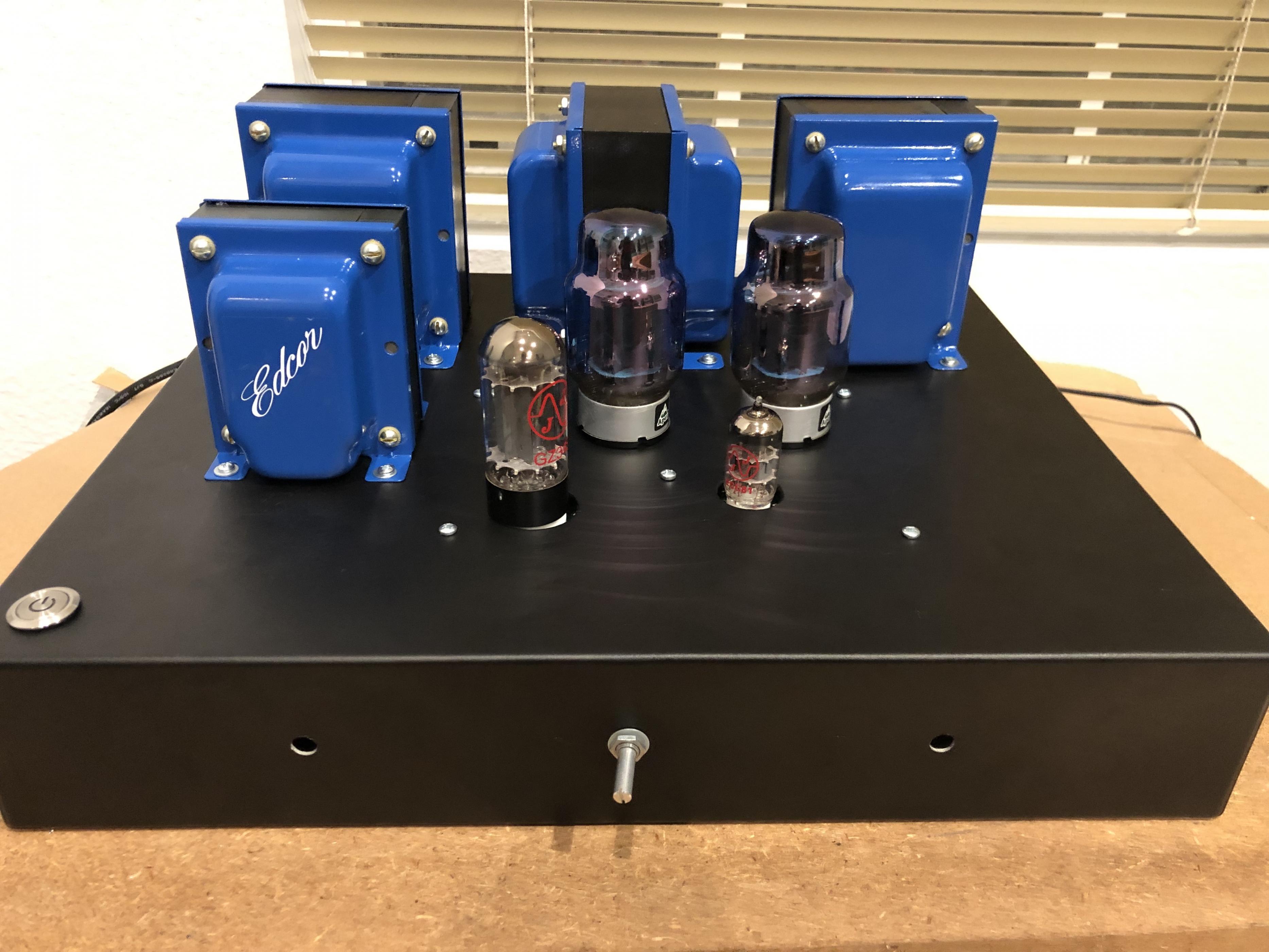

Ran into an issue that I can't seem to troubleshoot on my own.
Amp was up running on the breadboard and sounded great, after I put it into my enclosure, after a few minutes of running the audio on one channel dies out. It's consistently the same channel, even after swapping the tubes. If I power it down for an hour or so the audio will play on both channels, but after a few minutes goes back to one channel.
I've also noticed that the louder the volume, the faster the channel dies out.
Any thoughts on how to identify/fix the issue?

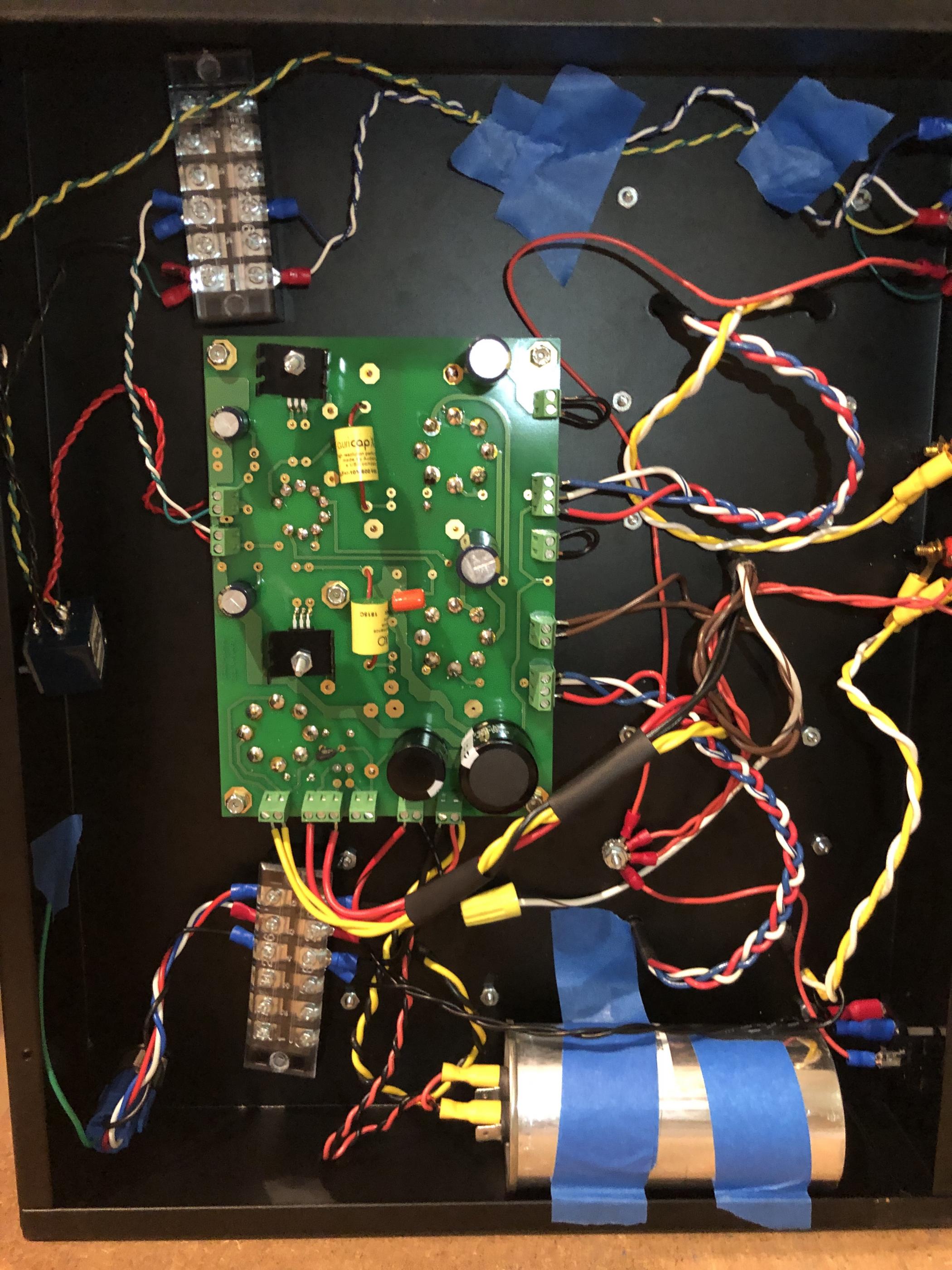

You are running KT-88's, so that will put more thermal stress on the cathode bias resistors than lower power tubes.
A sort of wild guess is that there might not be enough air circulation around your cathode bias resistors for the power tubes, since they appear to be between the board and your chassis.
Another related sort of wild guess is that, since stuff expands when it is hot, maybe you have a solder connection on those bias resistors that gets sketchy as things heat up.

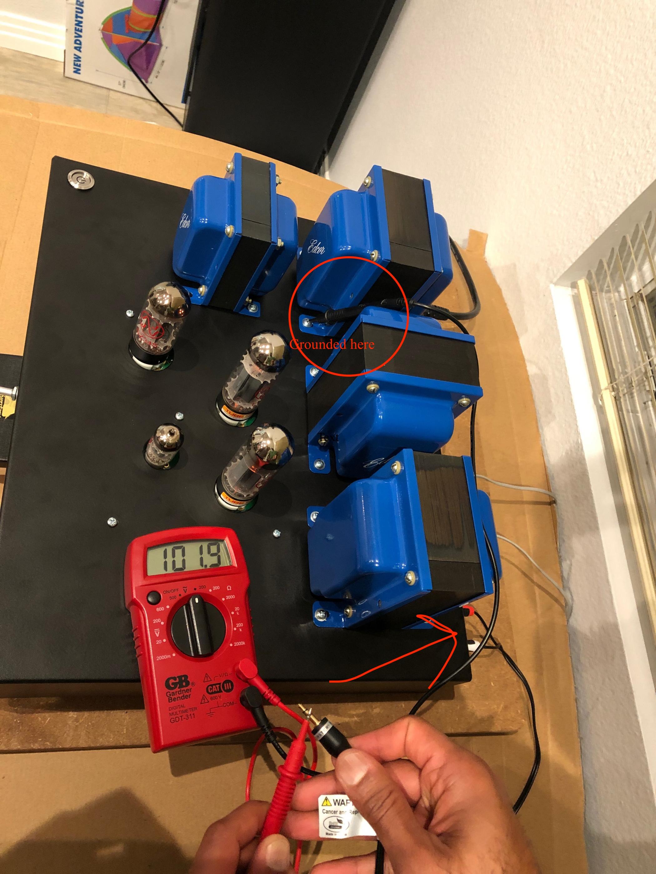

Measured the input cable with my multimeter, and it read 164 volts, any idea how I have a dc current going through input jacks?
I don't see how it is possible to get + 164 volts on the input unless there is a plate to grid short in the tube.
Measurement error seems the more likely possibility to me.
Its happened that folks get the decimal points messed up on their voltmeter readings, and also try to read DC on the AC scale, and vice versa, or combinations of all this. Not saying you have done this, but it is worth thinking about and eliminating.
- 1.64 DC volts between the grid and cathode would be about right, maybe a little low, but your input pot may have divided it down some, or the bias resistor is skewing it if you are referencing to ground potential?

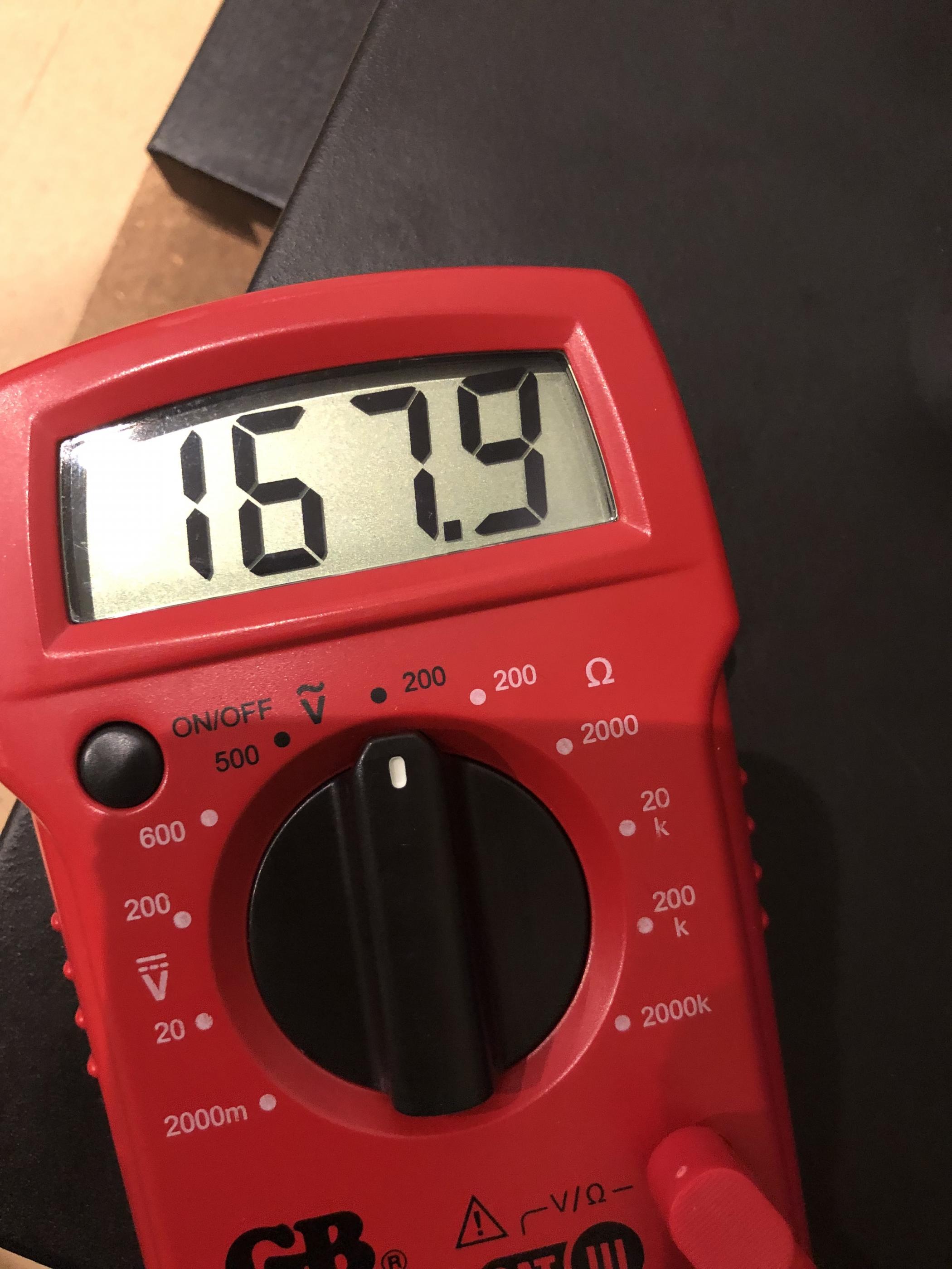

Quite possible, I am a new at this. Here is a pic of the multimeter.

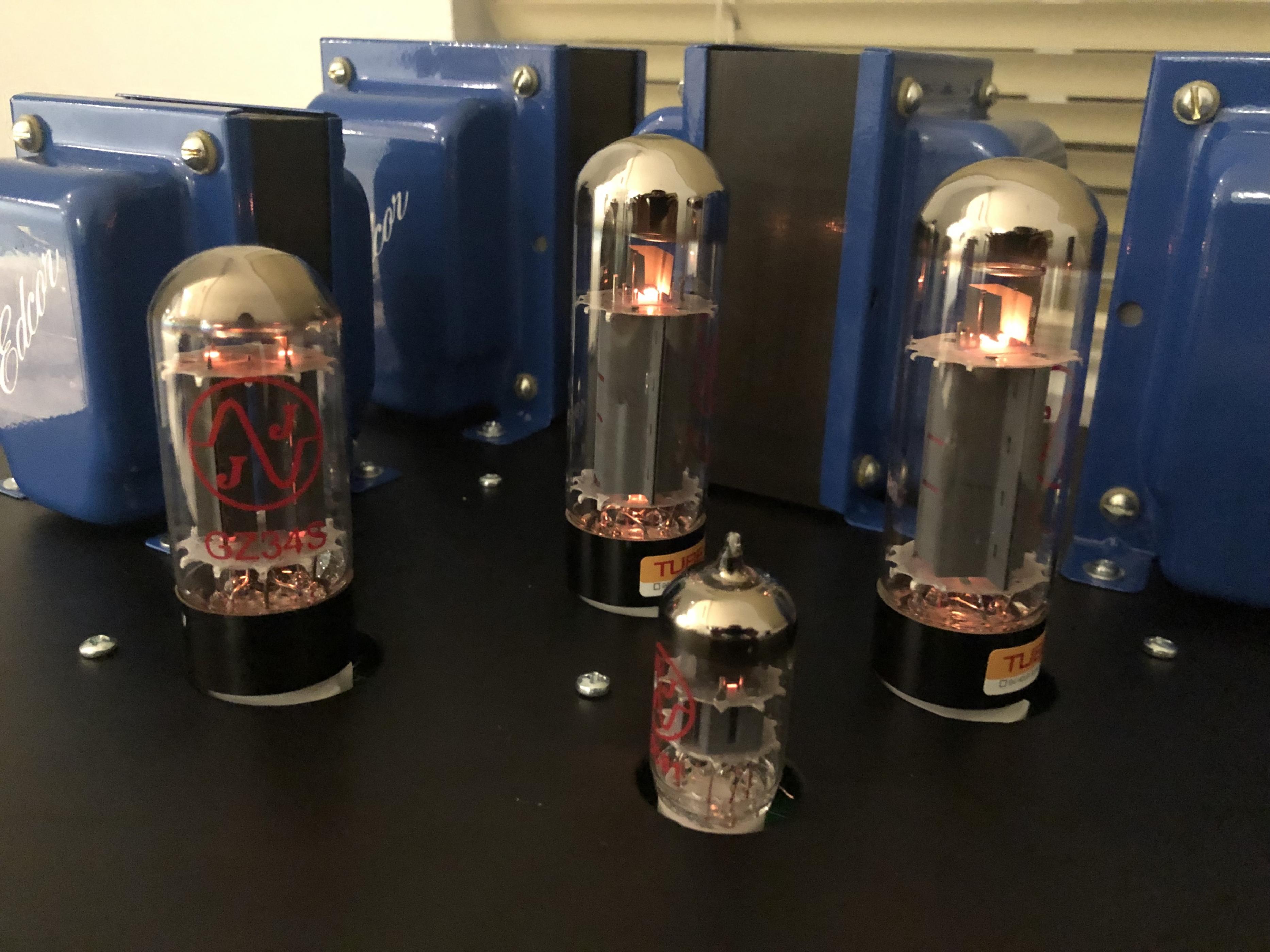

Does one half of the tube glow much brighter than the other half? It its plate glowing, or it there some blue or purple glow around or inside it's plate?
No I don't see anything off with the tube. took a pic of the tubes with the amp running.

IF poor ventilation is the fault, which remains to be determined, just move the cathode bias resistors to the other side of the board, and space them 3/8 inch or so off the board to allow air to move around them ...

The sine wave means AC setting. The DC settings are on the left.
Can you show us where you have the probes attached to obtain this reading?

OK ... well ... something is amiss here ...
First, massive hum when an input cable is disconnected from a source, but still attached to the SSE is not abnormal. I would say it is to be expected and normal.
As to the voltage you are measuring, George probably needs to weigh in on this ...

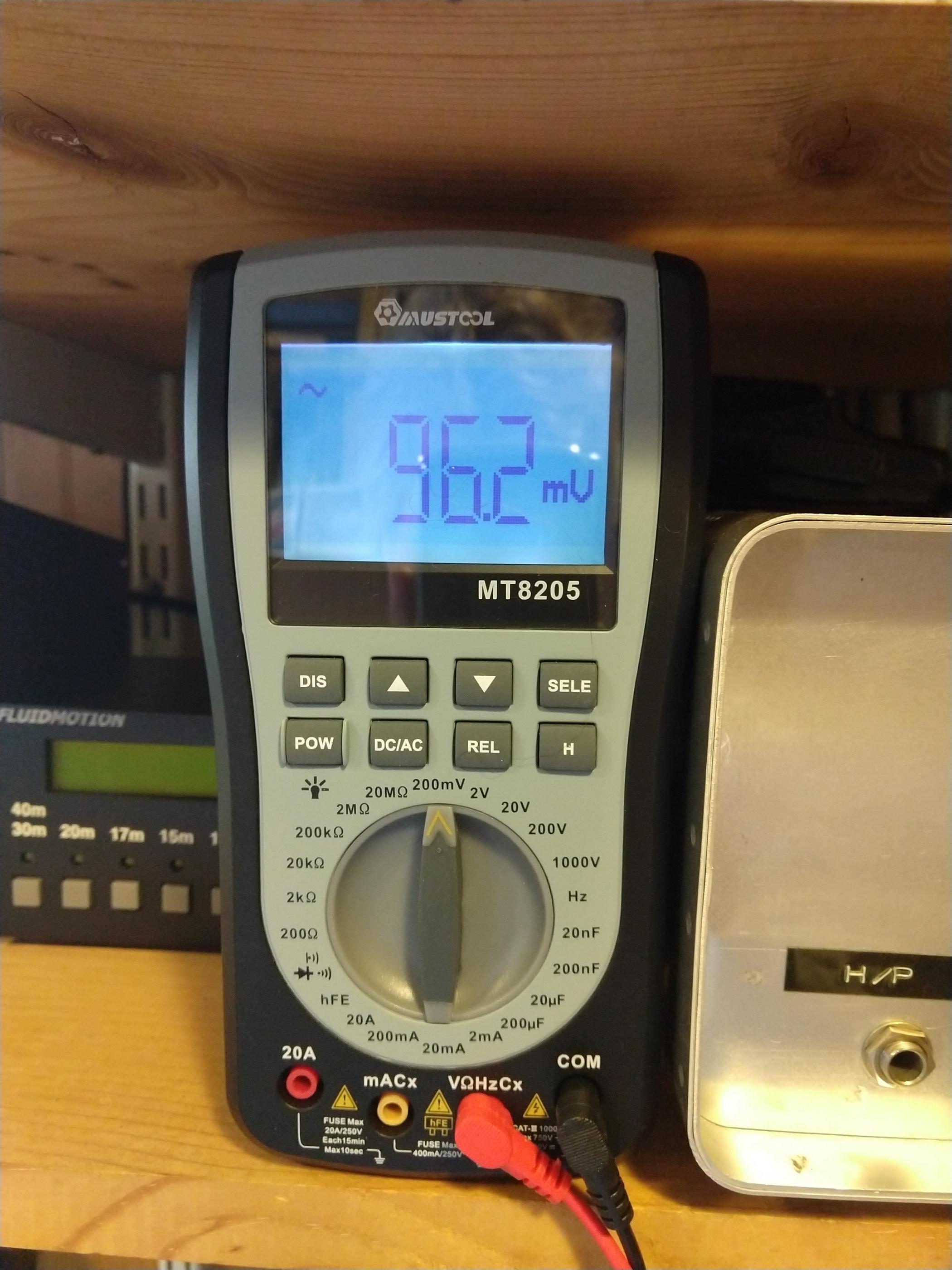

I hooked up a DMM to the inputs on one of my SSE - first pic shows ( hopefully ) the attachment. It's done through clip leads, but this is the equivalent of hooking the positive probe to the circuit board positive input of one channel, and the negative lead to the corresponding negative circuit board input of the same channel.
If you can see the graphic display on the DMM, it's just showing the AC residual from the power lines in the shack, and being randomly picked up on the clip leads.
The other pics are the AC and DC voltages the DMM is measuring. The AC is just the random stuff floating around as aforesaid. Both are in the millivolt range.
It might be informative for you to completely disconnect the bad channel input leads from the printed circuit board, and measure the AC and DC voltages at these terminals with nothing else attached to them. That way we can isolate the problem as either internal or external to the PCB.

Switched over to DC mode 200 scale, reading is zero. But when I drag the multimeter lead across the audio input cable tip, the numbers spike 100+ then immediately go away. Not so scientifically, I also touched the tip of the input cable (not sure if this was a smart decision), and depending on which part of the input tip I touched I could feel a current flow/shock.
