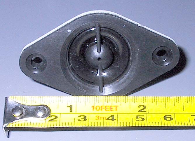

This tweeter pulls way above its "weight" class. I've used a lot of them (well over a 100 so far -- not a single one in a line array either -- gotta order some more too) as super tweeters with XO anywhere between 7 & 12k (1st order).
There is a thread here somewhere with them used in a line arrary.

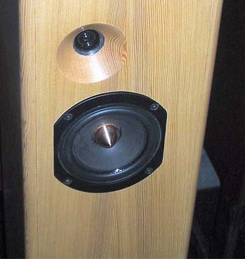

The "wings" can easily be trimmed off for a circular bezel (ie for mounting B&W style on the end of a tweeter pod). We also wave-guide load them using a 45 degree cutout and mount them from behind

bikehorn said:
a tweeter waveguide built right into the cabinet? that is too cool. how's it sound?
used 10k up, they add just a bit of sparkle to a drooping widerange or fullrange.

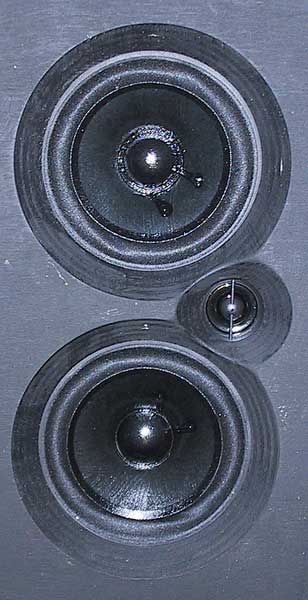

Here is another ap... these were designed to be ceiling speakers, they would be even better mounted on a wall. They use a pair of RS 40-1197s and are in an ~3" deep box (i think my buddy in LA that has them is interested in selling them too). This shows a similar technique for mounting the main drivers and creates quite an interesting looking shape.
