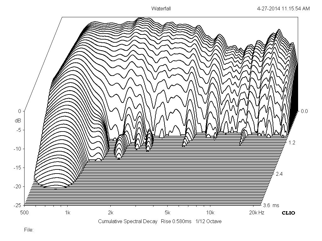

The peaks and dips probably caused by the slot have to be resonances that would show show up on a waterfall plot.

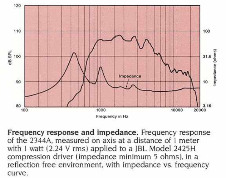

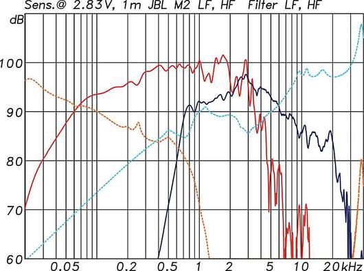

Here's an on-axis comparison between the M2 and 2344A horns without any EQ. A challenge of comparing is how the data are presented and I don't how how the M2 was measured. The M2 graph is with 21 db/decade. The 2344A graph is with 30 db/decade, which is more revealing. However, the 2344A response is shown with 12 dB oct. smoothing. The M2 graph may have no smoothing, but I'm not sure. The M2 measurements are from the german magazine Sound & Recording.
2017 M2 horn (blue curve):
attachment.php
1981 2344A horn:
attachment.php
There really isn't much difference. Between 1KHz and 5KHz the M2 is somewhat flatter. Above 9KHz the 2344A bi-radial horn looks more even, but probably only because of a more smoothed graph. Obviously they use different drivers that may contribute.

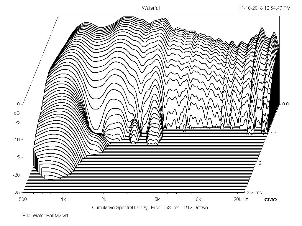

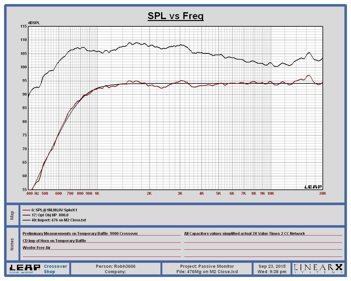

Here is a waterfall for the M2 It's pretty clean with not much hash up top I also posted a PTH1010 waterfall same driver
Rob
2342 response
JBL2342 Bi-Radial Horn @ AmpsLab
2344
2344
Dispersion is important, i get it.
But not with a bunch of resonances.
