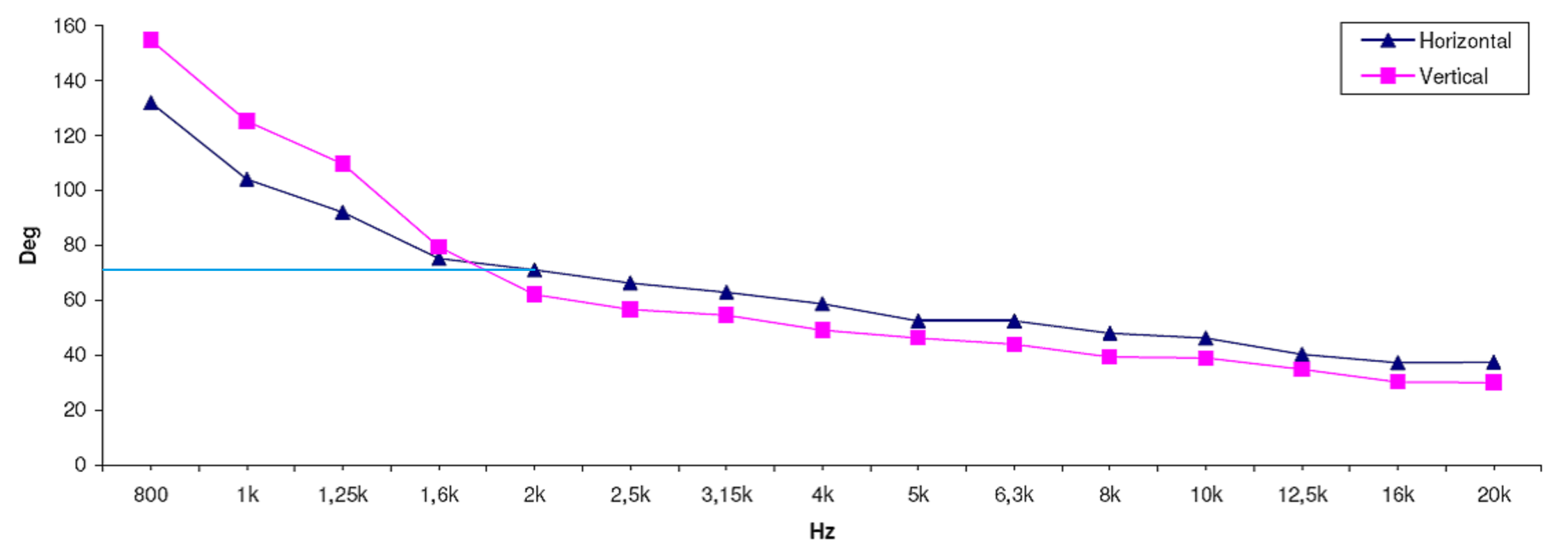

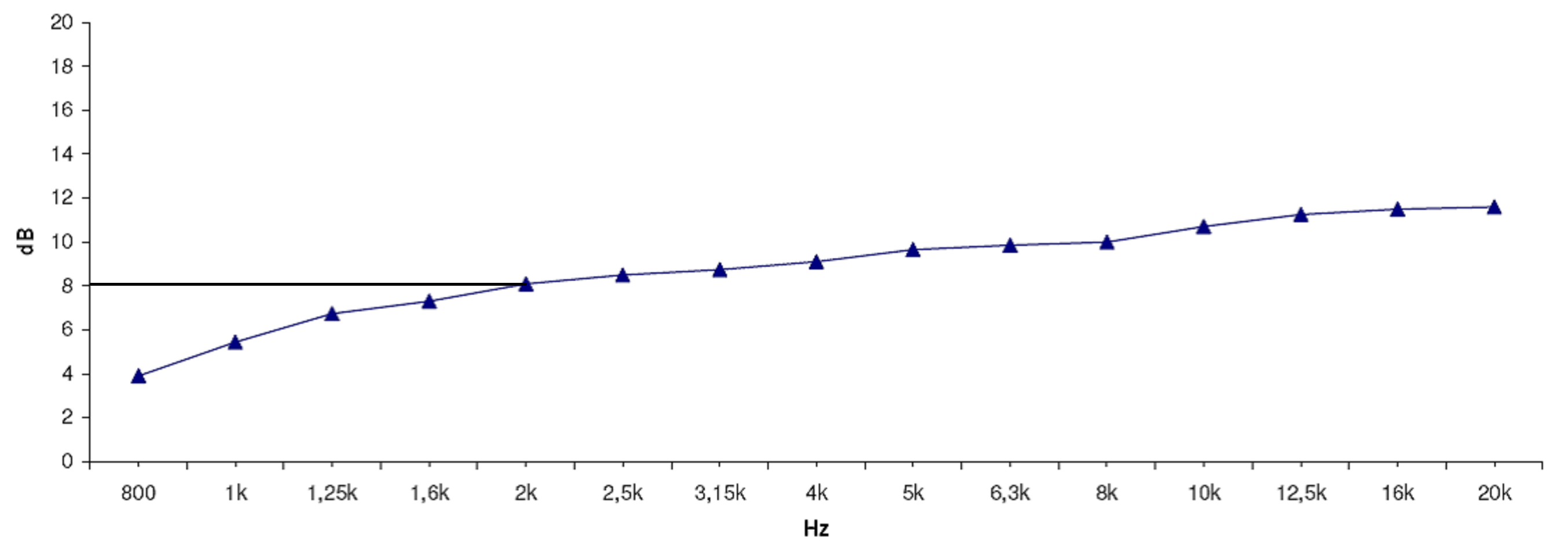

If you take and send me the data, I will process it and post it in my database.

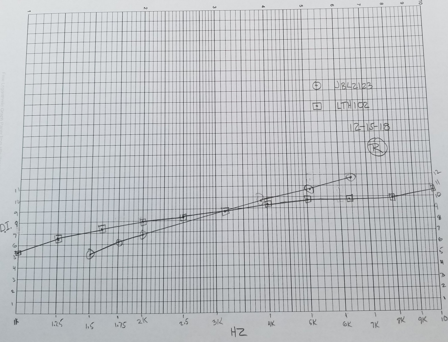

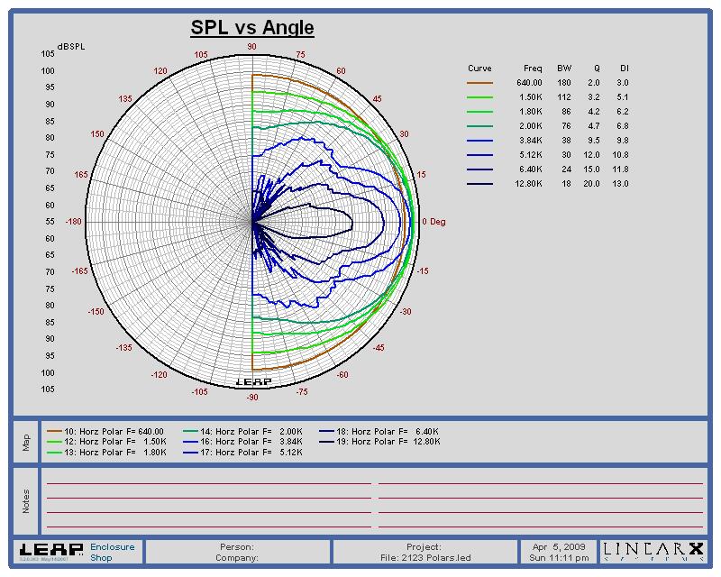

This is what I did. I looked and found polar data for the 10 inch JBL 2123 mid-range. I went to the FatialPro site and down loaded their polar data for LTH102 waveguide plus the HF111 driver. The crossover to the woofer, JBL2204 12 inch at 300Hz is down into the room modes. The woofer will be replaced with a JBL2235 15 inch.
I plotted the DI data to graph paper and picked a crossover point (2K) close to the point that the DI curves crossed. All this data stuff is attached.
