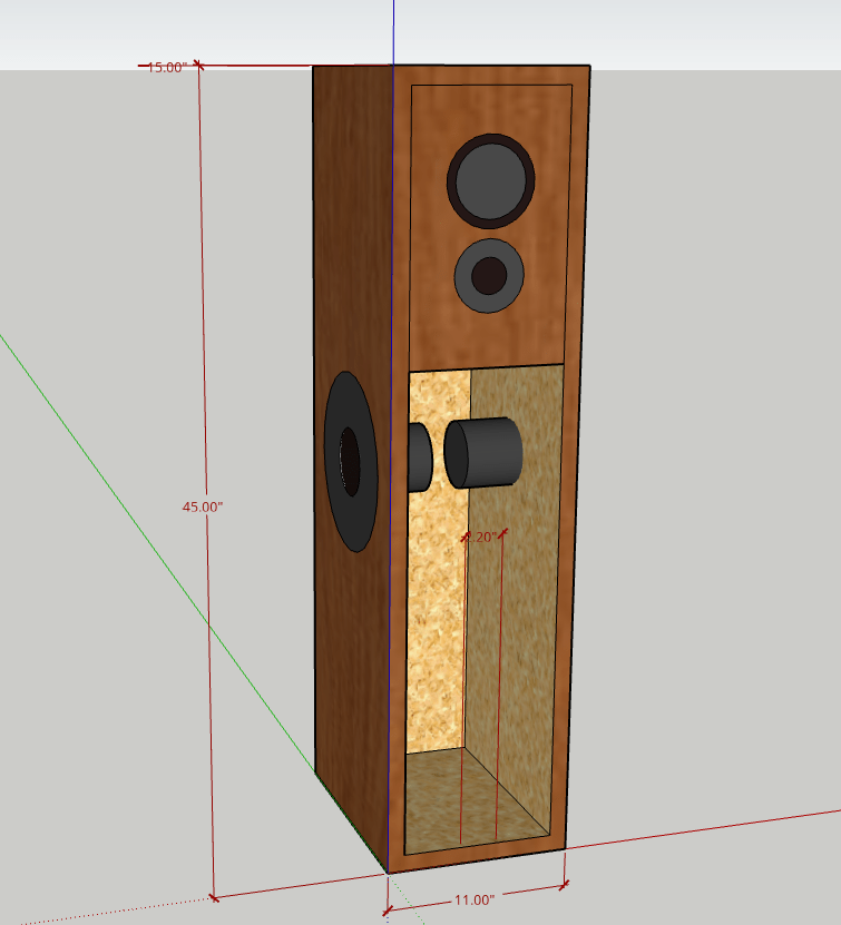

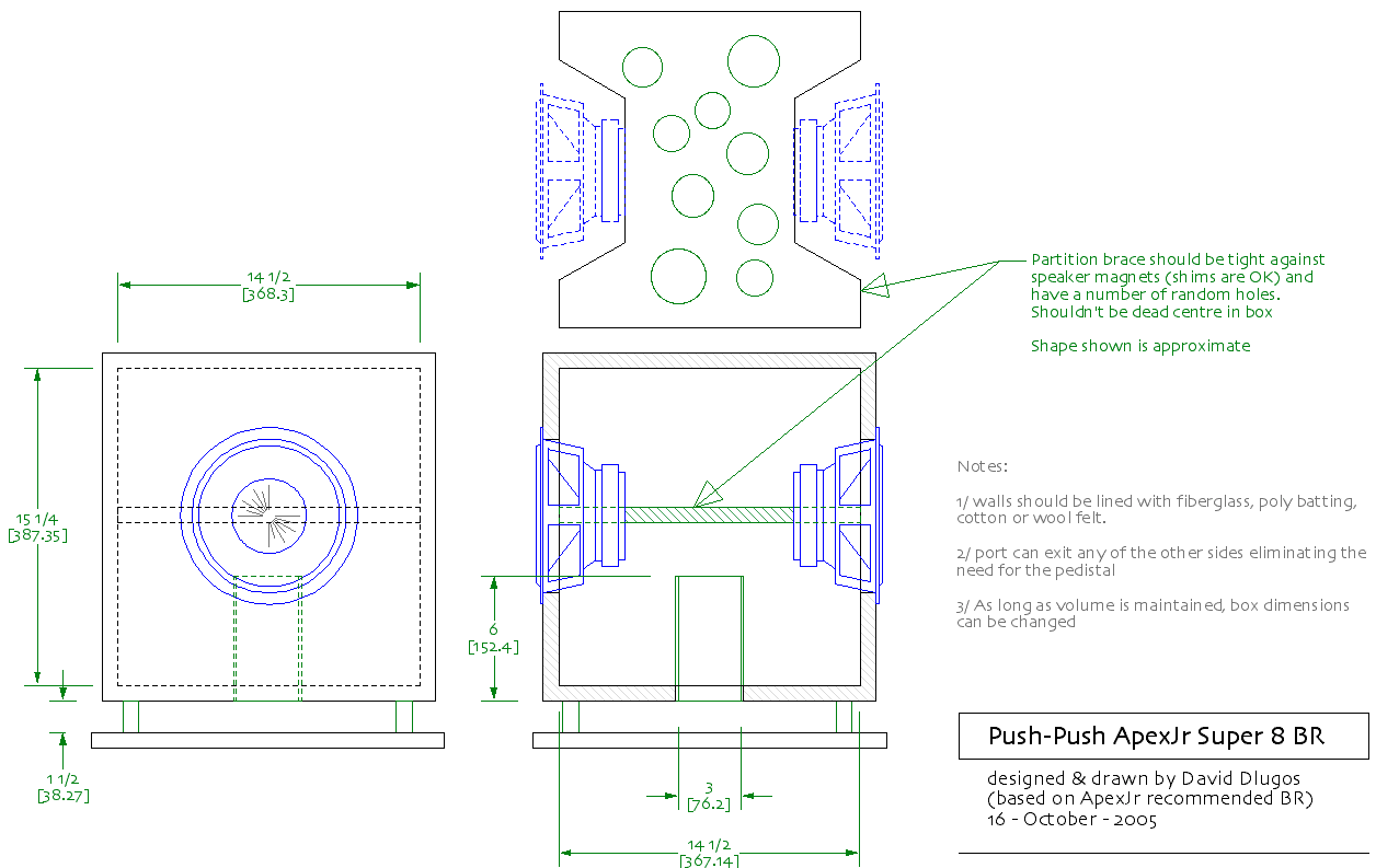

I have some 78L boxes to repurpose made of 1" BB. Maybe this could work in my drawing. I chose a random 10 inch driver for dimensions. I would need to find proper woofers for volume of 70L. The mid box will take up 6-10L.
The woofers would have magnets 2.2 inches apart.
Is the woofer configuration acceptable for push push?

I found this. Also, I see ported is not an issue. ported if my preference for the these particular boxes.
edit; just realized that is Dave's drawing🙂
I was remebering our build of that. Scott built it out of scraps (some recycled from old consoles)m painted black. A tiny little thing that was/is a really nice woofer.
Push-push means material choice was not as critical.

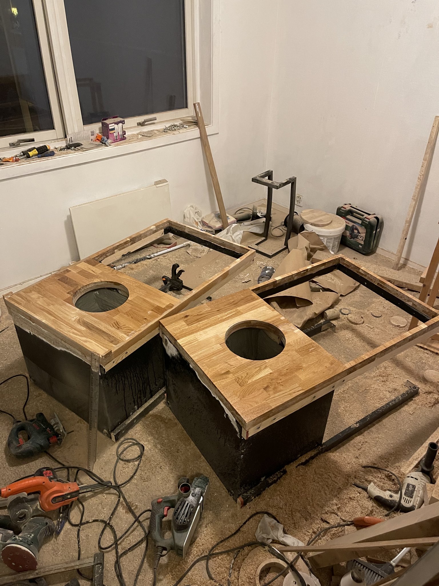

Better than bracing: plywood and silicone and plywood sandwich. For this, 1/2 inch is perfect size.
Have you done this and tested this?Better than bracing: plywood and silicone and plywood sandwich. For this, 1/2 inch is perfect size.
Silcone meaning regular silicone sealant?

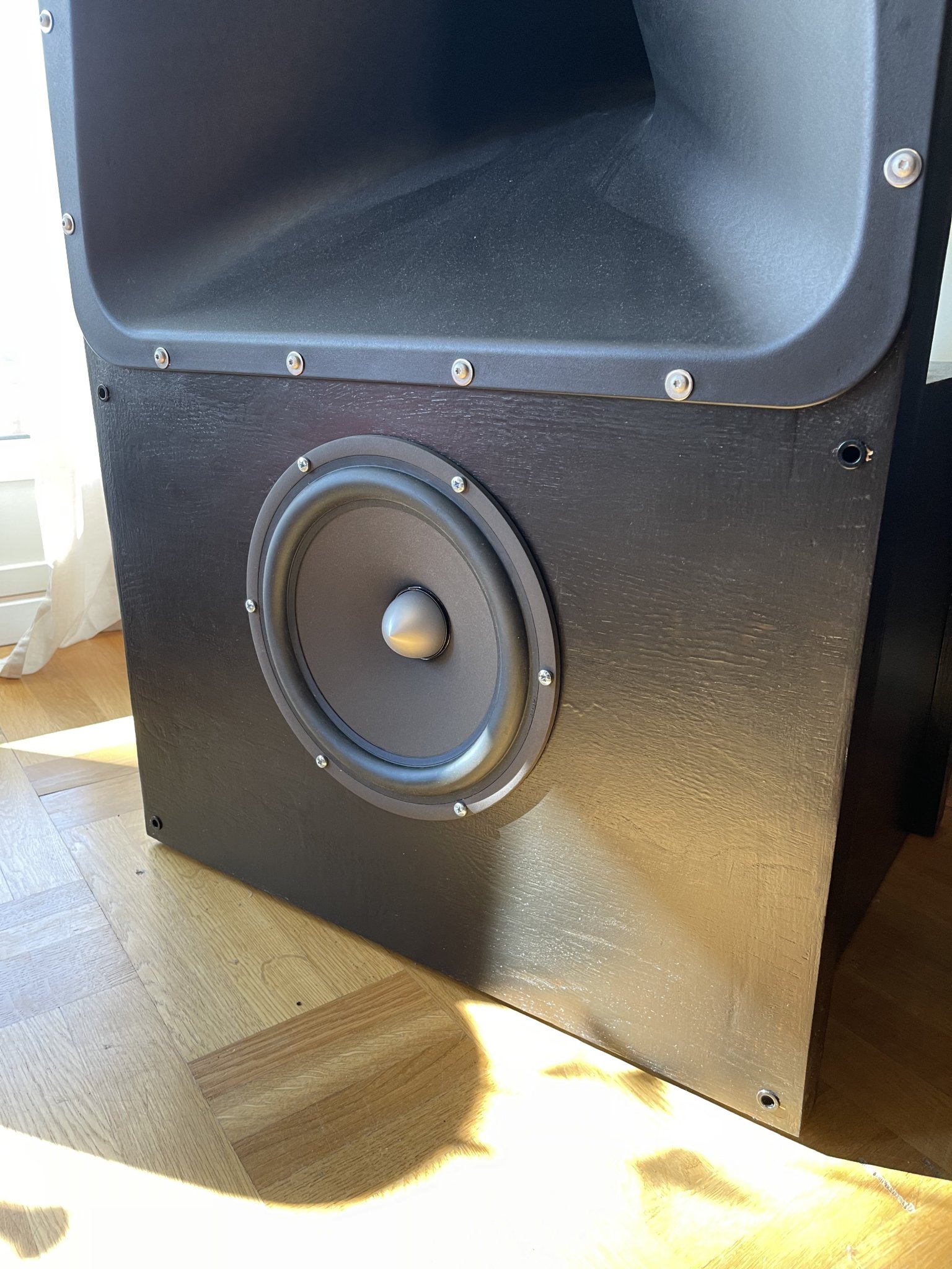

I did it on the front of my newest speaker. Two 12mm Oak sandwiched with silicon. It is so strong but dead when I tap on it. No ringing at all. No need to use oak, but it turned out to be cheaper than plywood because of covid.Have you done this and tested this?
Probably functions similar to Green Glue used in home theater soundproofing applications?Silicon in between sounds like a mess.

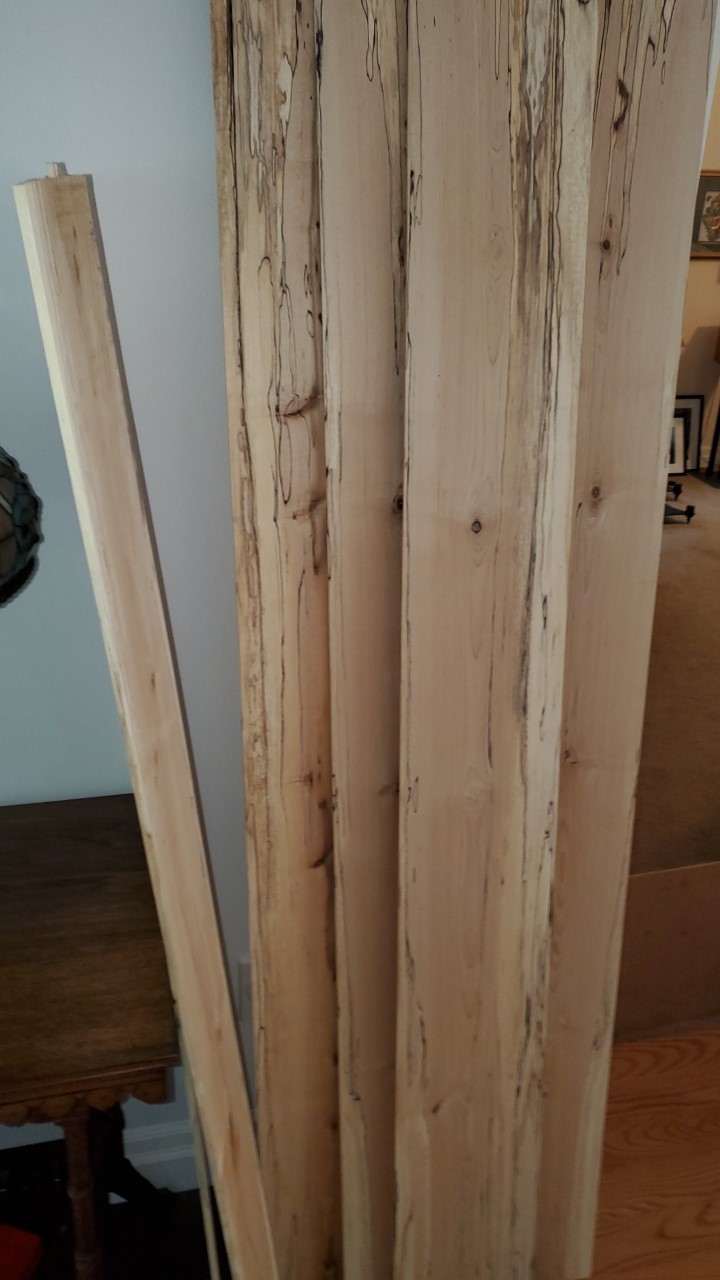

I'm going for the lowest weight as possible so I'd like to use 1/2" BB. With good bracing do you see any issues with my plan? Noise, panel resonance etc?
Frankly, I have, and would build, using 1/4" BB since it's comparable spec-wise to the marine grades I used way back when with up to 8.5 ft^3 cabs loaded with (heavy) 12 -15" AlNiCo woofers with soft wood plank/board bracing to further reduce weight. The big problem then becomes one of needing to add weight on top to keep it firmly in place if a long throw driver (never my problem) and while the horn(s) were heavy enough for my apps, will a lightweight mids/high box be enough?
No, make it some acoustic or golden ratio and brace/tie all six sides together with risers on edge offset at some acoustic or golden ratio to make an inert box to well above the driver's pass band and yes, done this way you don't need very rigid and/or heavy riser boards, though most folks will make 'window panes' assuming they will inherently be better overall.

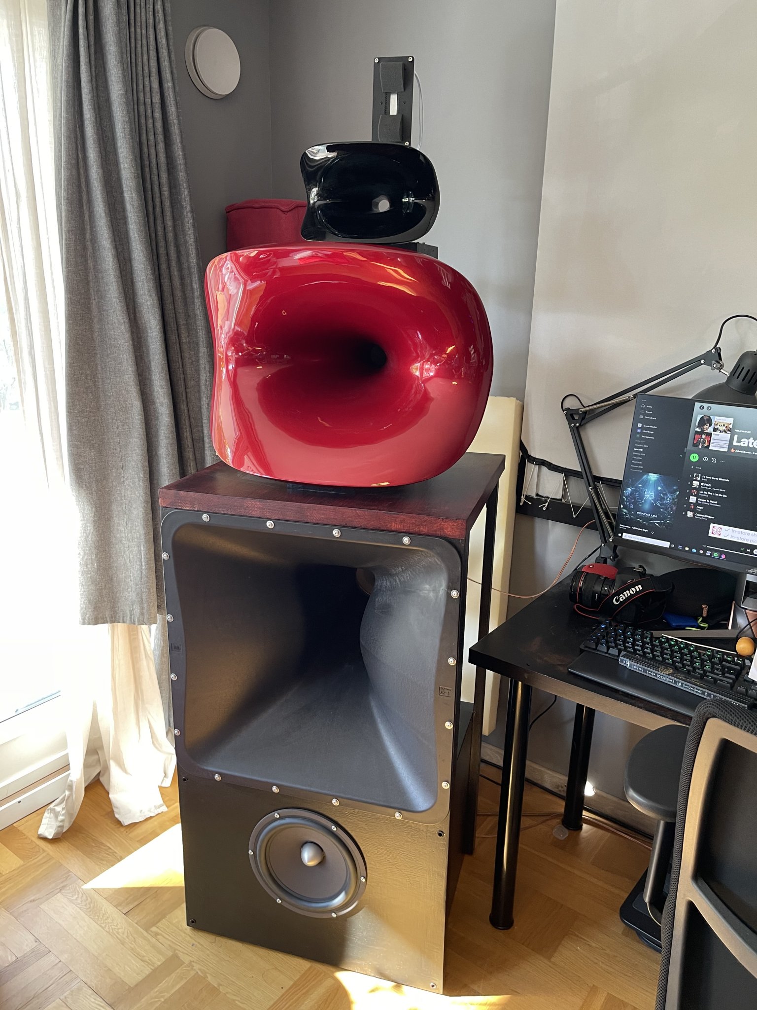

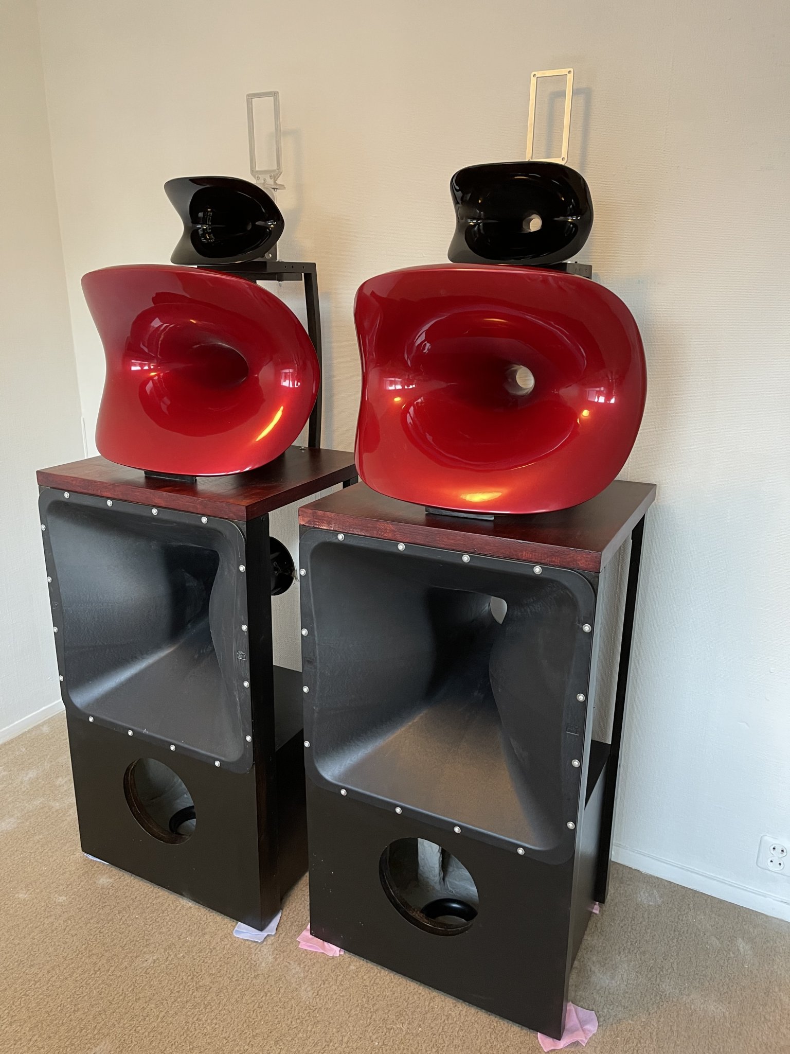

1/4" BB panels - Great idea, light weight, thanks!
1/2 or 3/4 ply window pane risers - panels glued and screwed to risers
3/4 ply horizontal mid windos pane connections front to back
12mm BB front and back panel - holds screws very well
Box has 1/8 - 1/4 spalted maple thin boards glued and pressed
Many Thanks!

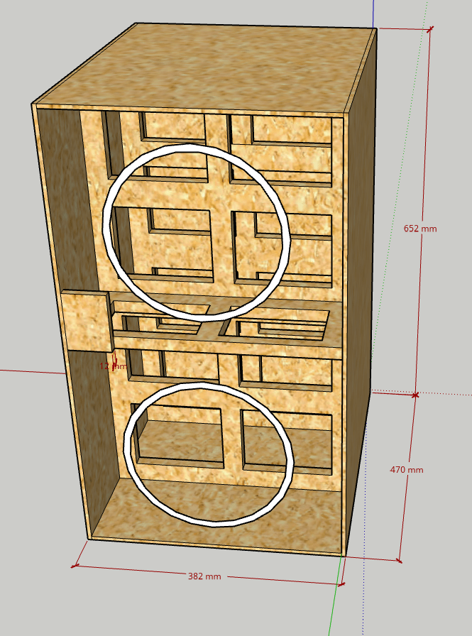

I would rotate the brace that runs just between the drivers 90° to a/ provide a better brace, b/ provides the opportunity to shar the driver reaction energy more evenly thruout all the box panels.
General bracing rule: the subpanels created by a brace should have a higher aspect ratio than the panel being braced.
dave
dave

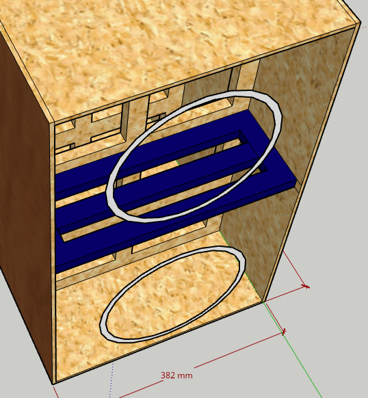

No, all bracing is along it longest axis, so viewed from above it will look like an 'X', 'cross' depending on offset with the offset predicated on both proper offset from a bracing POV and usually to brace/mass load the driver to the baffle.
Dave, please post an example of one of your bracing schemes.
You want to push (potential) resonancces up in frequency, ideally high enuff that i never gets excited.
And not in the exact centre to avoid this:
Here is a top view of what is meant.
dave
