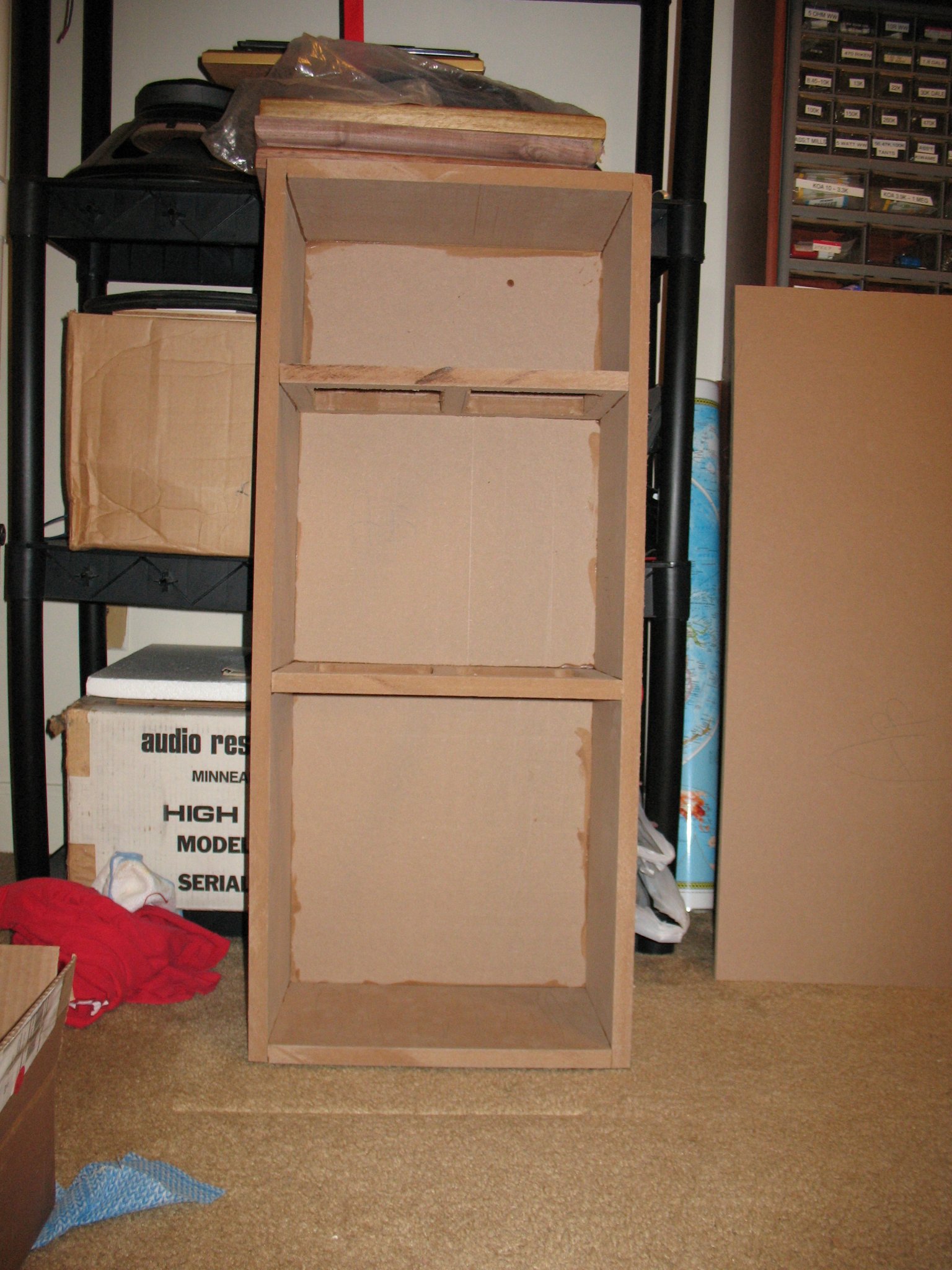

Getting there. The vertical brace, should, if possible also reach up to and support thr baffle. This, i believe would be a development of your first drawing (only the little divot for the magnet?). possible depends on how much baffle is above or below the driver.
Do note that getting the speacing “perfect” on the brace is not always the easiest task.

What Dave said plus please note this brace goes all the way to the back.Maybe better?
