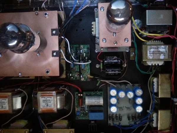

Looks like this
I use AVC at output and it's dead quiet. The filaments are a bit starved (0.230A). As you can see, Rod regs are there and Tom Cr 21thMaida reg also. Tunings are therefore easier when I'm rolling tubes. CX-301A and UX-201A require different settings (01A on picture).
Nice built Crazyfrog. Are you using Slagle AVCs?
Have you compared the sound to standard pots ?

Thanks. Yes they come from Intact audio. I tried both stepped attenuator and AVC on a 10Y line amp (LL1660 at output) but not on 01A pre. However the results were good enough to try it on the actual unit and I'm not disappointed. Full signal goes at the triode grid in that case, that must not be bad!
