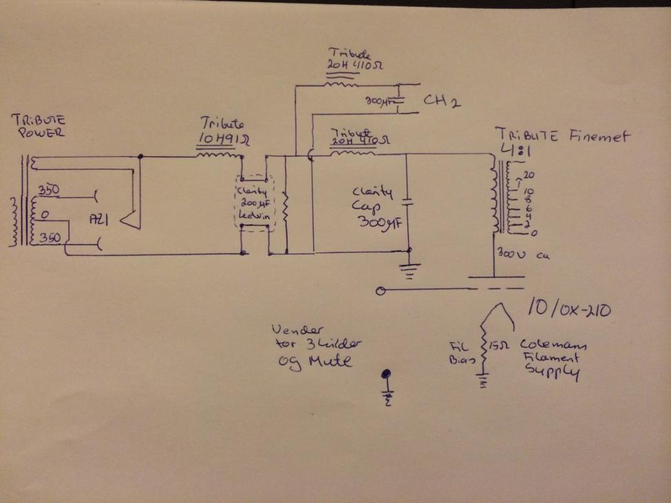

Sorry guys while we're on the AZ1 rectifier, what would the ideal Ac v out be from the transformer. Am looking into a CLC or CLCLC stage. Haven't got the chokes so don't know the resistant. Besides I've no experience with the AZ1 don't know what the voltage drop be like under load. Chokes will be 10 henries or more

My PSU for my 4P1L SE has two AZ1 mesh in parallel. It's 300v AC into a hybrid (Graetz) bridge. This gives me 265v after CLCLC. Chokes are about 100 ohms each, caps 40uF polypropylene, and the load of the amp is around 150mA. So there's quite a big drop with the AZ1s. But the current for an 01A preamp is tiny so it would be a different story. Choke input would be the way to go.

Apologies Andy why would you need a Greatz bridge when the Az1 is perform8ng Ac to Dc conversion
You use a hybrid bridge when you have a single winding like 0-300v. You can use a normal full wave rectifier if you have 300v-0-300v with a centre tap. I have two AZ1 in parallel for the positive side and a pair of UF4007 for the negative side.

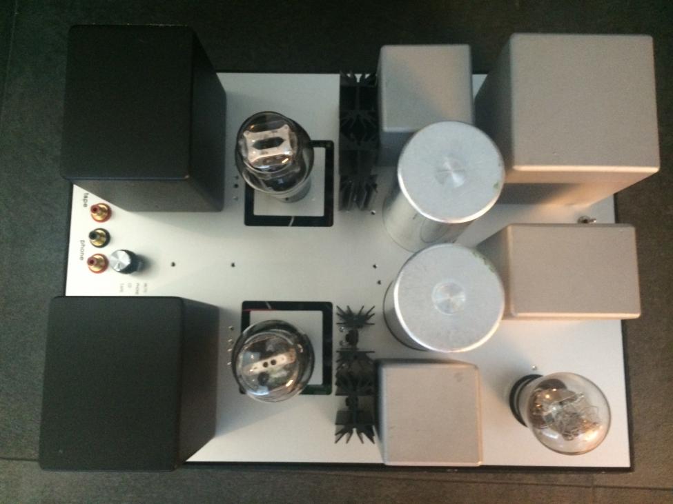

Ale brought round his preamp - the one on his blog - and we listened to it in my system. I remember his power supply was shared with his 4P1L preamp but not what was in it. He probably did have a Salas reg, but that would come after the rectifier. Use an AZ1 mesh if you want the best.
Indeed, HT is shared as have limited space and a good HT supply in the 4P1L already available. No need for a shunt regulator if the HT filtering is good as the gyrator provides a good PSR. I have a choke input LCLC using damper tubes and using film caps. I think the diagram is somewhere in my blog. Best investment is on the LT supply and in the Rod Coleman regulators in my experience.

maybe a dualmono supply like in my 10 dht pre ?
dead quiet about 110µV noise on outputs, input terminated.
-3 db at 63 khz, 10v peak out when 2vpeak in, thd at 10v peak 0,023% at 1 khz, 0,03% at 20 khz
Rods excellent filamentsupply, of course!
