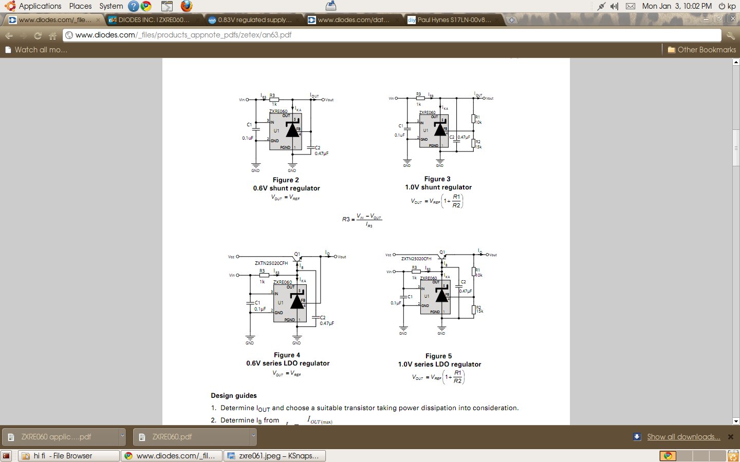

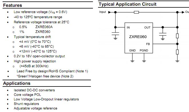

0.83V regulated supply

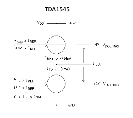

We can modeling TDA1545 with following schematic. IFS must be set to 1mA, tension at IREF pin is 0.83V.
From TDA1545 datasheet
quote:
The current IREF is proportional to VDD so the IFS and IBIAS will also be proportional to VDD (note 2) because AFS and Abias are constant.
In their schematic VREF is proportional to VDD. But, is there a good reason to keep IREF proportional to VDD since AFS(13.2) and Abias(9.42) are not equal? When IREF is proportional to VDD, any variations on VDD creates variations on Iout.
I agree the voltage at Iref input will be 0.83V. I was referring to the datasheet circuit where Vref is not the pin voltage itself. You can see that the bypass capacitor is not directly connected to the pin, there is a resistor inbetween. They will have good reason to have it that way. There are other posts in this forum suggesting to leave it as it is. As the PSRR of the TDA is very bad, I think a regulated 5V supply is mandatory anyway. One more point: the internal bias resistor has a very high tolerance. To compensate this, it should be fed with a 1.0mA current source and not with a 0.83V voltage source. That would an option to try in my opinion.
The reference current is converted into a voltage by the external opamps. This means the reference current sets the overall gain of the DAC, not only the offset. AC decoupling capacitors at the outputs are mandatory anyway in this design, so offset is not of that much importance. Just make sure the opamps do not leave their input/output specs.
To achieve good sonic performance, I would pay more attention to the opamps at the outputs. As they are operated as current-to-voltage converters, stability issues can easily occur.

I disagree at this point. The reference current flowing into Iref pin sets gain, biases, etc. This current is the voltage at the pin divided by the internal resistor value. When any of the two change, then everything changes. By adding an external (precise) resistor in series, they actually reduce the effective tolerance, because then Iref = Vref / (Rref + 33k). With Rref = 7.4 ~ 14.6k (corresponding to +-33%), you get Iref = 70 ~ 82uA. This gives a tolerance of +-7.9%. Otherwise nobody would be able to reach the target spec of Isw= 1.0mA +-10%. For that reason I suggested using a precise (and of course low noise) current source for this pin. This will achieve precise gain and offsets. However it is not easy to create a current source that has similar noise performance as a resistor (maybe another reason for their choice in the datasheet).

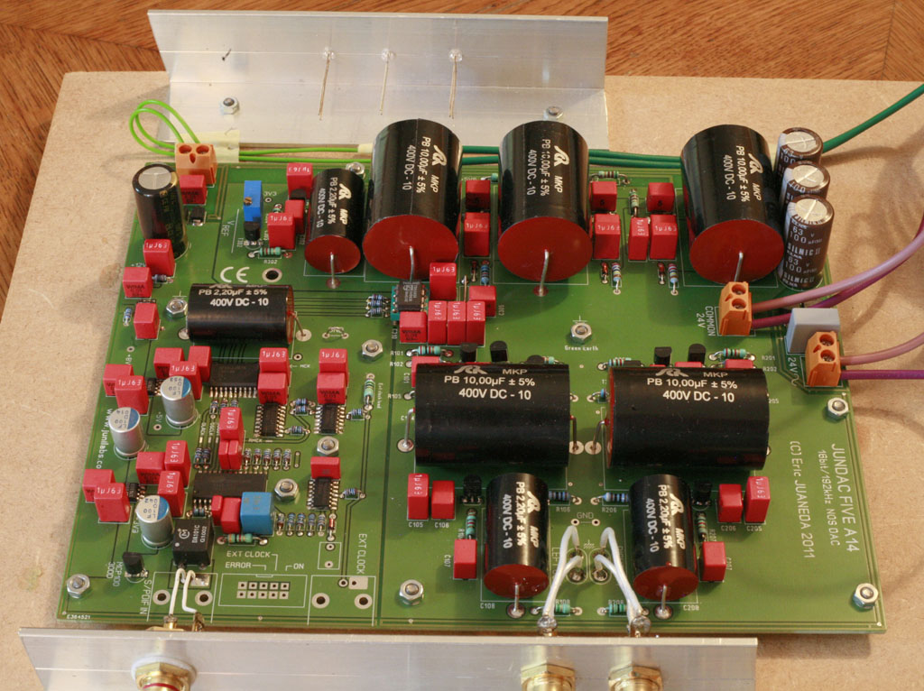

TDA1545A, direct driving Iref pin
I'm testing my prototype of Jundac Five DAC using TDA1545. I think that the TDA1545 is able to very good audio rendering. For this kit, I set a fine environment with large power supplies using big MKP capacitors...
IREF configuration
Step 1
I try for various configurations for IREF pin. I start with datasheet recommendations. I reach the well known sound coming from TDA154: very sweet, not very detailed and (too) much rounded bass.
Step 2
The second step was to put a 10nF Wima FKP2 polypropylene film capacitor directly on the IREF pin. This improve sound rendering by adding more details and bass realism.
Step 3
The third step was to try various values for R2 and R3 and reducing serial resistor value of the IREF pin. This step improves sound rendering too.
Step 4
For this last step, I drive IREF pin by personal reference tension with very low impedance. With this configuration, I reach the real sound of TDA1545. Nothing matter with original one! In this configuration, TDA1545 keep a sweet tonal balance, natural and detailed sound and punchy bass.
Technical details
- I supply the TDA1545 with +5V6.
- Reference tension drives IREF pin by voltage with very low output impedance.
- Even in this configuration, there is a lot of disparity between various TDA1545A. Reference tension must include a pot to adjust output voltage.
- Since step 1 to step 4, I was totally out of Datasheet specs. Sometime under, sometime other!
- TDA1545 outputs +/-1.5mA. It is able to output more before clipping.
Conclusion
The global sound rendering of TDA1545A depends on how you drive the IREF pin. Driving IREF with voltage reference with very low output impedance greatly improve listening results. The datasheet is not very clear; the TDA1545A is able to better specs. With optimum configuration, TDA1545 is a great DAC chip.
