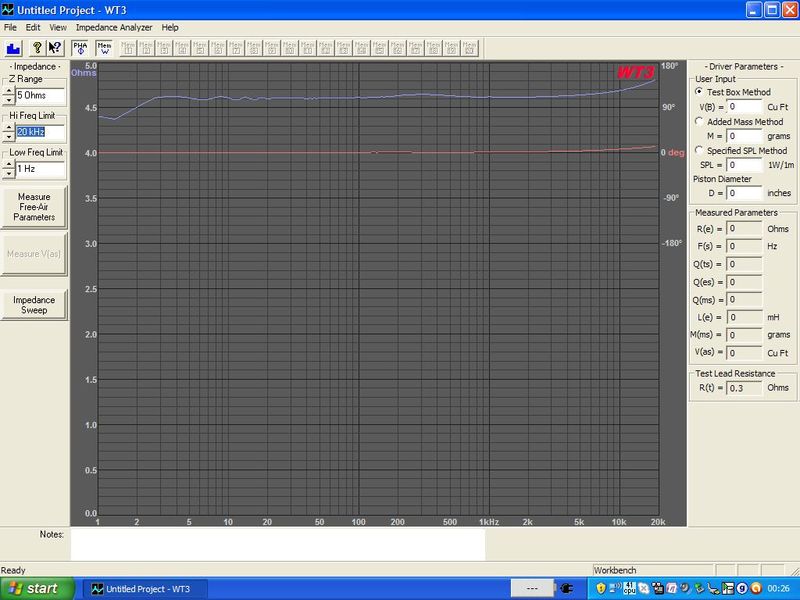

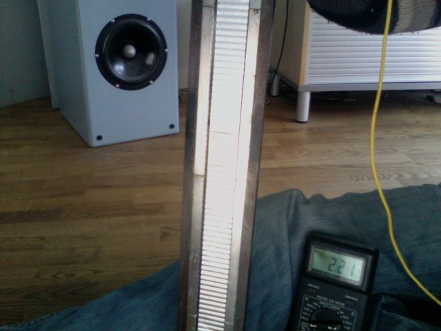

Are you saying you have 2.2 ohms with a straight single traced ribbon ...?
Yes 🙂
This is a planar version playing. 150cm long 1,7 cm wide and with nano iron in the clue. So the ribbon is magnetic.This is 4 ohm

ABJ, i would need more info, hard to understand how a straight piece of foil has an imp of 2 ohm ?
The aluminium just have to be thin. I am using imitated leaf silver on a roll (aluminiun).

Did you use Washi paper? I think it goes down to 2.5 microns, but the sheets are small. Also how did you managed to corrugate it? All my attempts ended in
crumpled pile followed by swearing.😡

I use capacitor paper from a now closed capacitor factory.
No problem too corrugate when sandwiched with paper.
It is very strong ribbon. the planar ribbon in the youtube clip
is crossovered at 200hz. Ok very step digital filter.The 1meter
true ribbon is crossed at 1000hz 12db
