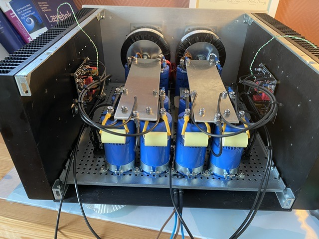

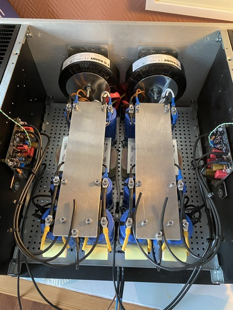

I once had hum with a stock PSU.
So I built my own :devily:
Approx 800.000uF in total, and 4x10mH inductors with a DCR of 0R160. Cannot measure any ripple at all at the rails, but maybe a scope will show something. Needless to say: complete overkill.
PS: beware: I would be more hesitant of increasing filter resistance in P/P circuits than an SE one, especially if there is a Papa CCS present. My audiophoolery tendencies makes me worry about PSU sag in P/P circuits if R is too high. But I guess that is more of a problem with class A/B circuits anyways.

My set up is : I have placed the transformer, bridge rectifier and smoothing caps into an abs enclosure, a metre away, as i noticed from previous projects the transformer can throw out emi radiation which lowers the amp's performance, sounds a little cleaner and more detailed without the big transformer being in the same enclosure as the amp boards.
I have 5 amp boards to build a 5-channel amp. In the abs enclosure a meter away, after the smoothing caps i have placed the 0.12 ohm resistor. If i place a final smoothing cap across the power supply of each amp board, will this form the crc filter, or does each amp board need its own resistor?

I would recommend you first place an extra set of smoothing caps after the filter resistors in the external PSU enclosure. Filtered, and then charged, before leaving the extrrnal PSU.
Then, in the amp enclosure, put in a set of high value low ESR caps to filter out whatever noise has been picked up between the external PSU and the amp enclosure, and also ensure easily available current close to the amp boards.
You probably know this, but carefully plan the grounding of this setup.
For inspiration, check out the XS series from Pass labs :santa:
If you split crc filter , and put second capacitors at amplifier board , then wires from first capacitors would be in series with resistors. So its better to place resistors just before amplifier board , they will filter additionally what is picked up by long wires . Additional capacitors may be good idea ,but proper way of connecting them is important. Probably star connection for ground. Also you should use twisted wires for power , they would not pickup anything then.
