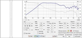

After a long time as a spectator, I'm starting a line source project. The driver parameters measured in REW are the following:
They are Sony almost oval TV drivers and measures approximately 105mm x 50mm or 4 1/8” x 2”. With the parameters, I defined a volume of 2 liters per driver because increasing the volume has little impact on the response. As illustrated in the above image, the active area of the speaker measures 82mm x 39mm.
In VituixCAD, should I simulate it as a circular driver with Dd=82mm (largest vertical dimension) or as a rectangular driver with Height=82mm and Width=39mm?

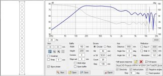

I continued simulating as rectangular drivers.
With 20 of them arranged vertically in a line, with 106mm c-t-c because of the edges, without equalization, filters or power shading, the resulting graphics were these:
To reduce the c-t-c distances to the same dimension as the vertical length of the cone (82mm), I arranged 25 drivers alternately. The SPL graph improved and the vertical directivity graph was surprising:
From the graphs, the offset configuration presents the best preliminary results. I didn't expect that. Has anyone ever tested something like this? What are the pros and cons?

Very interesting - I have pondered an horizontal offset myself for a build with a bit larger driver - say 4-5" (round) but never did a simulation. We could say that this is a quite a substantial improvement - I wonder what @wesayso would say? 😉
In the sims, you just decreased the c-t-c, but haven't taken into account the offset of the c-t-c (and I'm not familiar enough with the apps to try and simulate that, if even possible). So, of course, we see a lot less comb filtering at 82mm, instead of 106mm.
Also, wouldn't the c-t-c be the diagonal between the drivers?

Judging by the pics, it looks like OP did factor in the offset? I'm not too savvy with VCAD though, so I might be mistakenIn the sims, you just decreased the c-t-c, but haven't taken into account the offset of the c-t-c
Good observation @perceval , but there is a layout tool in VituixCAD to define driver positions. The distance was 80 mm so I corrected it to 82 mm, as I mentioned, and the result is still very good.
View attachment 1327422View attachment 1327415 View attachment 1327405
View attachment 1327423View attachment 1327414 View attachment 1327407
Interesting results for the vertical directivity! 🙂 I was wondering about the horizontal results, but that doesn't look all that great?
Usually, the horizontal is pretty close to the directivity graph of a single driver (for a single row of drivers in an array). So I can't quite follow what's happening here?
The vertical directivity looks great in comparison. If I find the time I'll run some sims with the TC9 out of curiosity.
It makes sense, but in the layout tool the "C-C dist" field only refers to the vertical distance between the drivers and the "X mid" field, which I called offset, only refers to the horizontal position.Also, wouldn't the c-t-c be the diagonal between the drivers?
