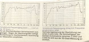

In the new issue of the German magazine Hobby Hifi (2-3/2023), mr Bernd Timmermanns offered an update to his Jericho horn, this time using the Dayton PS220-8 fullranger.
The measurements are promising. You can also see the effect of the correction filter. It looks like an interesting project.
The magazine has a 14 page detailed article including a step by step construction guide.

I have tried to model it in Hornresp, I used the wizard and set is a tapped horn with the driver between section 1 and 2. I wanted to slide the driver 14 cm into the horn but I can not get the sliders up. Perhaps I have to make it a "horn" instead of a "tapped horn".
The horn start at 135 cm2 and ends at 2000 cm2 with a lenght of 250 cm the driver is 14 cm from start of the horn. The HelmHolz resonator is 2.4 L and has a 5 cm opening 1.9 cm long.
The first section of the horn is 56 cm long and the final opening to the next section is 203 cm2
With the driver at the intersection of L12 56 cm and L23 194 cm there is s deep null 200 Hz. I will have to RTFM again.
