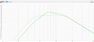

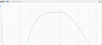

Subpart 1 - circular ports - WinISD
There are four D=101mm circular ports going from the rear chamber.
I modelled the port length and rear chamber tuning frequency in WinISD.
Circular ports
Setup
Tuning freq: 35Hz
Ports: 4x circular L=31.7cm D=10.1cm

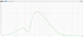

WinISD results - transfer function magnitude, SPL, cone excursion

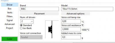

General setup
Drivers: 2 parallel
Rear chamber volume: 197 Liters
Filters:
LP, Butterworth, n=4, cutoff=140Hz
HP, Butterworth, n=4, cutoff=40Hz

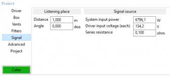

System input power: 6.8kW (134.2V each driver)
WinISD settings

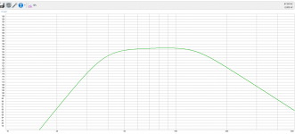

Subpart 2 - square ports - WinISD
Additionally there are six fixed length square ports. Horn coupling at the square port output is neglected for simplification.
Square ports
Setup
Tuning freq: 63.9Hz (can't go lower, length mods not possible)
Ports: 6x square L=15.2cm, 16.4cm x 6.5cm
All ports transfer function magnitude and SPL
Square ports
Setup

1) The BC18SW115 has an Xvar of 16mm, which would be a "safe" excursion, and usable in simulation.
It's Xlim is 30mm, 60 mm peak-to-peak excursion before damage.
2) Each BC18SW115 will withstand peaks of 6800 watts, but long term power handling in a cabinet of this sort should probably be limited to around half the AES rating of 1700 watts.
3) As far as I know, other than using an aggregate sum of port length and area, no. This design also has the interesting feature of two different port offset distance in relation to the horn mouth.
4) Your Hornresp sim would be more valid using two offset drivers with a ported rear chamber. The cross-sectional areas of both sides of the throat chamber and horn at various points of the horn path should be combined.

Although you can determine the back chamber volume fairly easily from dimensions, it is impossible to "average" the length or area of ports that are so different in cross sectional area and shape .Do you have an idea what the Lpt parameter should be set to? Average length of all ports? All ports length sum? The longest/shortest port length?
I'd suggest using a Lpt that results in an Fb (Frequency of Box tuning) around 40 Hz, based on Void's suggestion of a 38 Hz Hi Pass 24 dB/octave crossover point, though you could vary the Fb down to 28Hz to compare response.
The impedance and excursion minima will be at the Fb.

I chose Lpt=50cm which gave me Fb=40.1Hz. Can't go lower because I don't want longer circular ports.
This is what I got without any filters
I also tried to model the sub with 250L rear chamber which slightly flattened the response and "moved" the peak at 49.6Hz@145.8dB to 44.9Hz@143.4dB.
Maybe some sort of rear chamber lining could improve the response. I know this sim is far from perfect so I will try to sim it in Akabak. Prototype of the sub with adjustable circular ports will be complete soon so I will post some measurements later.

The "horn loaded" ports are ignored in your model, and they are a lot longer than the circular ports in the Void Stasys X-Air design.
Simulating over Xmax/Xvar (16mm) won't translate to reality, as a power increase past Xvar won't linearly increase excursion.
