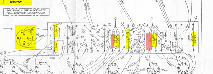

I got my son a re-capping kit for Christmas, and we attempted to install it yesterday.
Good news, it now makes sound, bad news it sounds like crap.
Here's a video of a Fender Rhodes being played through it
1975 princeton reverb - YouTube
Interestingly the re-cap kit came with 6 25/25 caps. but the amp itself only had 4
The missing caps are highlighted in red.
I don't think the amp ever had work done on it before from the looks of it.
Could it have been like this from the factory? (am I using the wrong schematics? AA1164 and/or B1270)
Is there any harm in adding the missing caps?
Again, any advice is appreciated
Regarding the missing caps, I'm not sure about the Princeton Reverb specifically, but I know some old Fender models didn't have cathode bypass caps but then got them in later revisions. Regardless, I'd hold off on adding them until you have it otherwise sounding good — the missing caps, if they do make sense in this amp (and if I'm matching the schematic to the layout correctly), will make the reverb louder and the tremolo stronger.
Looking at your measured voltages, it seems a lot of them are pretty low, and that might be why you're getting distortion. You seem to be measuring low voltages after the 1k and 18k 1W voltage-dropping resistors on the left in the diagram. Those may have drifted out of spec over time. You might try measuring their resistance.
