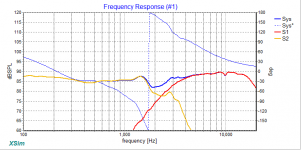

I modeled the XO in Xsim, using a DC160-4 woofer, a CAT 378 tweeter (i.e. the parts being considered by the OP) and the parts values provided in the diagram.
I think the electrical XO point is about 1000Hz, which doesn't sound right - perhaps too low for the tweeter?
There's no Baffle Step Compensation, but perhaps the passive radiators take care of that - I don't know anything about how they work, I'm sorry.
I've tried to attach the Xsim shots, my apologies if that doesn't work properly. Please note that the sim is not measured, it just uses the 'official' driver graphs provided by the makers. The red is the combined response, the black is the tweeter and the brown is the DC160. Even allowing for the effects of in-situ measurement etc, I think the Polk must have used a much more efficient woofer!
This doesn't particularly mean much, except that a new crossover will be required if different drivers are used.

Yes indeed, that looks much better! I just simmed the way it was drawn, I should have thought it through more.
Electrical XO is about 2200 Hz, sim looks more realistic now. But it's only a sim, not measured and doesn't take the quality and sound of the drivers into account .
At least in the sim, the DC160 woofer has a nasty looking bump at about 2900 Hz which may be audible. Paul Carmody's Classix designs deal with that issue brilliantly.
Still not enough Baffle Step Compensation, but please see above comments on passive radiators.
