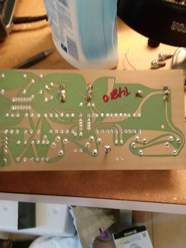

I have a Gallien-Krueger rb200 bass head with a blown power amp section -- the preamp section still works using the effects send.
Could anyone comment on a feasible way to use this preamp with another power amp? Pop another power amp into the chassis?
I really liked the sound of this amp compared to more modern solid-state amps and I'm pretty sore that I was unable to fix it. It was $40 so any rat-rod suggestions welcome. I believe it just needs 12v to the preamp board and send the signal out. Am I wrong?

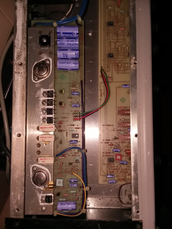

It´s very repairable, no weird components, the schematic is available, I don´t see a black carbonized hole in the PCB ... have it repaired.
EDIT: problem is you don´t have much free space there,those heads are *compact.
Preamp will stay the same.
Power transformer? ... same thing.
Power supply shares same board with power amp, half of it must stay as supply: the heatsink mounted bridge + the 4 blue filter caps plus I presume (labels are unreadable) two of four TO220 packages in center of hear sink might be 15V regulators... at least supply wires to preamp leave board in that area.
Point being you don´t save too much space by sawing that PCB and heatsink in half and ditching the power amp.
Plan B: you MIGHT remove power transformer and full supply + poweramp PCB + heatsink, install there (if it fits) an ICEPOWER module which is both Power amp and SMPS Power supply AND has auxiliary +/-25V outputs, easily downregulated to +/-15V for preamp, but it involves some brain surgery.
If skilled to do that, you might even repair the current power amp yourself, both require some experience.

I just replaced the seven output transistors, and two resistors on the bias circuit (I think) started smokin'. I think I'm done working on it, and it's certainly not worth bench time money. Some guy wanted $60 to diagnose it. Would rather get more power and keep the preamp for the same $$.

Depending on your commitment level but you MIGHT keep just the power transformer, build a new power supply on a small PCB, it might fit in as little as 6x10cm or so; just copy the original one, no need to rediscover the wheel, even use/recycle original components (2 filter caps, 1 diode bridge, 2 regulators and a few cheap caps and resistors), which will feed everything as before but save a lot of space.
problem being that current PSU is on power amp PCB spread over half of it.
Or study it carefully, maybe you can fuel up your chainsaw and cut it in half, who knows?
That way you can easily mount a generic unknown brand EBay Class D amplifier which will cost peanuts, fed from original supply.

Ouch!!! I found it and it was stingier than I remember 🙂
Power supply rails are hairy (for a 100W amplifier that is) +/- 60V , and load is 8 ohms.
Not a big deal, but it means you will need a 250 to 350W rated Class D module, simply for it to handle at least +/- 65/70V rails, just to have a safety margin.
Or go back to the original plans, fully remove transformer and power supply/amplifier board (and heat sink) and feed the preamp from IcePower auxiliary +/-25V supply
Amplifier will become a fire breathing dragon because now it will have the full IcePower board power. I would add a cooling fan if going for >250W
Or gut it, leave only preamp, add a small +/-15V supply for it, and feed an external amplifier.
An old trusty Rack amplifier, say a Peavey CS800 will be almost indestructible, very reasonable price, and provide Stadium levels of Bass sound,only problem being weight.
You might even drive 2 8x10" "fridges" if you wish 🙂

Sadly you need symmetrical +15V and -15V rails; wall wart can supply only one.
But getting them from higher voltage main amp rails is EASY and cheap.
When/if you decide which amp and supply you will use, either a plain amp with original +/-60V supply (which would be cheapest/easiest) or an all-in-one amp + SMPS supply, post it here and I´ll give you thye values. It´s only 2 resistors, 2 Zeners and 2 100x16V caps. Easy Peasy.
Remember power amp must stand +/-60V rails.
Forget "power rating" (which may be advertised as 200 or 300W), real power output will be whatever the supply can feed, so same as before.
Although not specifically indicated in that schematic, power transformer has only one secondary: 42+42VAC , so only symmetrical voltage you can get is 60+60V DC.
You *might* ground center tap and "full wave" rectify secondary (2 diodes) for a single +60V supply, but then you would need to use a capacitor out single supply amplifier ... and you would be missing negative voltages to feed preamp.
In general, with this kind of mods/recycling it´s safest/easiest to try to maintain basic original structure, if at all possible.
The least unknown variables, the better.
Well I got a peavey SS head for free -- can't find schematics online -- a "300 Series Monitor" from the 90s.

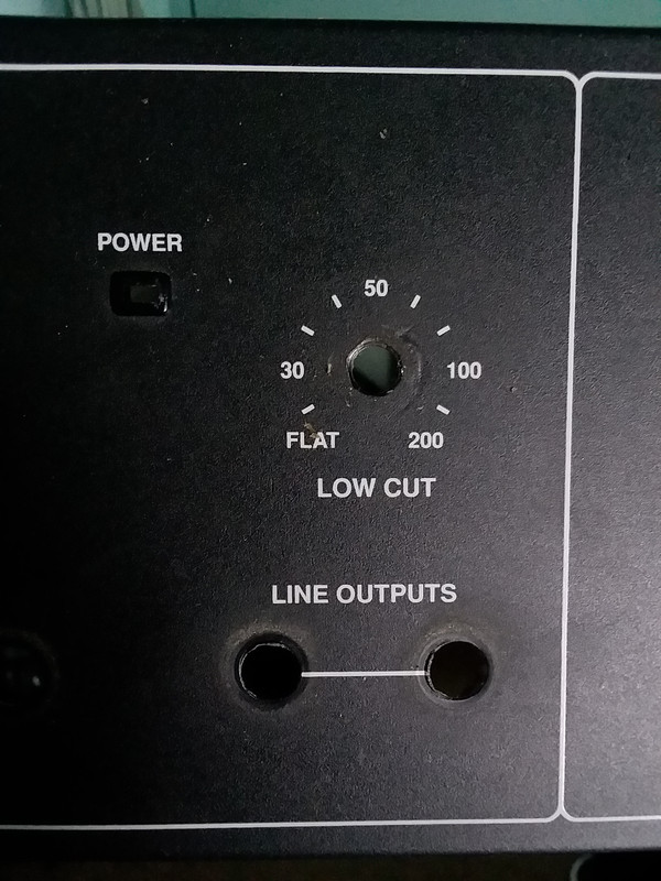

It looks like it fell on the "Low cut" potentiometer and broke off the shaft. It is a six-pin pot. I got in there to take it out and tried to jump this circuit, but when I do, the signal plays through well for 30 seconds or so, then starts to crackle and distort and fades out. Did this on several attempts.
The amp worked fine before I got in there

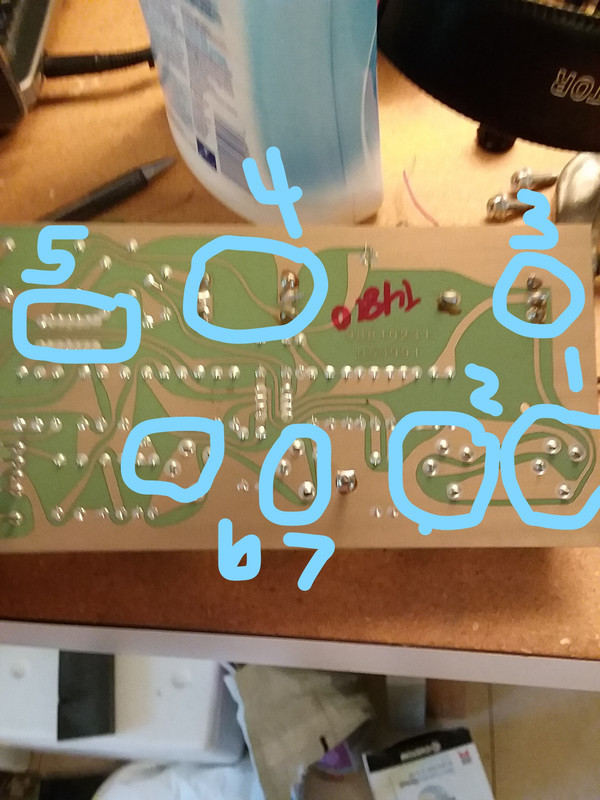

1. and 2. Line in jacks
3. Volume pot
4. The low-cut pot in question (six leads)
5. Transistor, I guess for the low cut
6. and 7. line out jacks
You got a killer sounding,VERY SOLID power amp,with an EQ thrown in for free, congratulations.
Wait untilEnzo chimes in, he´s the go-to man for Peavey stuff (and any other MI gear of course), but I guess he´ll recommend *phoning* Peavey, the best "let´s take care of our customers" company in the world.
Hee´ll suggest a direct phone line.
They will not only send you the original schematic (which I pray you share here afterwards, to help others) but also sell you the pot, if still in stock.
If not, you can mount there a regular stereo pot , same values, but rotated 180 degrees so pins do NOT face PCB (which it won´t match anyway) and use short wires to join pins and matching holes.
Hope no tracks or pads were damaged by the impact, which is also re pairable, of course.
Pity you show *everything but* the damaged pot 🙄Please do.
Absolute worst case you jump the Bass Low cut circuit and even the EQ and go straight to the power amp, but guess that won´t be needed.
