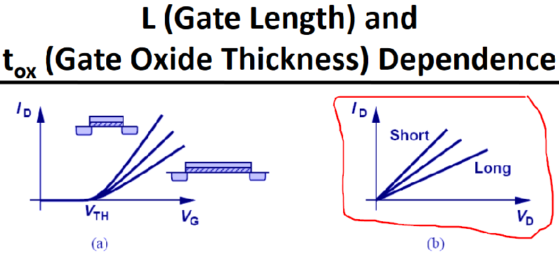

Thank you. I was confused because in the lecture16.pdf page 9 it said :
"Small gate length and oxide thickness yield low channel resistance, which will increase the drain current."
And page 24 added :
"For long L, the channel‐length modulation effect is less than that of short L."
At first, I tough to just use the "current" slope to determine, the effect of channel length modulation.
I thought, the higher the current for a vds, the lower the gate length, the lower the effect of the modulation.
But it's not reliable because the oxide thickness also affect the "current slope".
I know I may ask too much but can someone demonstrate the real world equation examples.
On how to find channel length modulation between 2 different mosfets, so I can can do it again after.
Because I am lost. Sorry.

In your case (gyrator application), you do not need to delve into the gory details: what interests you is the output conductance, which is mainly dependent on lambda, which in turn depends on the geometry, etc, but basically you have two sources of information: the datasheet and the spice model.
Neither is always very complete or reliable regarding this information, because it does not matter a lot for switching applications.
In the DS, you simply have to look for the horizontality of the flat part of the Id/Vds characteristic:
For this IRF540 example, the 4.5V curve looks perfectly horizontal, and that's one of the problems: the resolution provided by a normal graph is very crude compared to what you need to estimate kiloohms or tens of kiloohms.
With a spice sim, you can zoom in and evaluate tiny slopes, but the reliability is, let's say moderate...
The only reliable solution is to measure the PSRR yourself, after a first crude preselection based on the data available.
Note that measurements made on a type of MOS made by one brand are generally not going to be applicable to other brands, because this parameter is not essential for the applications of these devices
