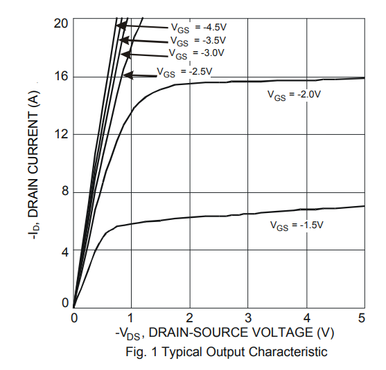

IF the datasheet happens to include curves of Ids versus Vds, you can extract the output conductance gds
gds = dIds / dVds
since it's the slope of the curve. Then write down your equation using channel length modulation and isolate gds on the right hand side. Plug in the numerical value of gds from the datasheet, and solve this equation for channel length modulation. Done!
Here are two P-channel MOSFET graphs from two datasheets. Notice the sneaky way they denote negative voltages and negative currents.

Thank you guys. Yes I found out it's not explicitly in datasheets.
And some datasheets have completely flat curves at the saturation region (which seems they do not want you to determine 1/lambda).
Mark, when you talk about the slope, do you talk about the slope in the triode region (the initial slope) or the slope of the saturation region ?

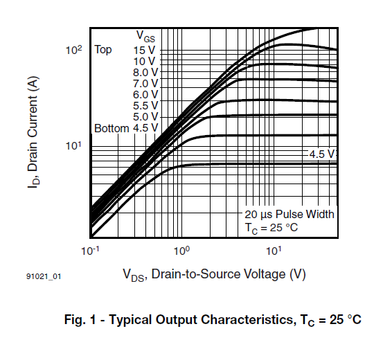

In your case (gyrator application), you do not need to delve into the gory details: what interests you is the output conductance, which is mainly dependent on lambda, which in turn depends on the geometry, etc, but basically you have two sources of information: the datasheet and the spice model.
Neither is always very complete or reliable regarding this information, because it does not matter a lot for switching applications.
In the DS, you simply have to look for the horizontality of the flat part of the Id/Vds characteristic:
For this IRF540 example, the 4.5V curve looks perfectly horizontal, and that's one of the problems: the resolution provided by a normal graph is very crude compared to what you need to estimate kiloohms or tens of kiloohms.
With a spice sim, you can zoom in and evaluate tiny slopes, but the reliability is, let's say moderate...
The only reliable solution is to measure the PSRR yourself, after a first crude preselection based on the data available.
Note that measurements made on a type of MOS made by one brand are generally not going to be applicable to other brands, because this parameter is not essential for the applications of these devices
