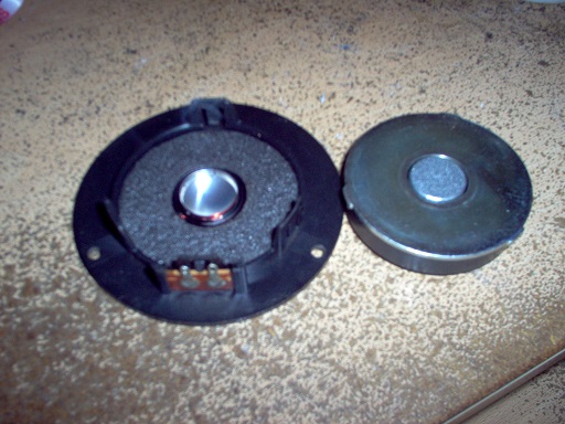

I've used that tweet. It is cheap, cheerful and most definitely sealed.
Just as well SEAS don't make deep-sea diving suits, then. My own tweeter below. Like the man say, it's held together by three plastic clips. 😀
This is what drives newbies to DIY Audio crazy.....can't even get simple agreement on the facts....as Lozjek says the tweeter is already sealed...what in G-ds name are you on about System7 that you can't even acknowledge the simple facts......next thing you know we'll have some well meaning but naive newbies running around re-posting that this tweeter is an example of an unsealed tweeter.
Except that I am right exactly about the facts. The cheapie SEAS 19TFF is a typically cheap and leaky tweeter design:
H0737-08 19TFF 1
I don't know if Sonus Faber have specifiied long tinsel leads to SEAS, for the benefits of low frequency extension. But clearly wasted on YOU. 😀
Sometimes, you just gotta acknowledge the FACTS. 😎
H0737-08 19TFF 1

There's the rub IMO. The terms open-tweeter, sealed tweeter and leaky tweeter are not, in my mind, synonymous terms. Anyways gentlemen...continue
