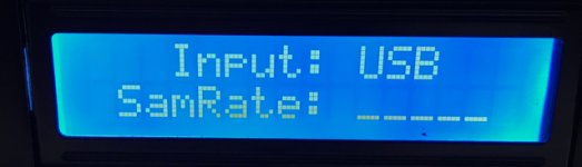

I finally returned to this project after receiving a new Amanero USB to I2S board. I’ve fitted it in accordance with the AK4497 DAC dual-chip decoder board pinouts as shown below:
as can be seen in this photo:
Still no output from the AK4497 board. The display shows:
I used my Oscilloscope to look at the outputs of the USB card while playing music. DSD.ON is zero volts. Here are the rest:

While the optical input works fine I really would like to have the USB input working.
Androa76 said the seller of the board specified “XMOS or upgraded version USB to I2S” (the ad on AliExpress is no longer available) but every XMOS board I can find for sale has the same pinout as the Amanero board that I have.
Does anyone have any suggestions please?
Thanks, Dave.
Hi if i see correctly it is that board for your dac and pins are
DATA, BLCK, LRCK,MLCK,DSD,GND.....you have DSD, DATA,BLCK,LRCK,MCLK,GND try my connection.
Thanks. I tried your connection originally. That's the direct connection of the USB/I2S card holes to the DAC board holes directly underneath them. It didn't work which is what started me off on this debugging process.
And yellow board has one pin in centre that may also must be connected ...
ak4118 doesn*t have i2s input so maybe need that coax signal to turn the multiplexer switch on and send sampling rate to ak4118 who shows on display sampling rate.
