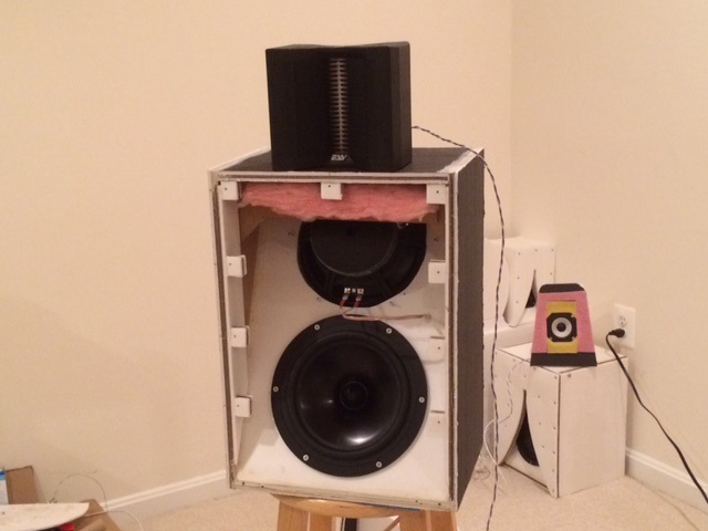

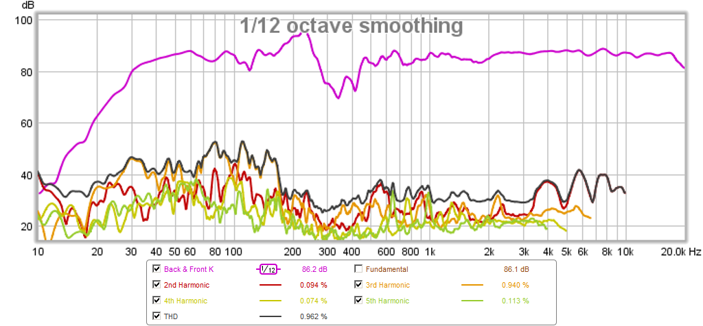

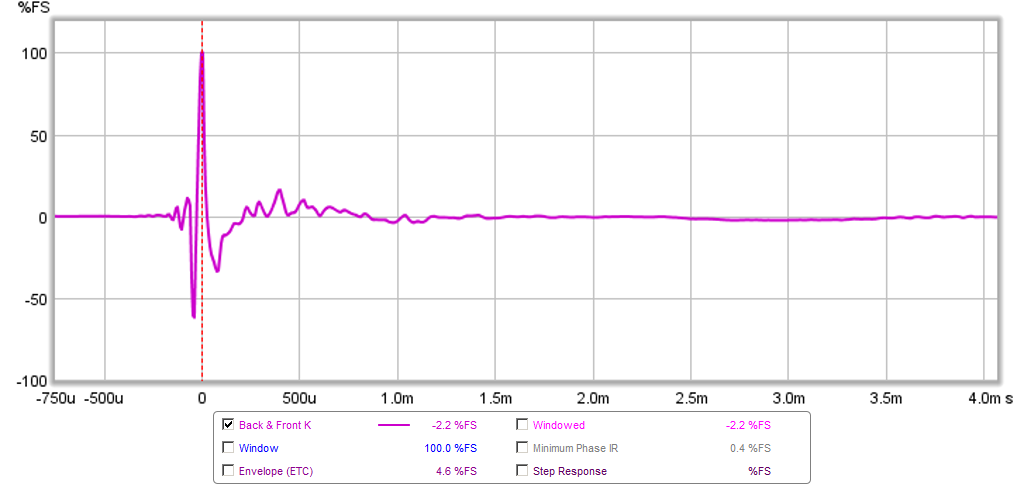

Well, the RS225-8's finally got here - they are beautiful drivers. Superb build quality, and what's more - some T/S parameters that are exceptional and hard to find even in other drivers at a higher price point. Nice cast frame, well made rubber surround, super hard anodized aluminum cone and phase plug. So I installed them into the KaZba and took the opportunity to widen the K-aperture and add ribs to its backside to strengthen it. There is no comparison between these and the cheap $10 drivers I previously had in here.
Here is a photo of the drivers installed inside with the AMT dipole tweeter on top, without the K-apertures:
I established a baseline response sans K-aperture and here is what the XO response looks like with some minor EQ'ing, LR4 @ 700Hz:

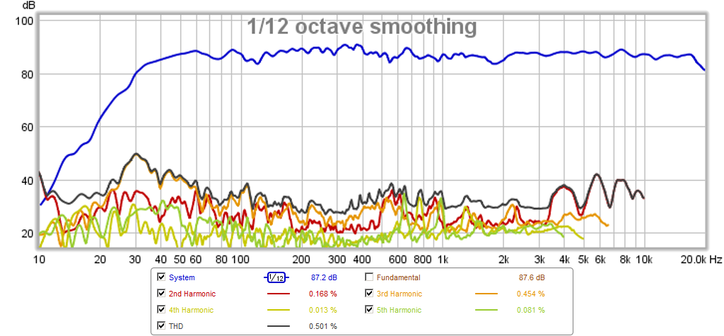

This is the corresponding HD - which looks excellent for how wide the bandwidth is:

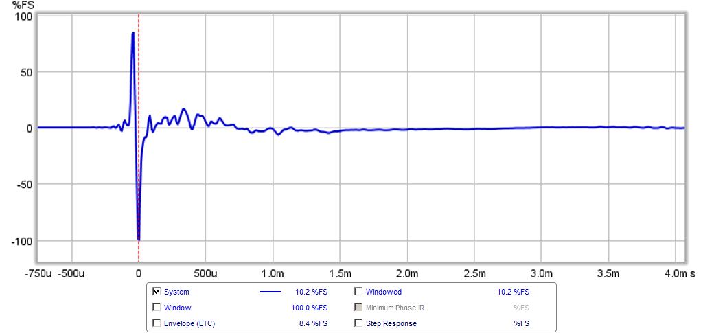

And this is the impulse response - exceptionally tight:

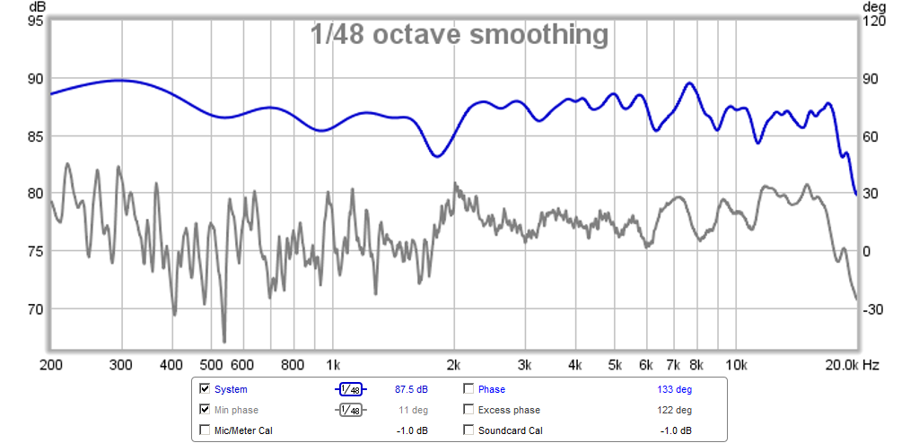

Here is a detail of the frequency response and minimum phase at 5dB/increment and 1/48th oct smoothing with 4ms gate window applied (measurements at 0.5m and 0.71 volts)):

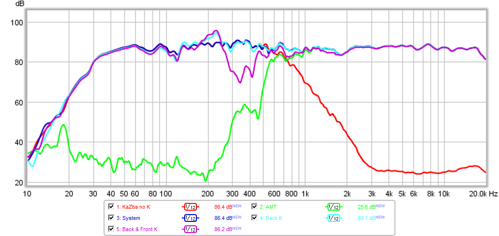

ANd this is what we get for frequency response as seen in the XO traces (magenta trace) - a bandpass peak appears at 250Hz and a dip appears near 350Hz, but the 700Hz XO region appears to be intact. The cyan trace is response with just the rear side K-aperture installed:
Here is the corresponding HD with both K-apertures - with an obvious increase in the harmonic distortion, I assume from the K-panel vibration:
and here is the corresponding impulse response:
As is typical of K-apertures, there is a strong dip/peak in the mid-bass, the good news is that it now extends above the initial dip from widening the aperture so that I can cross higher up with the AMT (the original goal). Listening to it, I am not sure I can really hear the anomalous response from 250-350Hz - which sometimes happens due to room modes. The aperture however, made the presentation of the sound more uniform over a wider range of off-axis listening angles, it visually decreased the cone excursion on kick drums. The sound of percussive instruments seemed to be tighter and this can be seen on the IR's which have less overshoot.
I think I have established that one can make a very successful Z-baffle dipole wideband (able to XO at 700Hz) bass unit using two 8in drivers in a fairly compact cabinet that can reach respectable low bass extension with clean harmonic distortion. I have sort of shown that a K-aperture can be applied to such a Z-baffle to make it a KaZba - but at the expense of coloration in mid bass, with usual advantages of afforded by K-apertures (wide dispersion, improved impulse, better cone motion control). The lesson learned here is the the KaZba cabinet needs to be made of sturdy non-resonant materials to resist the pressures involved to keep HD low.
Since I did not build it out of thick 3/4in ply (needed in this case), I think the added HD and coloration in the midbass is not worth it for me at this point and I would prefer to go to an open Z-baffle. However, if it were made of sturdy ply, I would go with the K-apertures (if HD goes down as I assume it would).
The neat thing for me was to see that I can have an all dipole speaker from 30Hz to 20kHz, and it sounds very good. Well, almost all speakers based on the Heil AMT sound very or exceptionally good. This is no different and reminds me why the Heil AMT is still the King of tweeters. Worth every penny... 🙂

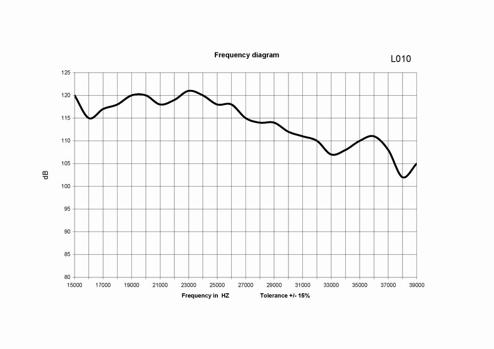

wonder how a Kemo bug repellant tweeter would do for a PA130 helper? - have no idea how its supposed to measure
down lower than their graph
L010 Piezo Loudspeaker
You need something that will go down to 10kHz to help the PA130 - your bug repellent tweeter looks more like ultrasonic territory.
