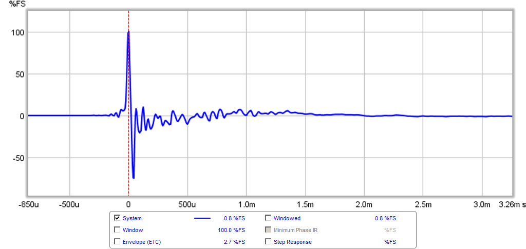

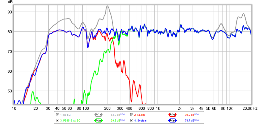

Playing around with PS95-8 FAST
Here is a FAST using the Dayton Audio PS95-8 driver in a Nautaloss with trapezoid baffle. XO is 225Hz LR -24dB/oct.
Freq response (grey is no EQ) and XO shape:
Impulse response:
It sounds very nice - the EQ helped to get rid of the sizzle/ringing.
Impulse response:

In the FR measurement of post #82, the un-EQ'ed gray line is very good indeed.
It's almost a text-book 6dB/oct decline from 60 to 30Hz, and it's amazing to have the shoulder @ 30 for such a small size.

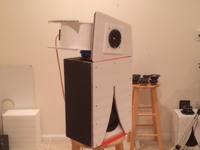

hi CLS -are you going to use two 18's per channel? I've used an Eminence like Sigma18 - qts was a bit lower at 0.25 and mms 105g. on other K stuff, TheJessMan has to put a clear coat on the little 0.65X K15 for me and they'll be done. Hope they play nice. I asked for something different with dark wings and light shell - hope they look ok to others
http://i.imgur.com/0EXba6P.jpg
Your new box is beautiful. I like the colors.
Your Sigma18 seems not a regular one. Maybe there had been several versions. Mine is 130g Mms and 0.27 Qts. I don't know how the Mms changed after the mods -- several coats of PVA glue on both sides and de-cap. And, the spider is softened by silicon oil. The fs drops from 27Hz stock to 22Hz. And then to 16Hz by slot-loaded (slot of 40% Sd or so).
interesting mods for sure - especially the silicon oil - what product does one look for ? - what sonically do you think was the effect of PVA? - was it the consistency of Modpodge thinned 50/50? - I have another set of thicker (and more straight profile) cone EM18 with mms 130g and fs~23 sold under "Electar"
