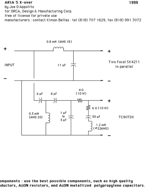

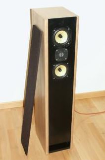

For repair of an old Focal Point Source Aria Five (from 1993, Manfred Zoller HiFi Design)
I want to know the difference between this two chassis models.

More Pics

5K4211 vs. 5K013L
Both of the chassis have exact same measures of 136x136 mm,
so the probability that the screw holes are exactly the same, is
very high. Regarding TS parameters, these units seem to be
interchangable without further worries.
