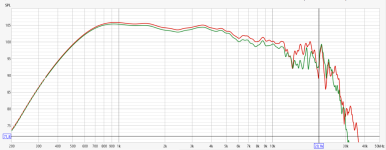

You are onto something with the BMS 4554 here! How did you manage to dampen/shift the 18kHz resonance of the membrane?I have also some very very quick measurements/comparison of ROSSO 65CDN-T and BMS 4554 with a basic adapter of 33.1 deg angle.
(I didn't have the right bolts so this was only put loosely on a stool.)
A520G2 waveguide, everything same for both.

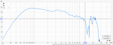

BMS 4554 alone:
Here you have a driver reaching 20 kHz with ease. Not so much at the lower end though.
I'm using DE360 cause of the great behaviour up to 20kHz but having a driver with similar behaviour and can be used an octave lower ... that would be great!
I actually think I have a pair of 4554 in one of my PA speakers I did years ago ... as infills to my bigger ones with the Coax. Never needed and used them a lot.
I have no idea, I'm not aware of any resonance, nor I tried to damped it - If I did, it was utterly unintentional 🙂How did you manage to dampen/shift the 18kHz resonance of the membrane?
