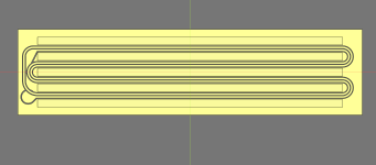

While waiting I did some more work on the membrane traces. I had first routed the traces with ExpressPCB but it got very finicky when I want to test changing the gap width between the traces, the amount of traces and so on. I got even more problems too since I can only export to PDF which I can then convert to svg but then the it generates a single line from the traces, not lines along the edges and when I tried to convert the resolution was bad.
And since I want parametric traces I went back to the tool I know so I modeled them too in cadquery and it turned out great! Here is 4 traces with 0.5 mm margin between traces:
I also wanted to test cutting with my Silhouette Cameo 5. I decided to try the Inkscape plugin https://github.com/fablabnbg/inkscape-silhouette because if I read the features correctly it can be configured to minimize backwards feeding which is useful to prevent drift across a long cutting surface.
And I got it to work! Although the Windows steps they list on the root page needed to be tweaked to work. Specifically I changed the windows commands to skip the ".\" and single quotes such that the commands I ran was:

On my first cut experiment the result was bad. I used 50 um cutting depth on my ratchet blade, speed=10 and pressure=2.
On my second cut I slowed speed down to 2 and pressure to 1. I also changed my knife depth to 100 um. I also made such that it cuts twice, once in each direction. I also made sure to flatten the aluminum foil with the roller which I didn't do for the first cut so the surface wasn't as flat as it could have been. And it turned out great!
And pulling away the 0.5 mm gap traces wasn't a problem either, so I will continue with 0.5 mm for the gaps.

  1. @solhaga you were right that Silhouette Studio cuts better than the Inkscape plugin. Especially in the curves. I also learned the hard way that in Silhouette Studio when you import a dxf it defaults to rescale the image to fit the cutting area...
  2. Those magnets are scary! I got my fingers caught in between two plates and it was really painful. To reduce the disk of accidents I have decided that there is absolutely no way I will do the whole speaker in single front + back pieces. Even 16 cm tall plates are pusing it and I will probably reduce it down to at most 10 cm, maybe even 5-8 cm. I'm thinking I'll have longer plates on the rear inner part of the driver, say 20 cm but then segment the front much more say 5 cm so they are easier to mount.
  3. Aluminum foil loves to rip when being cut. The small gaps also love to be self weeded and cause rips. I'm thinking of segmenting the long traces into parts to reduce the risk of them being ripped up. The last mm or so I could easily cut with a scalpel. The segmentation should also, in theory make such that when cutting the 2 m long membrane the cutter will cut each segment in order and won't roll the membrane back and forth the whole length for each cut, should reduce the risk of drift in the short axis.
Reactions: mvs0
I've discovered that Silhouette Studio is not complying with all DXF variants. For instance, exporting a design as DXF from Fusion can look really bad when imported to Silhouette Studio.
The remedy is for example to import the DXF file to a third programme, I've used FreeCAD, and then export it again.
Import that DXF file "as-is" will be alright in Silhouette Studio; you only have the move it to the right place.
