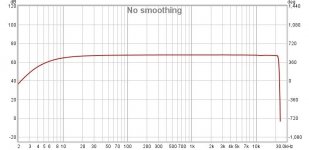

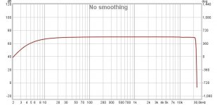

Here are some basic measurements of the headphone amp from a few posts back. All are from the right channel using GZ34, 6SU7GTY, and EL34 into 32ohm and 300ohm dummy loads using low and high Z output settings respectively. Using Jan Didden's Autoranger paired with a MOTU M4 interface.

Frequency response 1mW into 32ohm
Frequency response 1mW into 300ohm
Those are really very good specifications! Of course 1W into 32 or 300 Ohms is not practical (it will blow your ear drums out of your
head) it shows the very good quality of your design.
But that is my humble opinion of course.
Thanks! Yes of course, I just wanted to illustrate the distortion is quite low even at higher power outputs. In terms of the frequency response, it is down about 0.8dB at 20Hz and 20kHz. Output impedance on low Z is 5ohms, on high Z 17 ohms.
I'll have to redo these measurements at some point, just a quick and dirty set here, the harmonics at 8kHz and 16kHz appear to be artifacts since they are present on loopback without the amplifier in the path, I suspect something is up with my ADC. Noise floor is higher than expected too. Anyway, I'll leave it there for now and post finalized measurements down the road.

That I do not understand. If I look at the 1mW into 300 Ohm spectrum then I see a noise floor which is -80 dB lower than the first harmonic.
So, what is the problem?

It isn't a problem, I just don't think the measurement is accurate. The noise floor is essentially identical on loopback of my interface with and without the amplifier in the path, it should be significantly lower with the amplifier removed based on previous loopback measurements, so it appears the interface is making a significant contribution when it shouldn't.

Ah, I understand. But that is something which I cannot interpret because I do not have access to your set-up 🙂

Yes, see I fixed the noise issue, it was due to being plugged into a power strip with other electronics.
Much lower noise floor here and distortion is further improved. Still 8kHz and 16kHz harmonics which I will need to investigate as they are making a significant contribution to THD with the amplifier's harmonics being so low in level.
