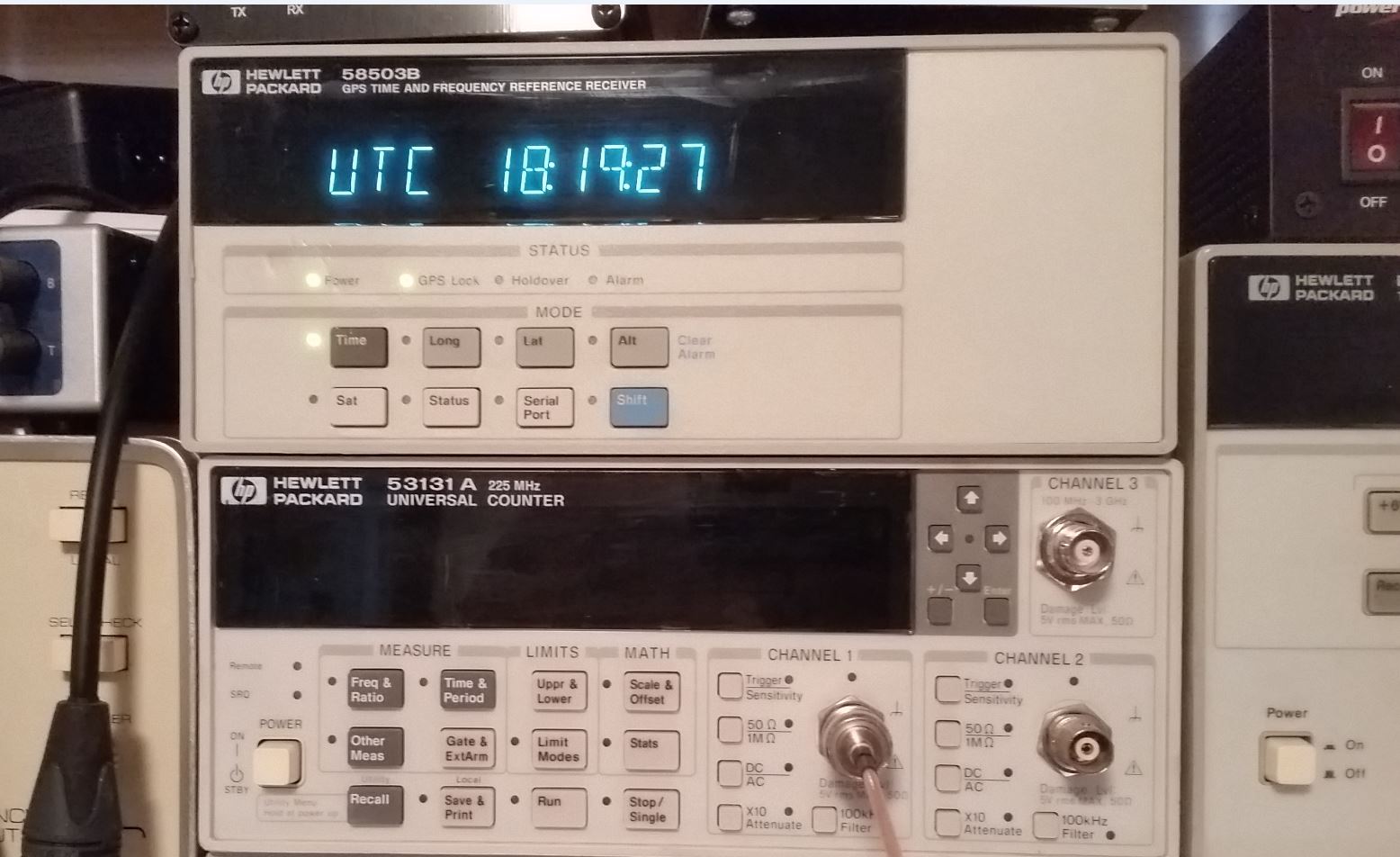

Here's my solution to the question of whether to waterjet or not:
It usually acquires 5-8 satellites, and the reference 10 MHz output is accurate to 10 uHz 24 hr. stability, really helps the freq counter, spectrum analyzer and RF generator stay on frequency. And of course there is the ham rig which is now locked to it for whatever reason I do not know...it had a 10 MHz Ref. In jack, so I used it.
