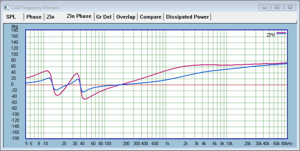

What is clear is that parallel resistance works better in flattening the current phase angle:
Here is series 18 Ohm, Red is before, Blue is 18 Ohm series:
Here is parallel 8 Ohm added:
The same improvement is heard when equalising the current of the amplifier (passive caps, inductors etc), where the EQ is on the amplifier side and not on the driver side. This is not about the terminal impedance of the driver, this is about making the current phase angle of the [single] driver go as close to zero and the amplifier produces the same current at all frequencies.
This is what we are exploring, note the we.
Re others here: I shall not wake up every morning and find an avalanche... I get the picture of what is going on. Also, there are some of you that I will just not reply to anymore. Unless it is respectful.
You keep saying that I have not posted a measurement. Well, I did.
You ignored it. I then posted it again, and deja vu, you just ignored the measurement again. I am not inclined to do it for the third time.
Oh, the two above? That is a real driver been measured, what did you think it was?
I wonder how many of these ghosts hiding behind pseudonyms have anything like the real world experience that I have.
There is life beyond text books!
You have shown this measurement before in your #27689. You have received replies by Pavel #27691 and me #27690. My remark was that I don't know of any amp that distorts less at lower load impedance, Pavel's that this parallel resistor does not change the current flowing through the voice coil. These answers should be sufficient for you to understand that you are barking up the wrong tree.
Indra replied that there is an SET amplifier he knows that distorts less at 4 than at 8 ohms. That was a good find, but not typical.
You, on the other hand, did not respond. At all. You just reposted the same measurements. Now. This gets annoying. The only relevant measurement would be: distortion profile of the acoustic output before and after.
The measurement you now reposted only proves that there apparently also is life before text books.
