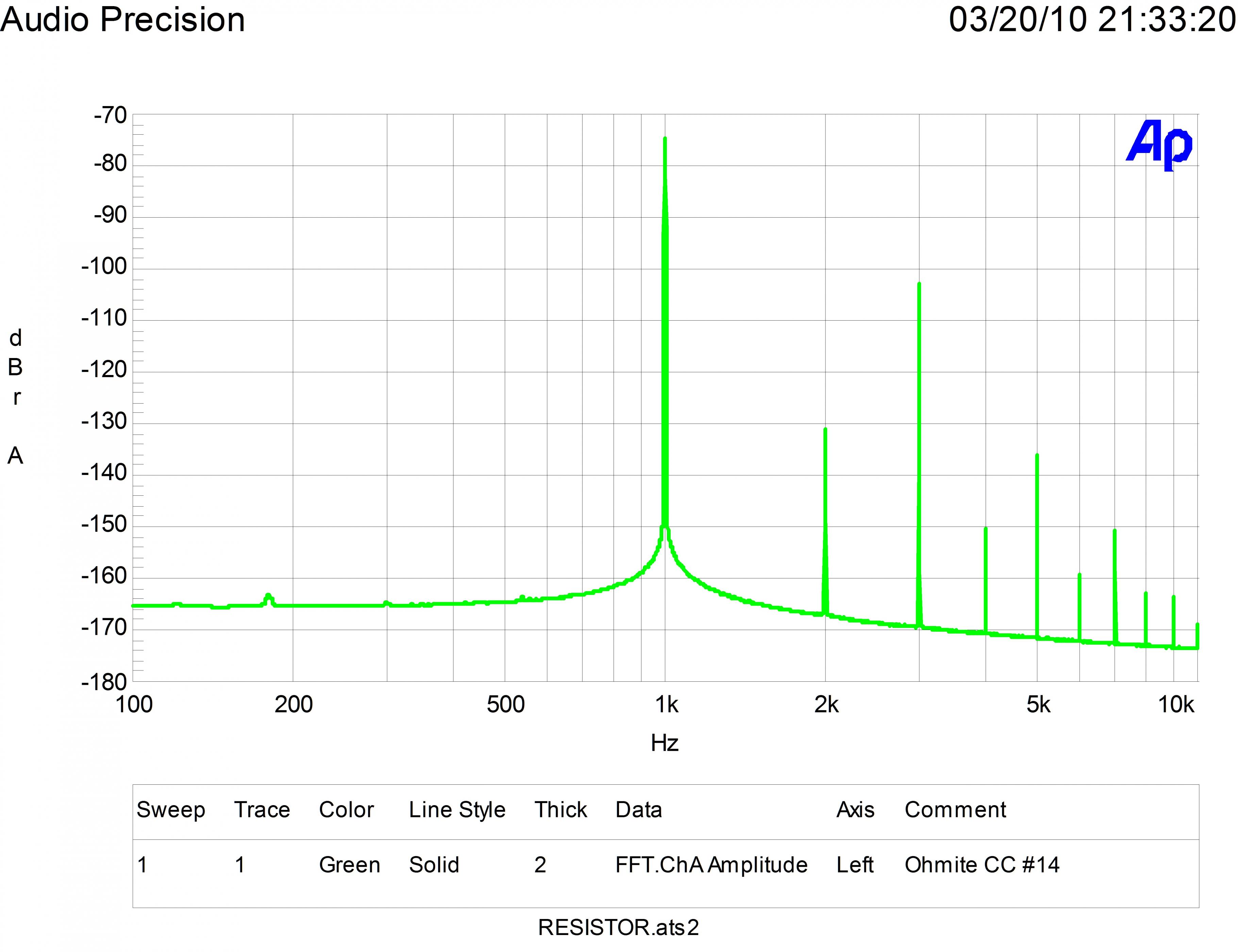

In the resistor literature there is what is called voltage coefficient. It is different than thermal changes. Thermal changes result in odd order harmonic distortion as heating and cooling occur at different rates. Attached are the distortions of a standard carbon composition resistor. It shows both thermal and voltage distortions. Input is suppressed it is 0 dB.
No that's not true, it's because you heat a resistor no matter what the polarity of the voltage is. In equilibrium the final value of a resistor with +10 or -10 V on it is the same. Symmetrical distortion like soft compressive limiting = odd order distortion.
Did you ever read Barney Oliver's paper in the HP technical journal on their original oscillator? It turns out the voltage coefficient of the filament determined the distortion and settling time at most frequencies not the thermal coefficient.

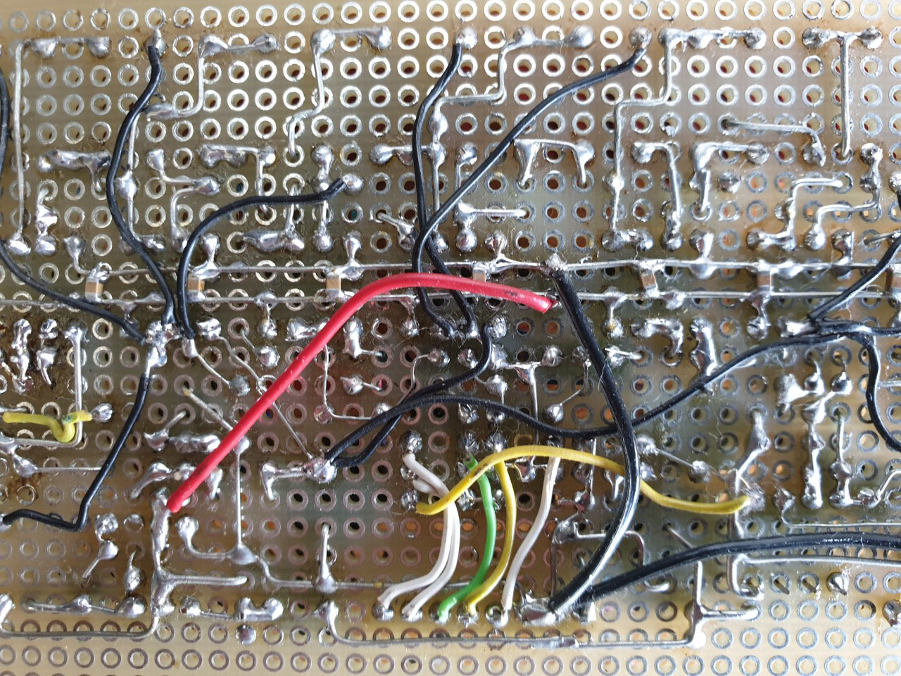

Can't say I ever done bypass caps that way, good one.What a waiste of perfectly good connection material.
I should open shop as Misertronics.
Yes Scott, I swapped odd and even. Must be the half a worm...
Thermal has time as an important parameter, voltage does not.
