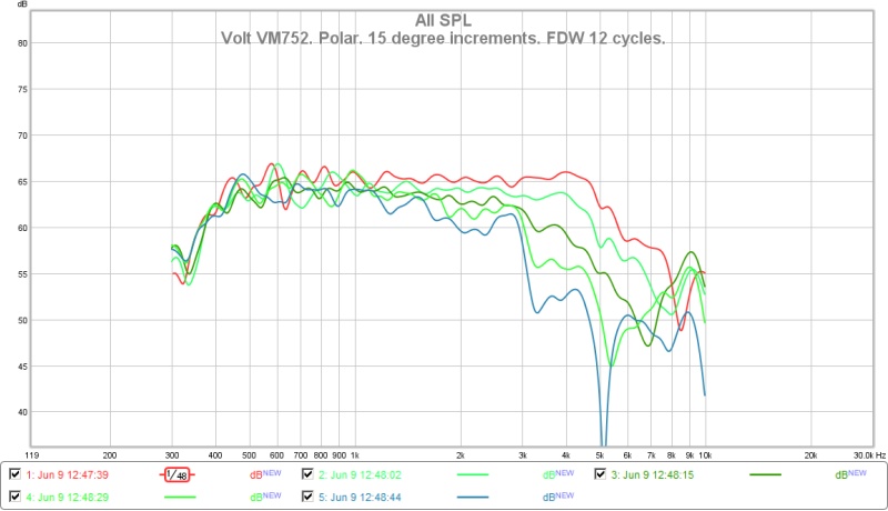

Since this thread has returned I hate to give a negative thing, but I see some off axis ripple at 3khz that likely is diffraction. Spheres are great but with the volt mid, you've actually made a worst case scenario- a circular edge. It doesn't look like it's hurting things much based on your polars, but it does rather defeat the performance purpose of spheres.
Sorry to buzzkill things! It does look great visually, I'm sure it sounds awesome, as I said, the performance doesn't show that much from the ripple, but it's definitely got some midrange diffraction going on.

... I see some off axis ripple at 3khz that likely is diffraction. Spheres are great but with the volt mid, you've actually made a worst case scenario- a circular edge. It doesn't look like it's hurting things much based on your polars, but it does rather defeat the performance purpose of spheres.

IMHO, it's hardly a buzzkill, as most of the measured data look fine.
So if a circular/spherical baffle causes symmetrical diffraction for the mid dome, what do you suggest as ideal? Something less symmetrical, I suppose...?
No probs at all badman. I believe the ripple you see though is actually not the baffle at all but the horn of the mid - it is actually much improved from the typical flat rectangular baffles I had it mounted on previously! (This project is a reuse of the drivers from an earlier speaker build!)

Should also say badman one point you are wrong about - There is no 'circular edge' you are thinking of a disc. A sphere has no edge!
As I am sure you know a disc is very different from a sphere when diffraction is considered.

Just a reminder for all. The sharp circular edge of a disc/cylinder (worst case for diffraction) versus a sphere (best for diffraction). Easy to think the two would be similar at first glance.

Re-reading your post Badman - I think you may be referring to the transition from the horn lip to the sphere? Rather than a circular baffle edge as such - my apologies if I misread you initially!
Of course that lip is present even if the VM752 is mounted on a flat baffle, and interestingly as I said earlier the spherical enclosure mitigates the diffraction artifacts compared to a flat baffle. This measurement on a flat baffle shows the extent of the diffraction dip from the horn lip at approx 2.6kHz.
Obviously if you try to eq this 8dB dip on axis, it creates havoc off axis (I have some polars from my old speakers somewhere that illustrate this).
But the new spherical enclose allow EQ on axis to almost a flat FR without the craziness off-axis (10dB swings if I remember right!). As you can see from my polars there really isn't any issues until you get to approx >45 degree off axis, and even then it is only a few dB:
So whilst you are right - there is evidence of diffraction, it really is much better than the alternatives in my experience.
As a final point - I cross at ~2800hz LR4 anyway, so things are starting to rolloff there making it all the more academic!
