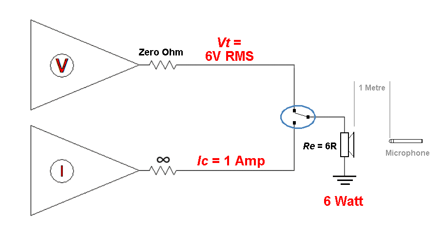

We devised an equivalence test based on an 8 Ohm driver (an actual Peerless 830875 6.5" driver) with an Re = 6R - this is the voice coil resistance.
The microphone was calibrated to read high accuracy dBSPL.
Two amplifiers are needed, a voltage source and a current source.

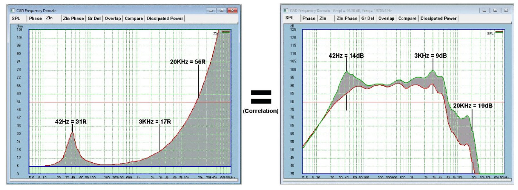

This is the two results:
Note on the left, that blue lateral line is the 6R and everything above is some form of back-EMF impedance. So the motional impedance peak at 42Hz is 31 Ohm, but the back-EMF will be 25 Ohm when 6R is subtracted. You can do that any any frequency, but LF is motional back-EMF and higher is inductive back-EMF. At the end I hope we can agree on that.
But let us examine 3KHz:
The impedance nearly triples to 17 Ohm at 3KHz (quite common), then the 1A current is reduced to 353mA, the acoustic output dBSPL, measured with a microphone, drops -9dB.
Ic = 6V/17 = 0.353A
Because the acoustic output dBSPL is proportional to the current:
dBSPL = Log(20)*0.353) = -9dB and that result matches above.
The voltage that appears across Re, we shall call Vre:
Vre = 6R*0.353A = 2.12V
So this has come down from 6V to 2.12V and the 1A current reduced to 0.353A.
Now we can calculate the heat dissipation (there is no heat dissipated in the 11 Ohm back-EMF impedance):
Heat = 2.12V*0.353A = 748mW
So without back-EMF impedance, this would have been 6 Watt, now reduced to a mere 3/4 Watt.
Log(10)*(6W/0.748A) = 9dB
This 11 Ohm back-EMF impedance, being a voltage source and not dissipating heat is interesting. 1) It proves that the dBSPL is entirely proportional to current, not the voltage. 2) The Vre value helps us to understand the dissipation and since most drivers are well below 1%, this means that the dBSPL is also largely, but not exactly, proportional to the heat dissipation.
There are no claims here, this is how it works every day of the week.
But now for something very important to understand, it is this (and this has been approved by some "peers" of note): The imperfections of the driver shows up in the back-EMF impedance of the driver, modulating/changing the current of the amplifier. For example, using the same driver above, if it has a major/bad 3KHz resonance, the bi-directional properties kicks in. At 3Khz that 353mA of current is not a longer stable commodity, now that 353mA is being modulated by a 3KHz resonance because the driver wants to behave like a 3KHz voltage source looking back into the amplifier.
That is just the starting point of research, but so far the maths are solid, and it is clear that further maths and measurements can be developed (they are) based on what the above reveals. Also, note that this distortion shows up on the current side of the amplifier. Don't need to prove that, Pavel's (PMA) measurements have also already shown that. And I told him that. So this is more about what the current side of the WHOLE system is doing, amps and speakers. It is less about the voltage (not excluding what it does) and more about the current.
There is some really serious work done on this right now, it is not about rewriting the rules, it more about understanding the rules that are already there, the physics of it. And cause and effect should be able to explain this, measurements conducted on both the electrical side of the speaker and on the acoustic side (correlation). Cause and effect; we don't need to go quantum or anything - although I do believe and ascribe to the Copenhagen Interpretation for now (I am biased, I was born there).
I intend, with some help, to prove that the solution is in the hands of speaker designers and not amplifier designers. The solution is not current driving, although current drive reveals a number of things that might actually point to making voltage sources work better. Amp designers, relax. 😀
So I hope I have made a reasonable case.
I just spent a good bit of time to present the above. I hope it won't be so glibly dismissed. But it is really is only a synopsis of what is going on.

Joe what you describe is the standard procedure followed when measuring Z with a constant current source. Nothing new, nothing different so far, till:

So the motional impedance peak at 42Hz is 42 Ohm, but the back-EMF will be 36 Ohm when 6R is subtracted.
Per your attachment, impedance peak at 42Hz is 31 Ohm and subtracting 6 Ohm leaves 25 Ohm.
You show again a speaker with pure voltage vs pure current drive. This has nothing to do at all with a combination of crossover and shunt networks to make a multi-way speaker look like a 6 Ohm resistive load. My take on PMA's results is that you want individual equalized current out amps on each driver to achieve the low distortion performance.
Do you want me to make these corrections on the text?
George
Correct, it is indeed 25 Ohm. I made a typo/error, that happens sometimes and nobody is perfect. Thank you for the correction.
Now please do the maths for 42 Hertz and 31 Ohm where the Re DC resistance is 6R. The maths works there the same as it does for the calculations that I showed with the example of 3KHz. The math works and I would love you to pay attention to that.
