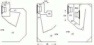

Ho David, long time not hear me, Oke I have a question, if you look at picture, is the red circle the speaker cone? and as you see the port is big? this is much to big for this horn or how I have to interpretere it.
The result looks goed but I think it is not possible in real.

Hi Kees,
1. The dotted red circle shows the total area of the two driver diaphragms, that is, 2 x Sd.
2. Because Atc and Ap1 have been specified as having effectively the same area, the values for Ap1 and Lp can be set to zero. The port serves no purpose in this case, apart from increasing the throat chamber length by 0.2 cm, which makes no practical difference to the results anyway.

Thanks David, I have correct it, and adjust the others for thickness of wood, in mine case 1,80 cm, is dat the richt way?, I did delete the Atc and lp and it have no different action.
The result for this old phillips speaker is quite oke, but it that fot this way, I do not now, as your program do center the port while when build it, the port is shifted because of this problem of fitting the speaker.
regards
Hi Kees,
It all depends on whether or not you want to include a port having a different cross-sectional area to that of the throat chamber. If so, then specify the port using Ap1 and Lp. Otherwise just increase the value of Vtc to take the panel thickness into account.
Even if the port is offset in the actual enclosure, the predictions should still be reasonable.
